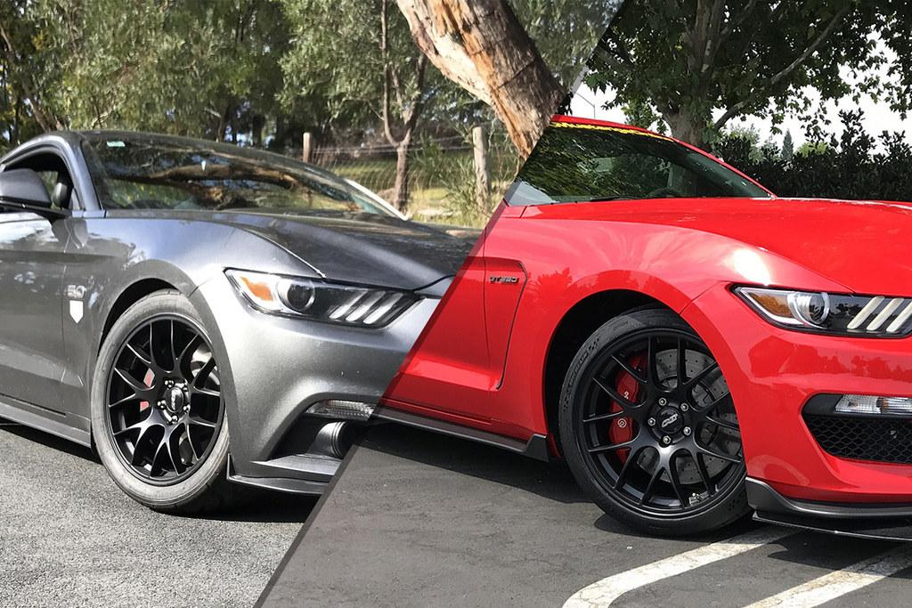

“I prefer 19” wheels because it fills out the wheel well better”
This is another statement we often hear. While visually this could be true with certain wheel designs, wheel diameter does not dictate overall tire height, and the tire is what will actually “fill out the wheel well”, as they say. Let’s take our EC-7 18x11” ET52 fitted with a 305/35-18 Nitto NT-01 for example and compare it to the EC-7 19x11” ET52 with a 305/30-19 NT-01. The 305/35-18 is listed at 26.42” in diameter, while the 305/30-19 is listed at 26.26” in diameter. In this scenario, the corresponding 18” tire is actually larger and will thus occupy more room in the wheel well. Why did I choose these particular tires? For starters, they are both very common track setups that perform exceptionally well. They also have the same section width at 12.32” so they are incredibly similar tires in overall dimensions.
