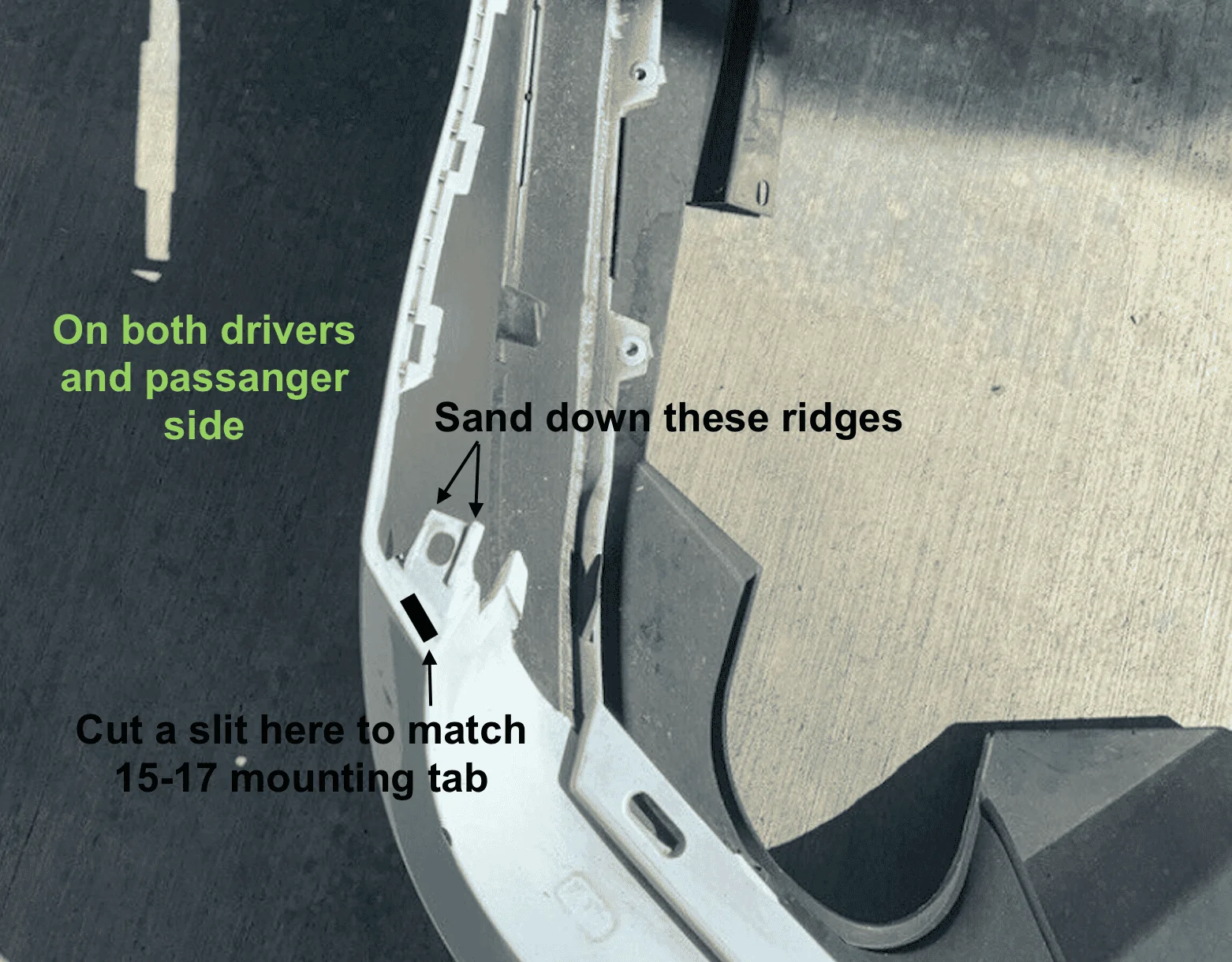

Note there is one modification that needs to be made to the 18+ rear bumper. Ford changed the style of mounting tab by the outer side of the taillights. On the 18+ rear bumper grind down the ridges on the tab and cut a slit to match the tab on the 15-17 rear bumper.

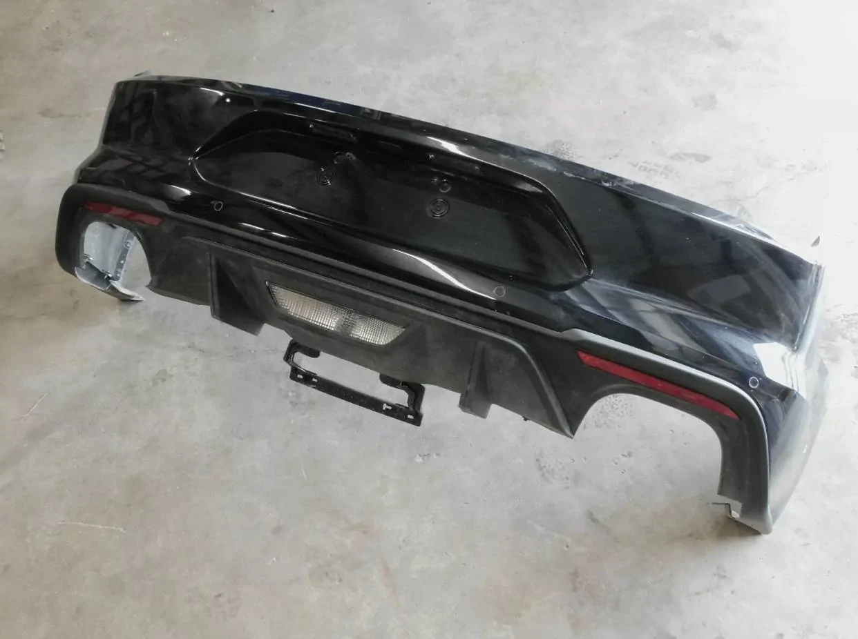

Parts needed to put 18+ Rear Bumper on 15-17 Mustang (I purchased my parts from @LevittownFordParts )
Rear Bumper Cover
JR3Z-17K835-AAPTM (With Sensors)
JR3Z-17K835-APTM (Without Sensors)
Rear Valance
JR3Z-17F828-AA (Quad Tip)
Reflectors
JR3Z-15A448-A
JR3Z-15A449-A
Reverse Light
JR3Z-15500-A
Absorber
JR3Z-17E855-B
Inner Support
JR3Z-17754-A

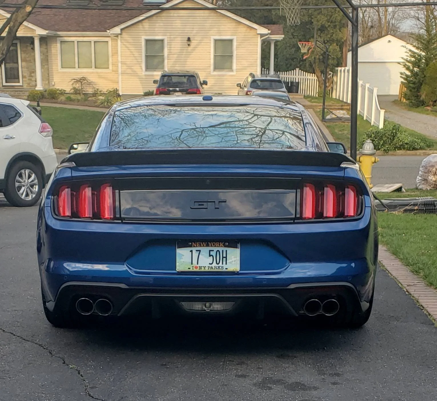

Before: 15-17 Rear Bumper with Roush active exhuast with cut diffuser

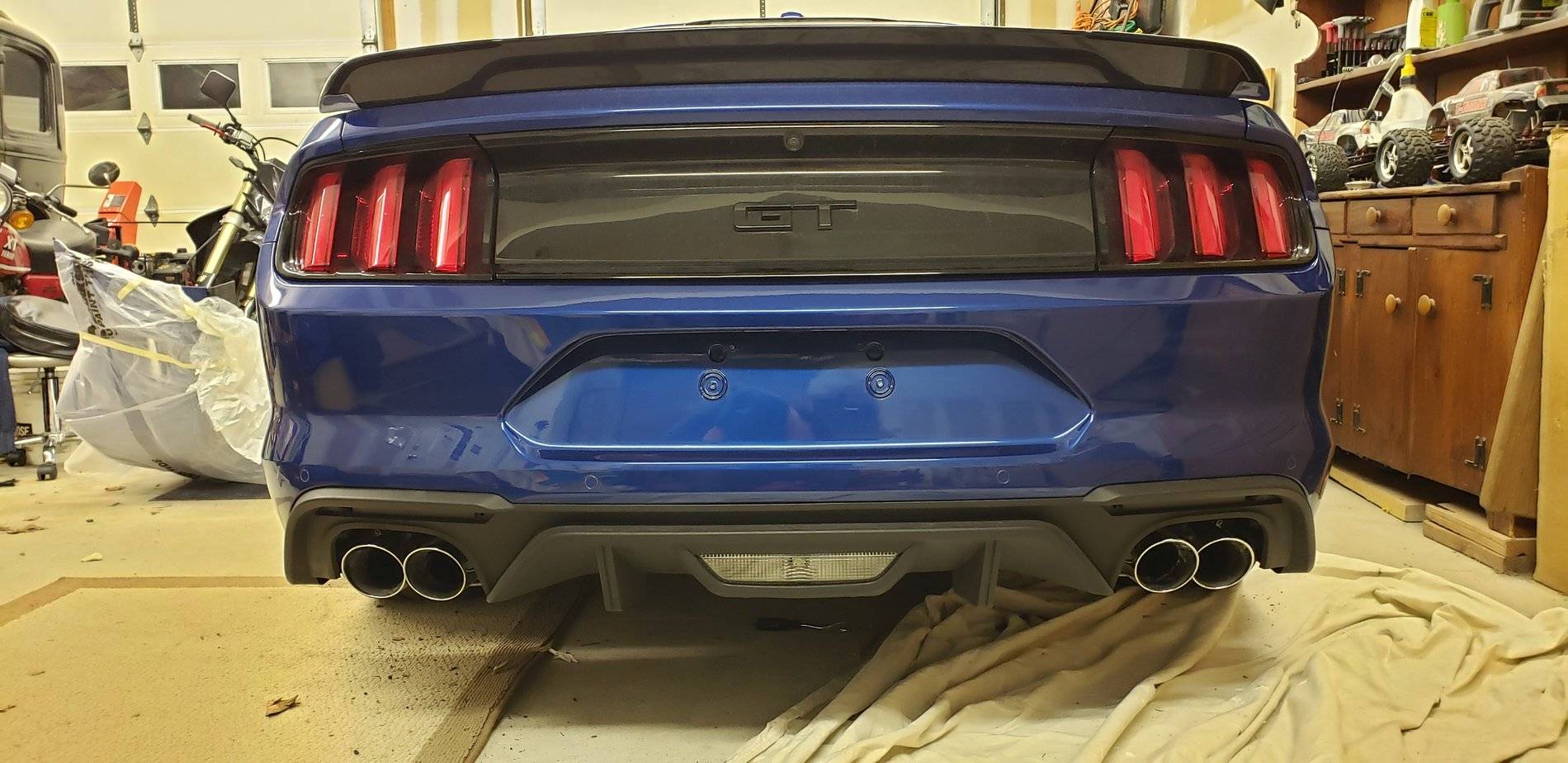

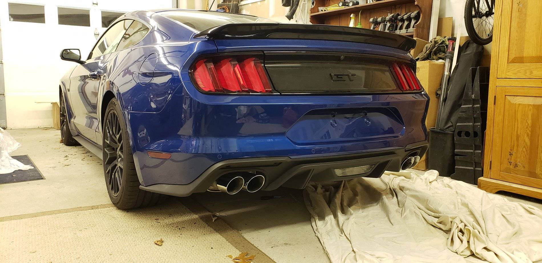

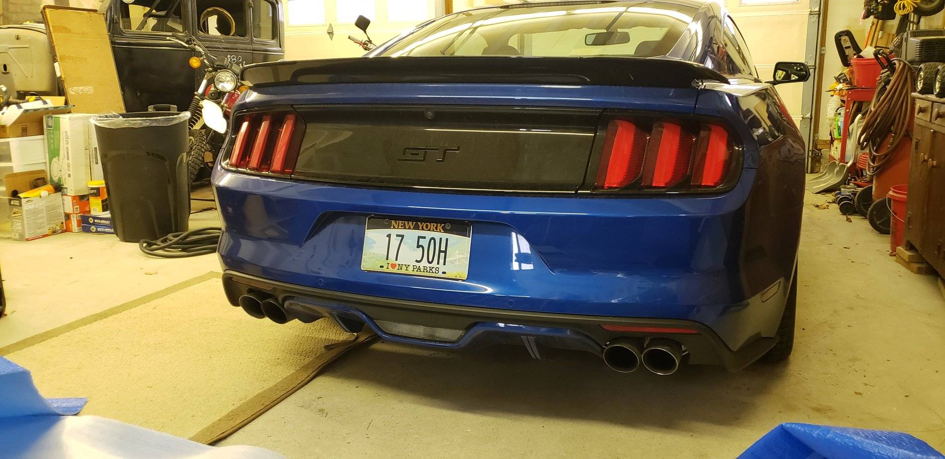

After: 18+ Rear Bumper with Roush active exhaust (Note the new reflectors are not installed in the valance because I am still waiting for them to arrive)
*Update with the reflectors
