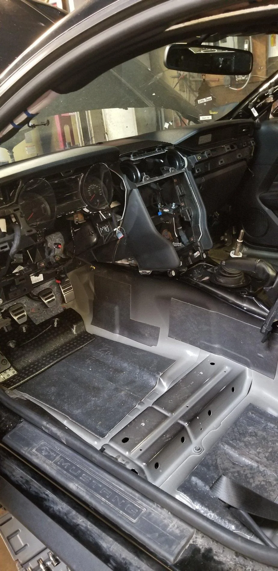

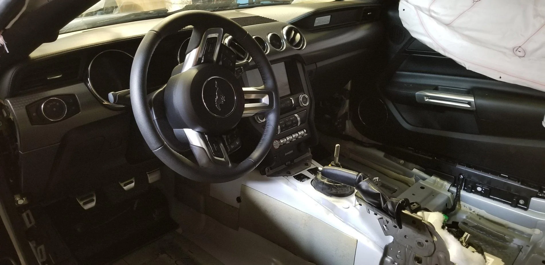

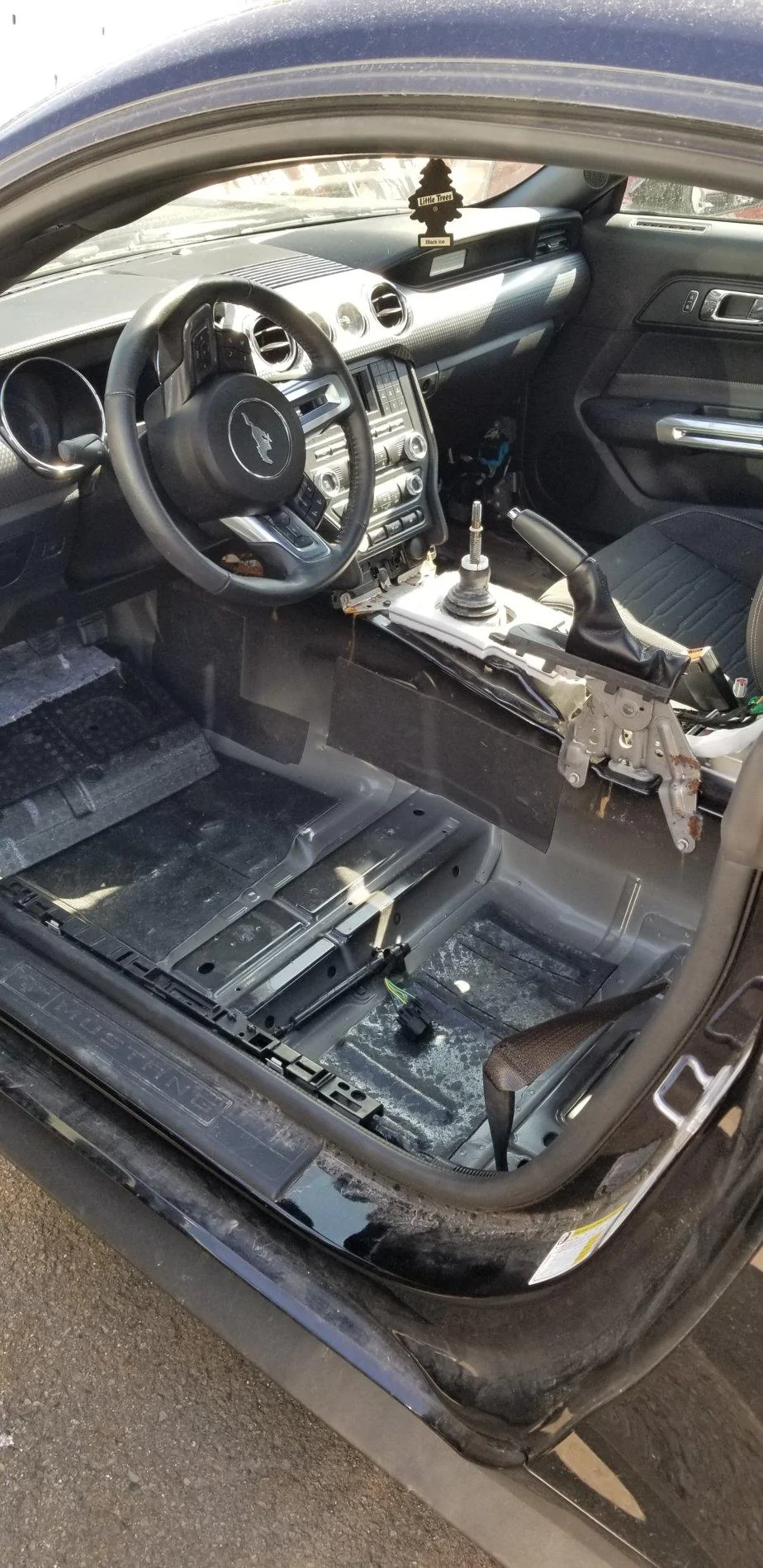

I have a 17 base pp im installing a full interior dash hvac etc into from this 17 premium shaker donor car. Ill get some pics when i figure out how to upload them

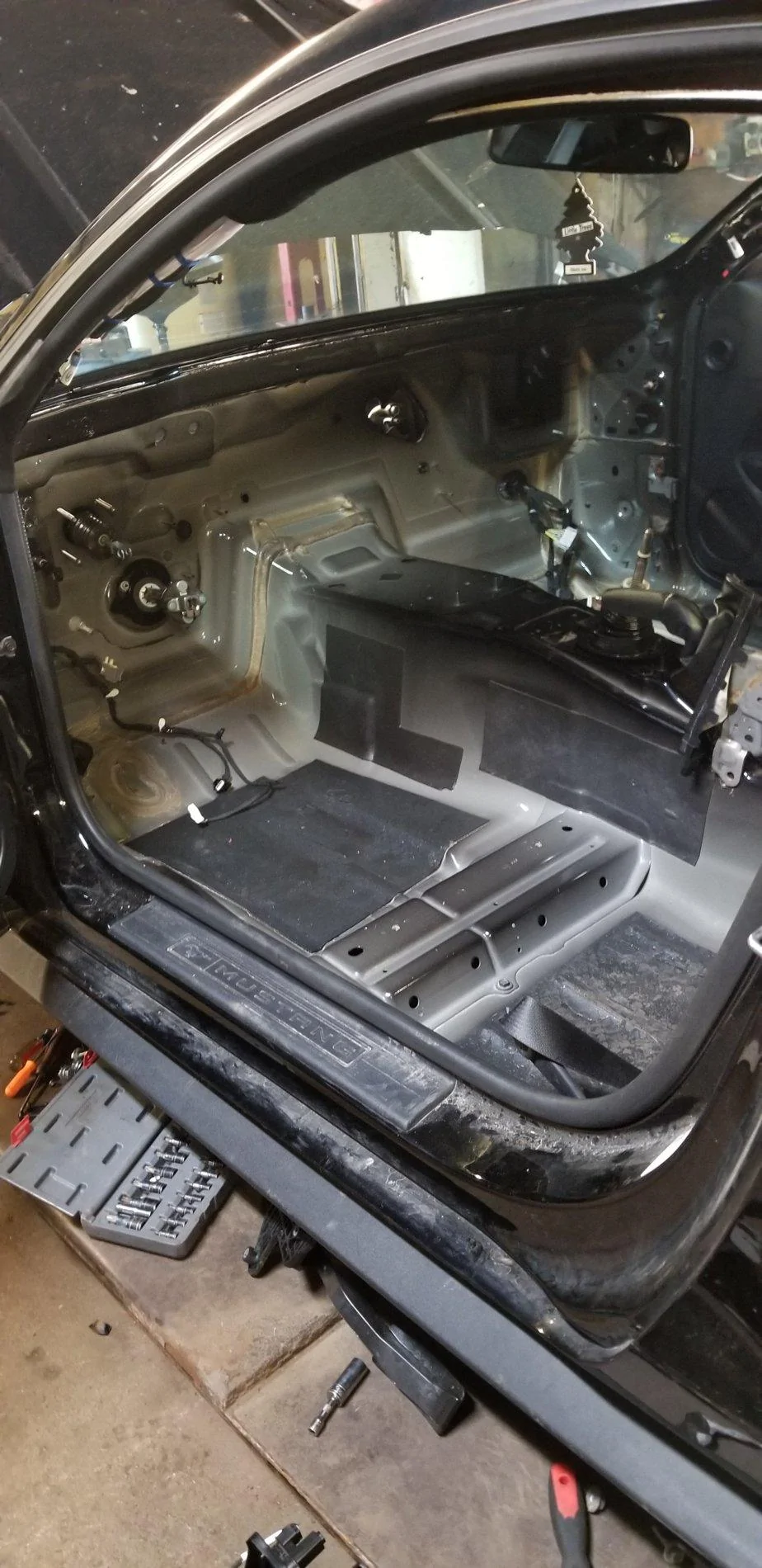

got the seats and carpet out, next the harness from kick panels to rear

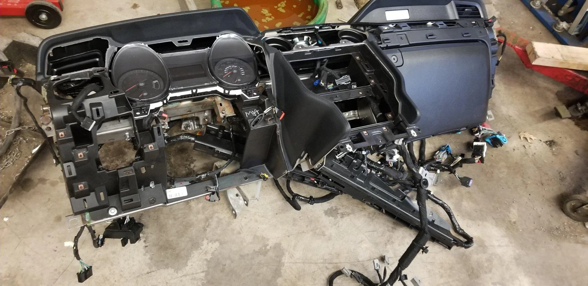

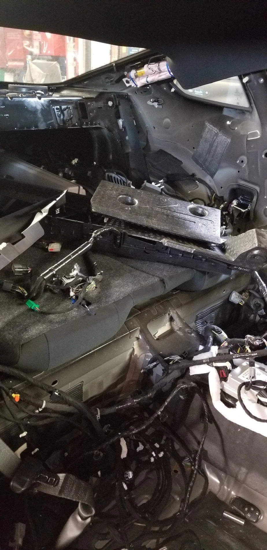

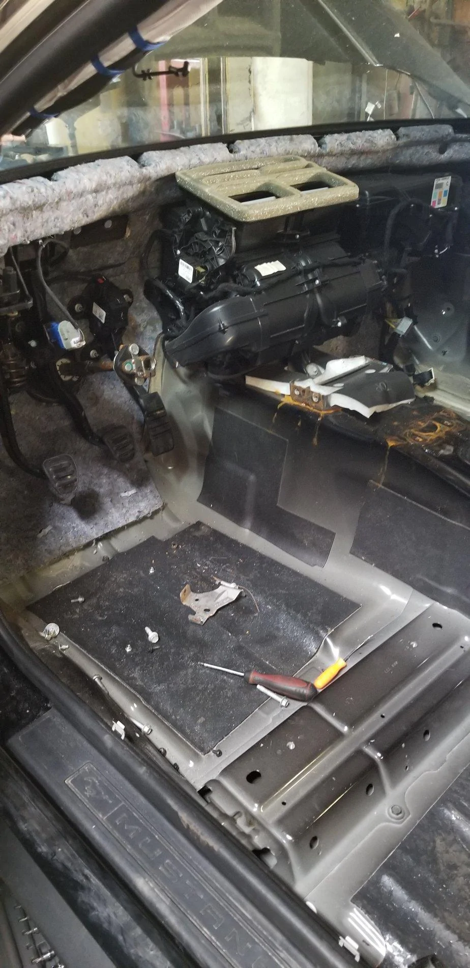

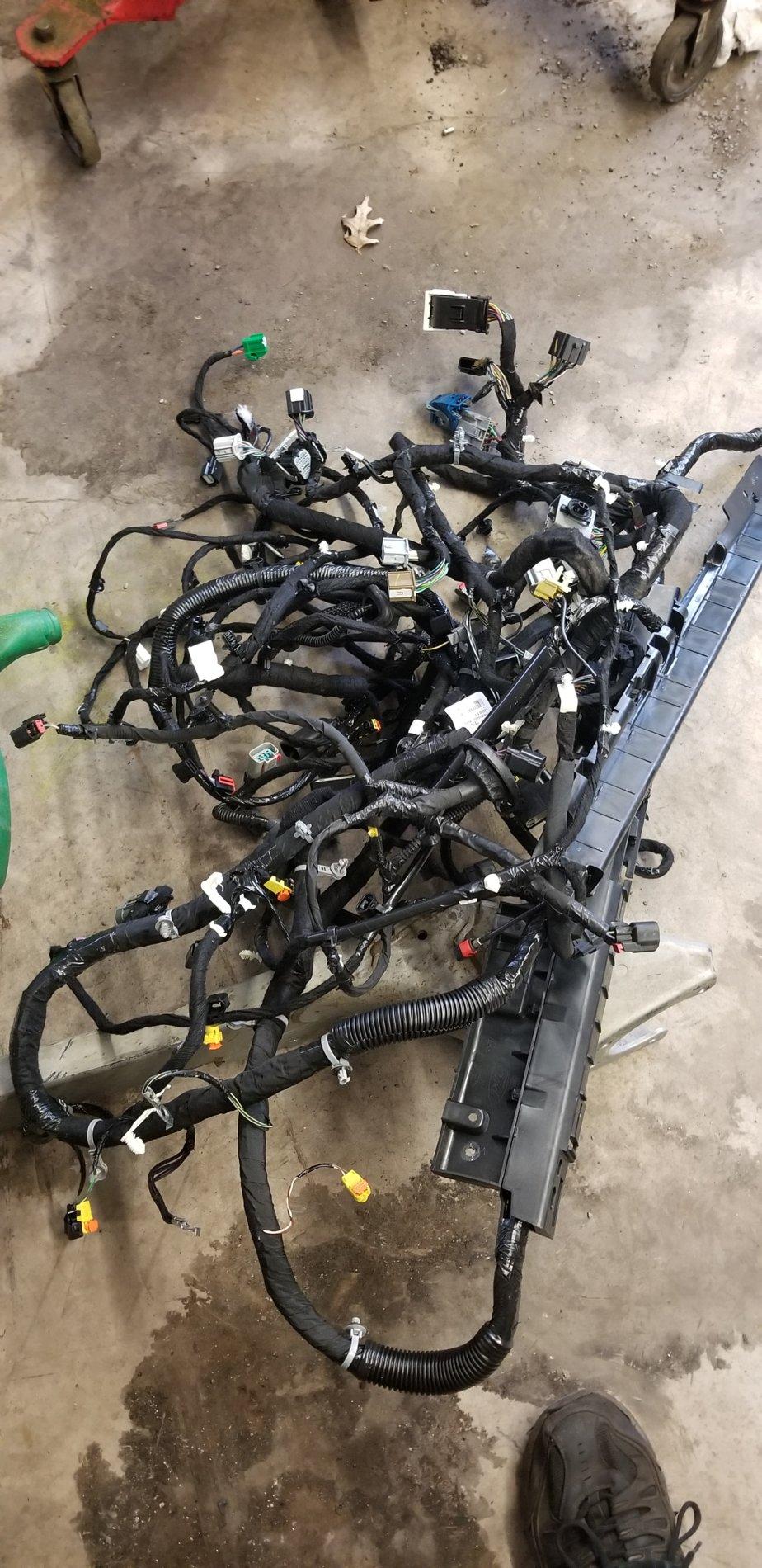

Harness and dash out of premium. Harness was brutal it runs everywhere worst was abs stuff up above axles. Dash wasn't too bad just has these weird bolts that go from outside the door hinge pillar then through these hollow reverse thread bolts that push against the pillars as you tighten the outer bolt just something i never seen before

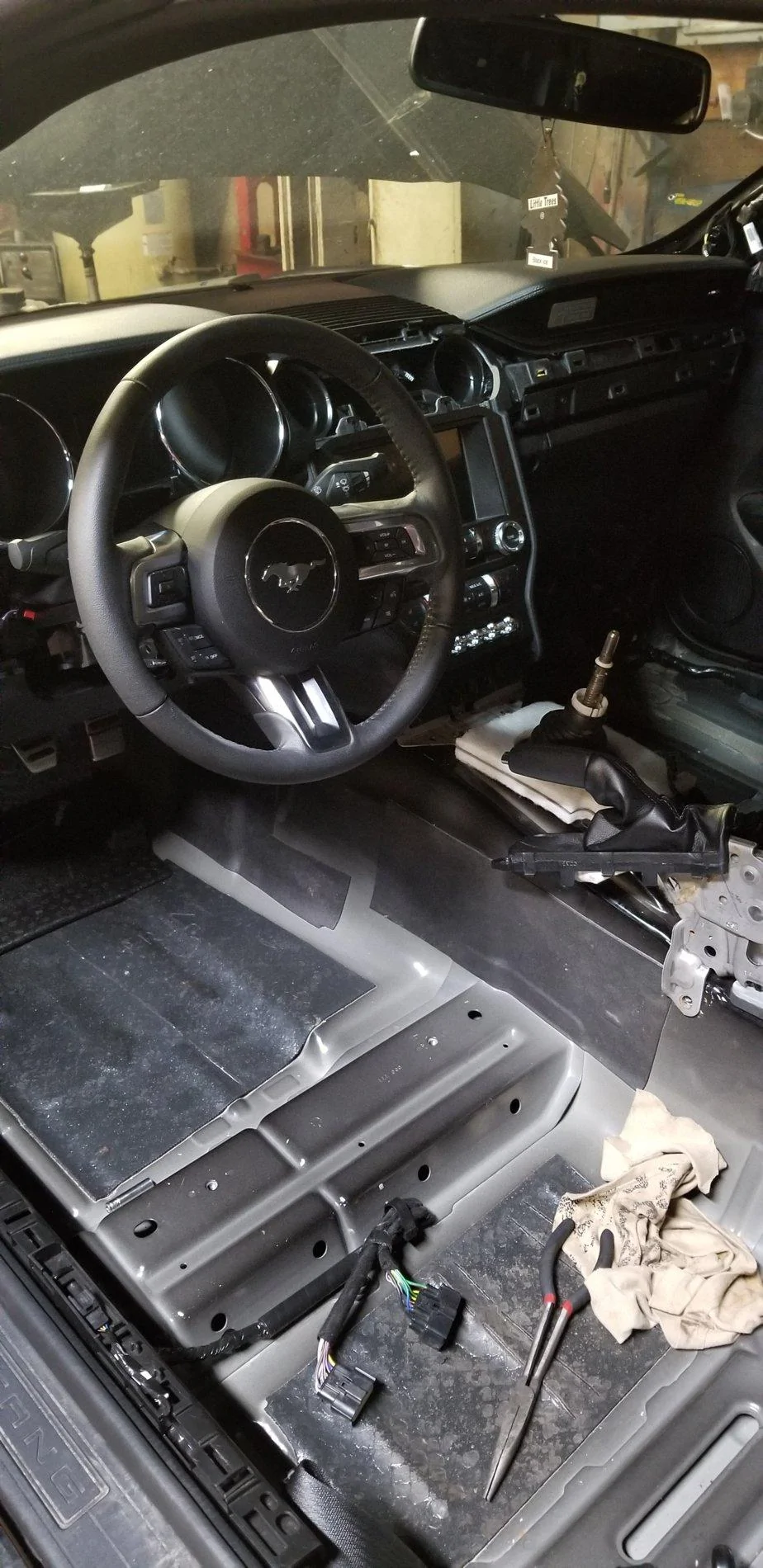

Harness in for the most part and enough of the dash to make sure it still runs

It still starts and runs. Now for all the problems and things not expected. Harness that runs up the left rear pillar has the sirius antenna connection which im going to have to cut the roof to install. Right front pillar harness runs to both visors and overhead which makes the headliner having to come all the way down. Both door harnesses are needing to be swapped for obvious reasons. More speakers and door modules to name a few and this premium had blind spot monitors which need mirrors also swapped. I only had sound from the center dash speaker. Original harnesses windows still worked somewhat and now i changed the driver door harness and have sound from the door speakers but the window doesnt work at all now, most likely bcm programming as the old window switch was a bunch of wires and now there is only 3 meaning a can signal to another module to carry out the operation.

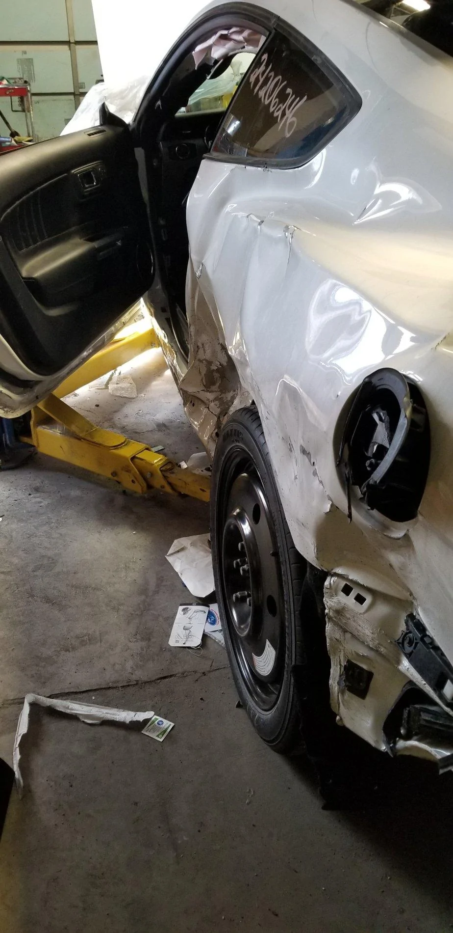

17 gt pp m6
I got the donor car for 11k which i hope to recoup 8 to 9k from selling motor trans rear diff front brakes etc. So 2 to 3k and alot of time to swap and might have to spend a couple $ to get everything programmed correctly. Probably cheaper to just buy a premium but i buy salvage stuff to save $ and you cant pick and choose
