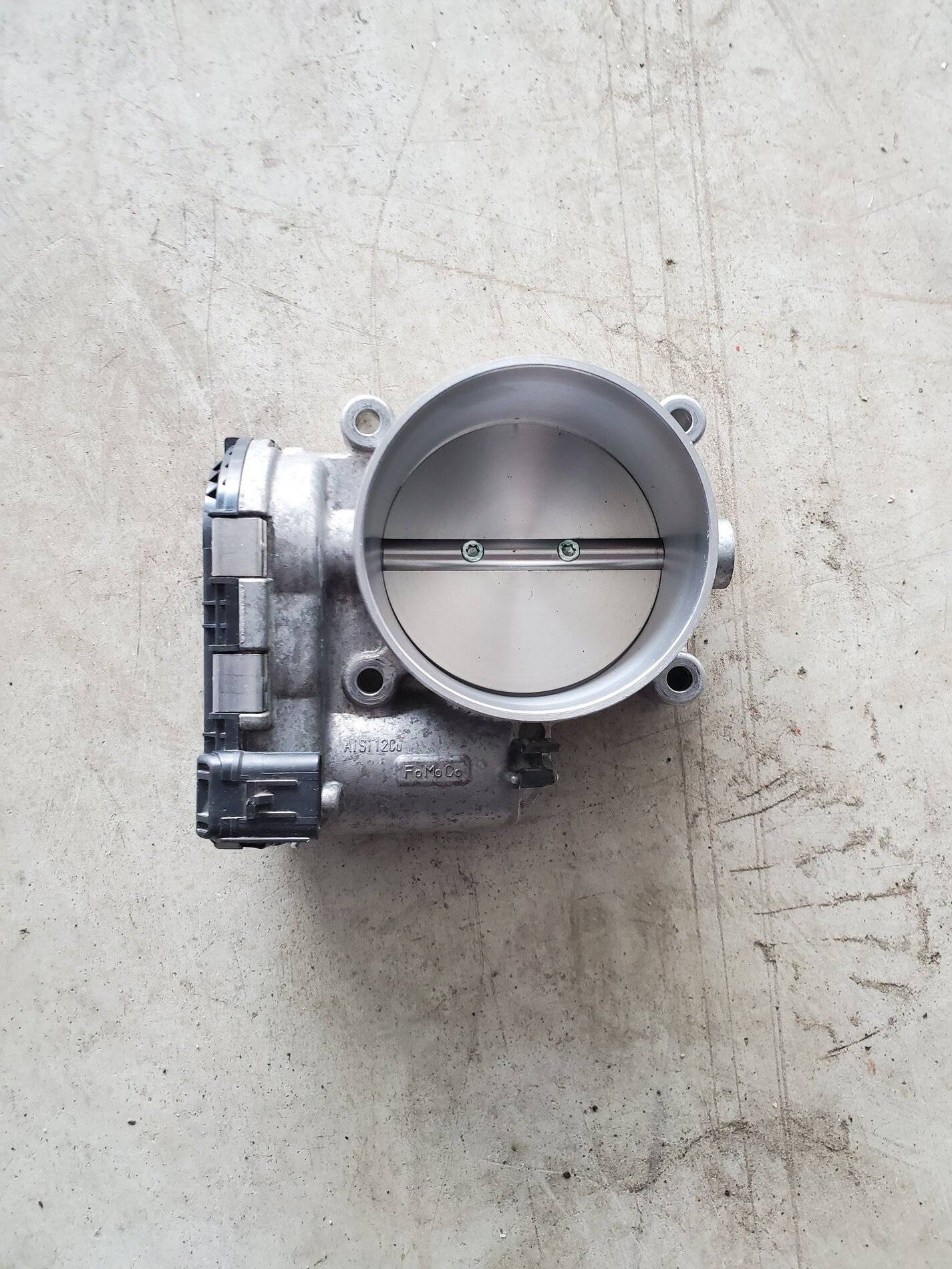

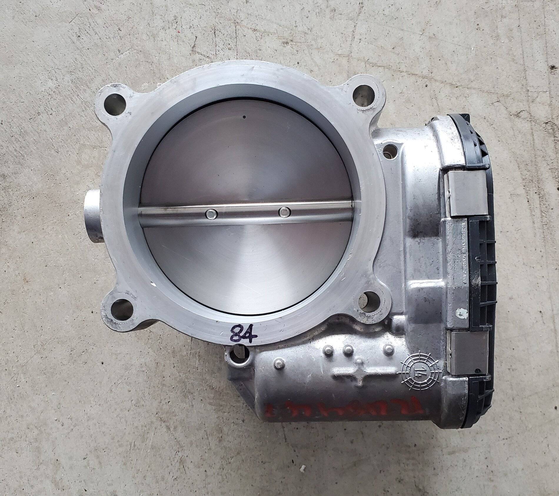

I have a TB off of a 16 that I had bored to 84mm. Never been on the car since rebuilt...had it as a spare $150.

If you want to buy my 2019 TB, $75 plus shipping, let me know. Only 4,000 miles on it.
