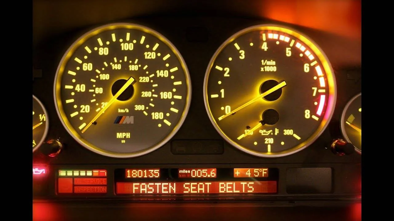

Some BMW M cars have progressive redlines with additional lights that go out as the oil warms up. That can be a useful reference; on my E39 M5 the "orange" line is 4k RPM when the motor is cold, and ~6k RPM when the oil is up to ~150F, and the full 7k RPM when the oil is at normal temp (the S62 V8 runs a bit hotter than the Voodoo, ~200-210 in normal driving). Photo not my car:
