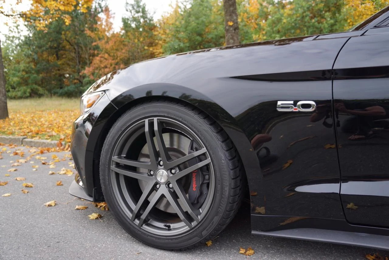

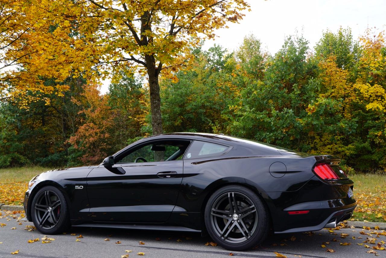

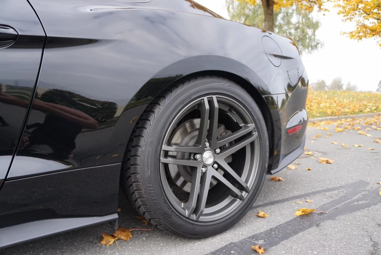

5) The stance of the car is exactly what I wanted. Mind you I installed 1/4" spacers in the back to give the dead-even look. As this is a subjective topic, I provided photos below so you can judge for yourself.
6) Ride height is surprisingly good, even with 19s, as I have not bottomed out on anything (and trust me, I drove in some dodgy parking garages in Czech during the testing phase). The front splitter barely clears European parking blocks as well.

Great review, thank you! I have ultra-lites sitting in the garage for the past year. Torn between getting Steeda Pro-Action or FRPP Track shocks and struts.
Can I ask which 1/4 spacer you used for the rear height?
And what wheels are those? They look great!

Thanks for the compliments Mike. As far as the spacer, I used Steeda’s 1/4 billet piece. My wheels are Axis Sport XQ 19”...only 23lbs/23.5lbs a piece for $169/$189 a wheel. I’m a bit biased as far as shocks, so I’d vote for Steeda fixed or adjustable. The value (especially on black friday) is tough to beat.

So you have a 1/4" spacer in the rear to lift it back up? And those pictures represent this?
That slightly concerns me because I was considering the Ultralite springs primarily because it was supposed to be slightly more drop in front than the rear. I want a near even stance with a slight forward rake.
Looking at these pictures, it looks even to me, and that's after you said you lifted the rear back up.
