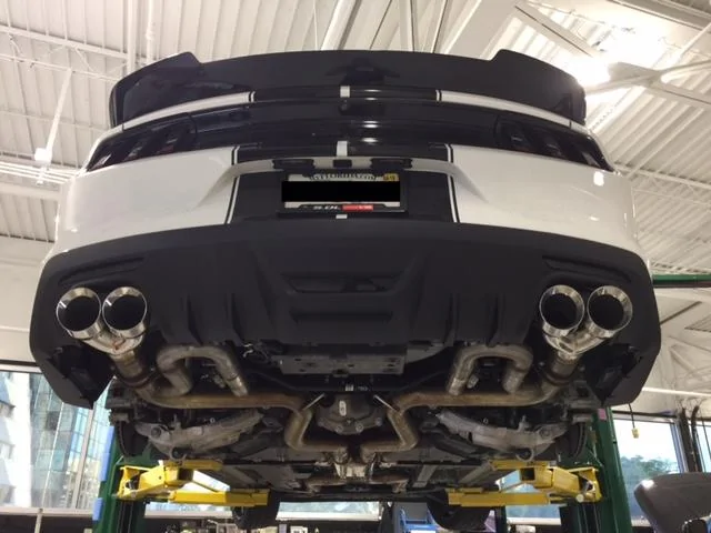

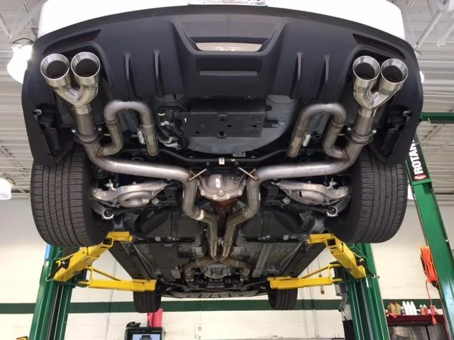

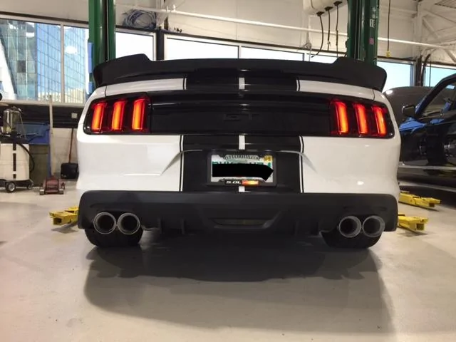

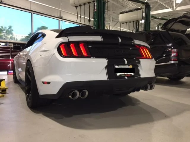

Easy setup for people looking for quad tips on their mustang without crazy price.
Solo performance exhaust (that's cat back or axle back)
Roush rear valence
Quad tips from stangmods.com
Performed this mod couple times and it fits perfectly. Any questions just shoot me a message.

Had a couple of guys flipping out at my car at the Toyota dealership just the other day (picking up a part for the T4R), one guy couldn't believe how it sounded ("I've never heard a GT sound like that!?").
This Solo exhaust creates a really unique sound, it's got some muscle car growl mixed with a sort of exotic burble - of course, I gave it a little rev when parking :D
Looks great, might have to do this. Solo also makes a few dual tip options, have you looked into using one of theirs? It would also be bolt on (the mustang mods tips are weld on, right?)

Wow the tips are so big. I am thinking if I wanna just trim the plastic.

What's that smaller pipe coming off the insides before the exit? Like a return line or something??? Is that where it gets the unique sound from?
Looks awesome, can you link all the parts. And a sound clip please! Thanks
The exhaust is from Solo:
https://solo-performance.com/performance-exhaust-system
There's 3 catback options, where the center section is the difference, an X (loudest) , the Thunder with 11" mid-muffler (medium), and the XV, 18" mid muffler (quietest).
That J-pipe / Helmholtz tube, is a noise cancelling mechanism, works great without the need for a full muffler.
So it's a Solo exhaust, the stangmods.com dual tips and a Roush rear valence. I'd imagine you could do this with any exhaust, but the way the Solo is designed it might be easier (since it's just a pipe directly out).
$875-950 for a Solo catback
$189 for the dual tips
$225 for the Roush from various vendors
