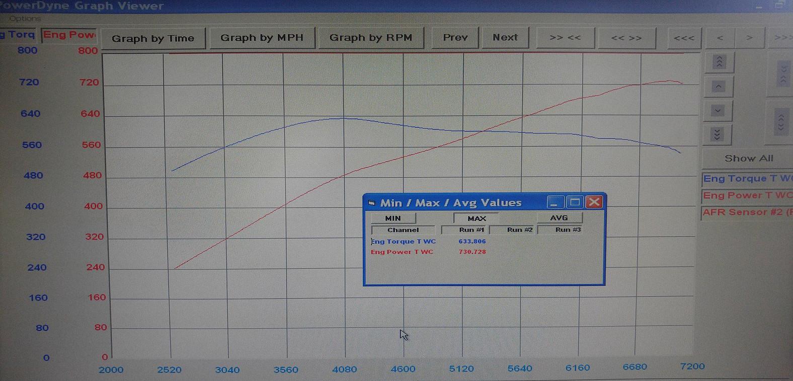

We made a few runs of these, and decided that we would start from scratch by building manifolds. This setup made good power, and ran 10.10-10.20 @ 138-140mph on stock engine/full weight vehicles

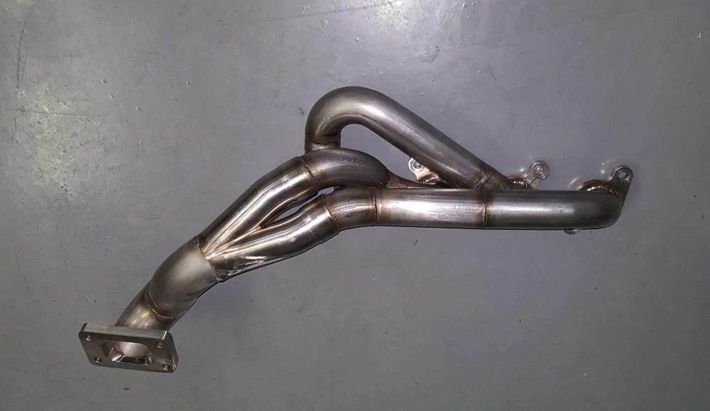

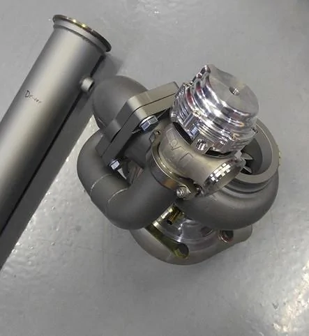

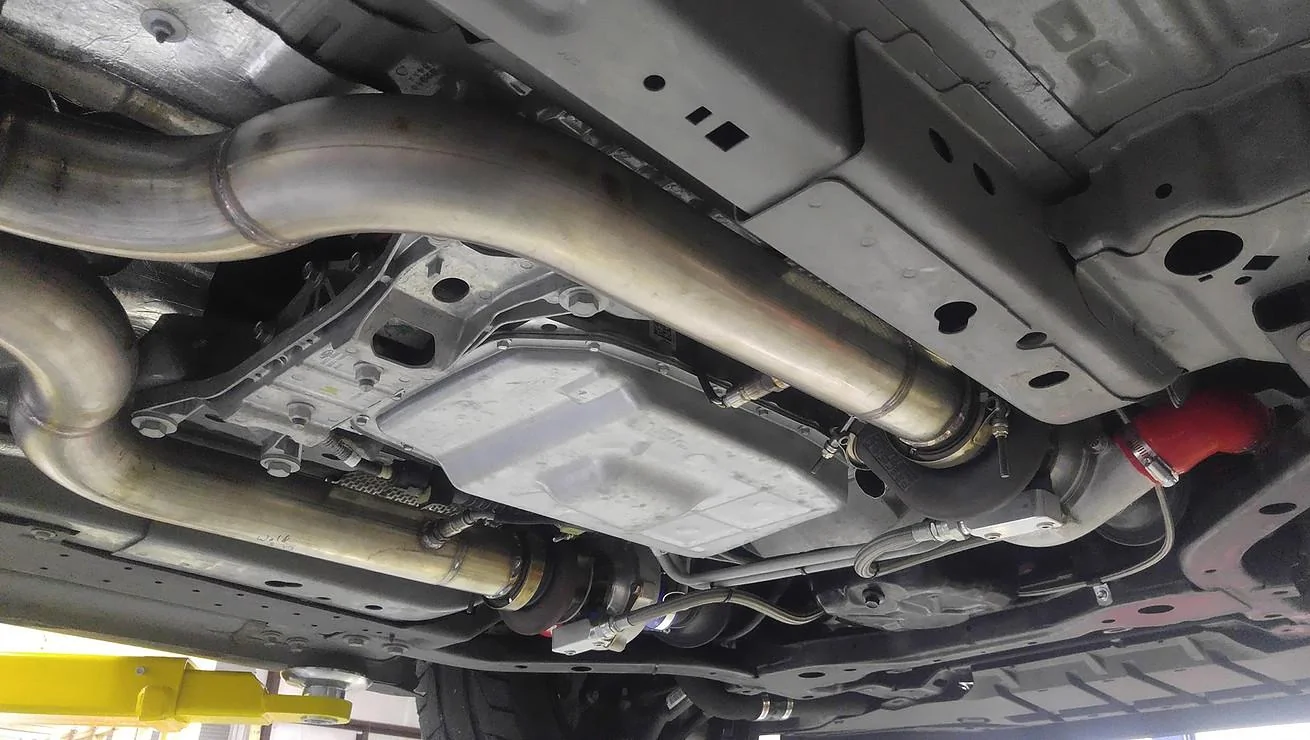

A handful of customers purchased these kits, and in late summer/early fall of last year, we decided to upgrade to the full manifold design. It took us quite a while to get it right, as tucking the turbochargers up higher meant tighter tolerances. However, having them up 4-5" above the bottom of the sub-frame made for a much safer design.
By December, we had a pretty decent design that we were happy with. It sounded great, had very low back pressure, and was proven up to 1200whp at that point. We decided to build jigs and press forward with production. The handful of folks waiting patiently were anxious to get their kit(s).
After a few minor tweaks during the production process (test fitting), we were producing kits at a decent rate of speed. Everything looked great, and we were finally going to be ahead of the curve so it seemed.
In February, one of our mail-out kit customers called us with a few issues. Fitment wasn't quite right on his vehicle, and we asked him to send us the parts back to check/replace. This raised an eyebrow for us, as our fab guys are supposed to build/check them on a mock-up/dummy engine before they are signed off on as "good".
While things looked ok, what we didn't realize was that one of our own employees was being lazy. By not bolting down the manifold fully in the fixture, the flanges were allowed to warp. When warped the manifold would distort. Then, once bolted to a head with all of the bolts, sometimes it would make contact with the bell housing, or steering shaft, etc. Obviously this wasn't ok, but it was going on without management's knowledge.
Once we finally figured out what was going on, the person responsible was let go, and we started digging around in his area. We found around 10K worth of horribly built manifolds stashed under his fab table. Along with the few sets that were sent out and returned, this came out to almost 15K worth of product and labor to replace it. Not to mention the handful of very unhappy customers. Here's just a few of the bad manifolds. We hung them up on the wall as a reminder of how important it is for everyone to be on the same page.

The attention to detail that these guys are cranking out now is incredible. Everything is back-purged with argon gas, and comes with a lifetime warranty!
