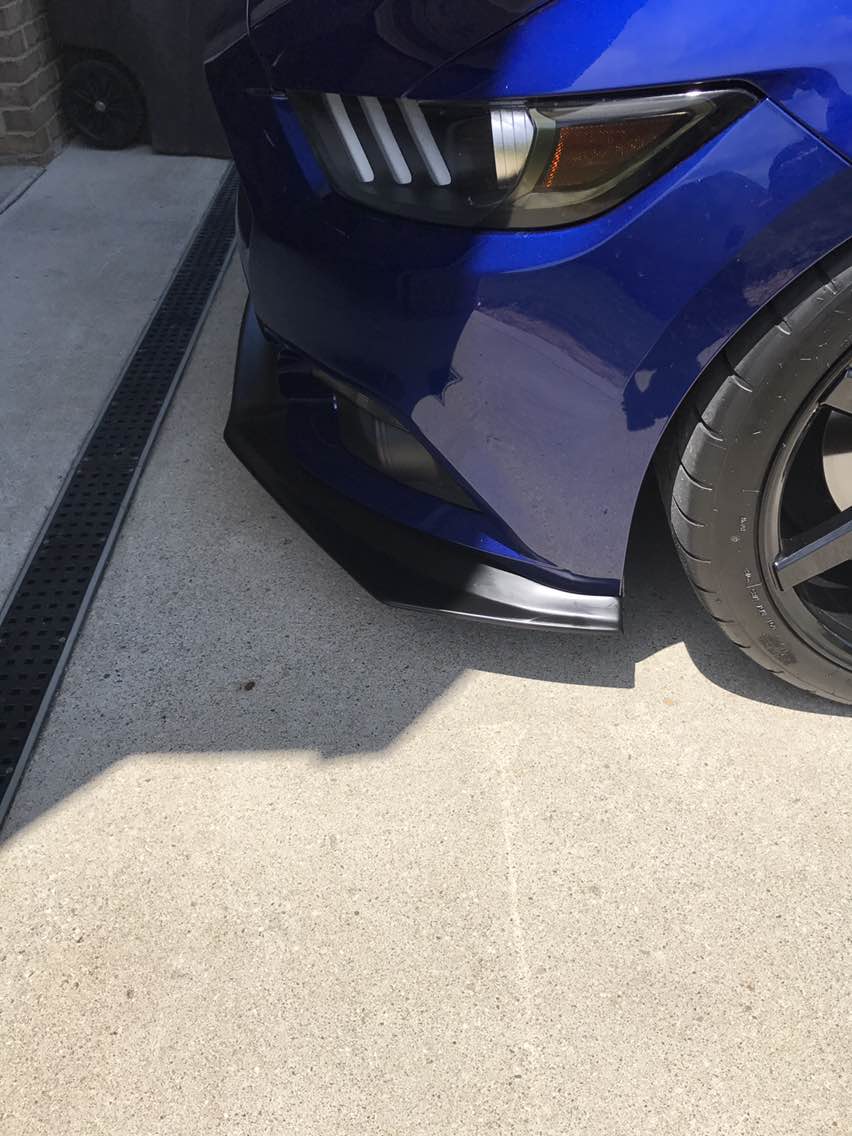

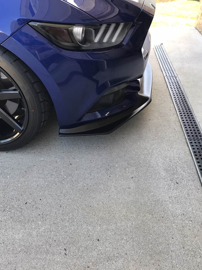

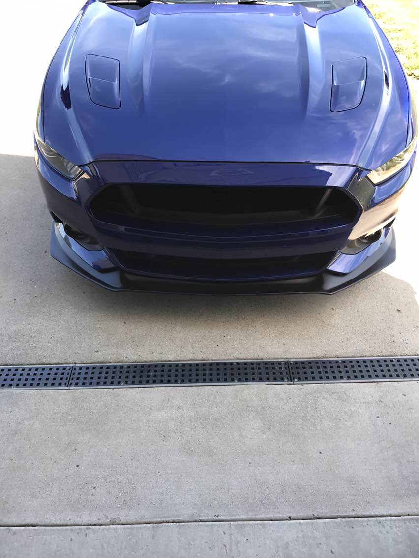

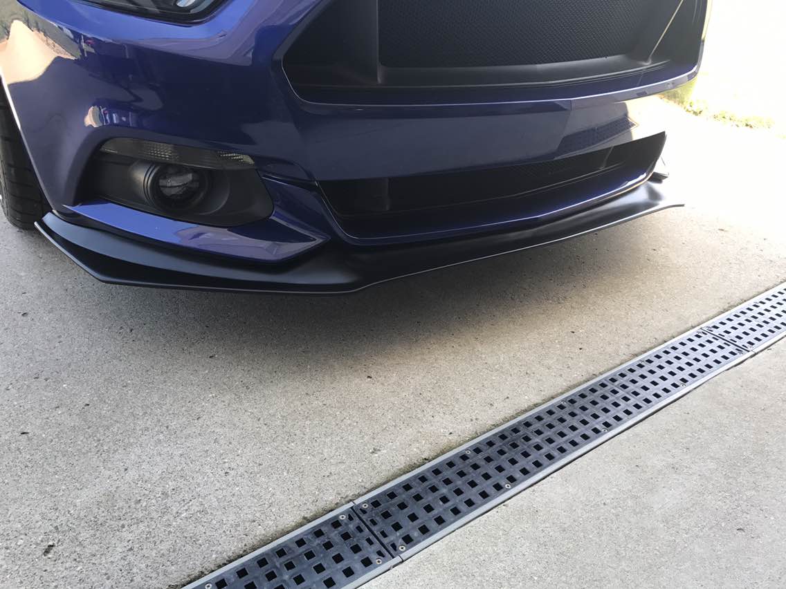

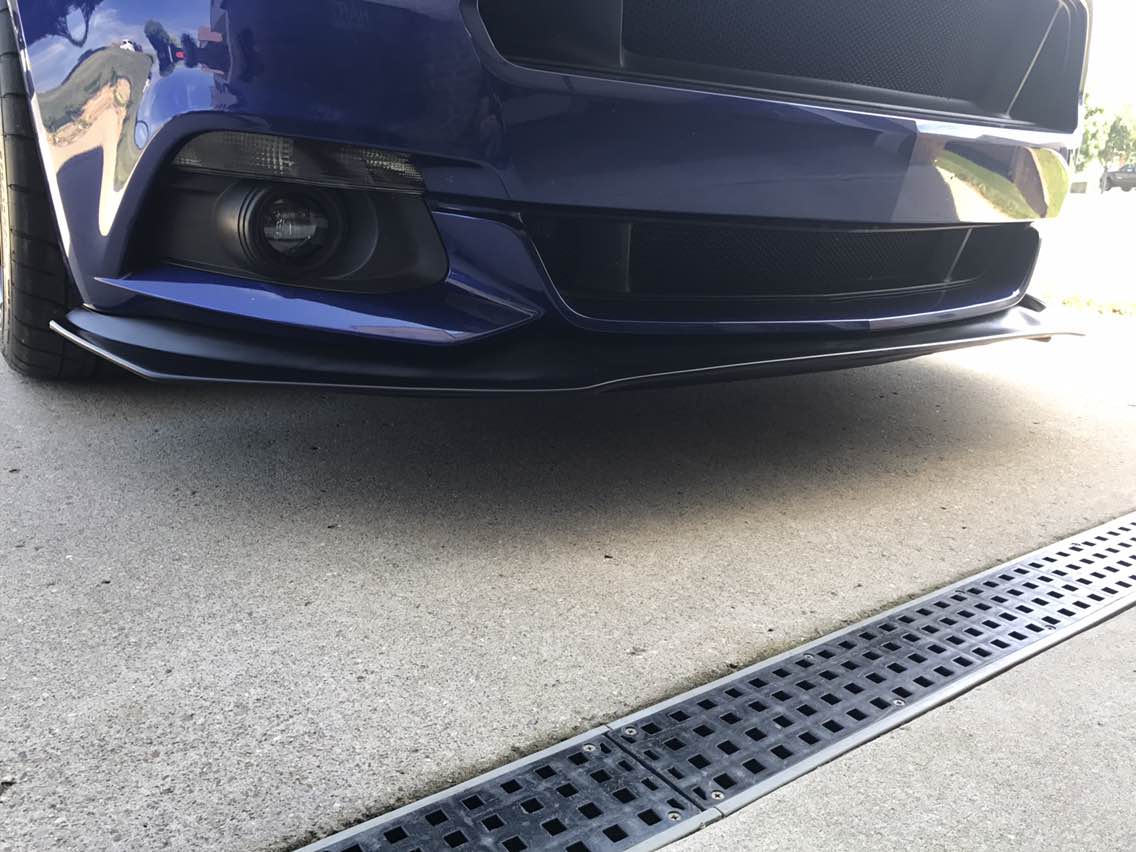

Ikon Motorsports replacement front chin spoiler. Purchased from eBay for $99 Shipped.
Installation: Remove front bumper, remove factory chin spoiler, Ikon splitter lays over top the factory chin spoiler, match up your holes and drill holes into ikon splitter, place front bumper back on top of chin spoiler & splitter and start reinstalling.
Now sounds easy enough but the fitment is not great and the ikon mold is not perfect or snug over top the oem chin spoiler. Overall it is cheap and a diy installation process. But I like the way it looks installed and it is stationed securely with no movement. It is hard to clean and shin up only because it is smooth untextured plastic but it would be ready to paint if needed.

Had a lot of compliments on the new splitter out driving. Still holding up.

Fit isn't actually too bad on this. To install you need to fully remove your OEM splitter - this helps you line it up and put the necessary holes in (lay the oem splitter in this splitter on the ground). You'll need to put in all the upper holes that mount to the bumper. I used a solder gun tip instead of a drill and just put the holes in place. Once its mounted it sits over your oem splitter. It's thin but doesn't look too bad. I just wish it was factory texture instead of smooth and shiny.

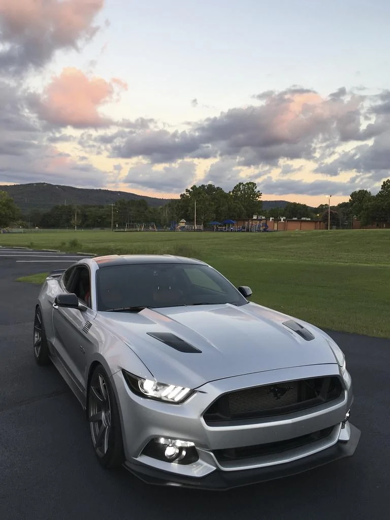

Just installed mine on my PP. Fitment isn't perfect (around the fender liners, etc.) but it sure looks nice. Came without instructions. Purchased from s550parts on instagram for $95 shipped.
It doesn't fit over the PP lip. On the PP, the OEM lip is actually two pieces. Drill out the two rivets and remove the "skeleton" support brace from the lip. Transfer it to the new lip. Slip it on the bumper, center, and drill holes to match up with the OE screw locations. I ended up using the OE hardware in the original locations with no tape. This method allows you to use the OE belly pan, however it doesn't completely cover the underside on the outer edges. Not a big deal IMO. As far as the appearance, I love it. The lines match the car perfectly.
