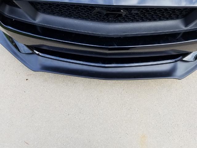

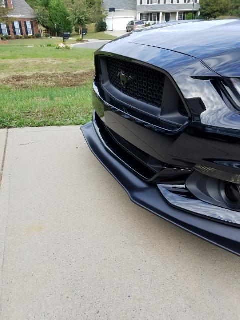

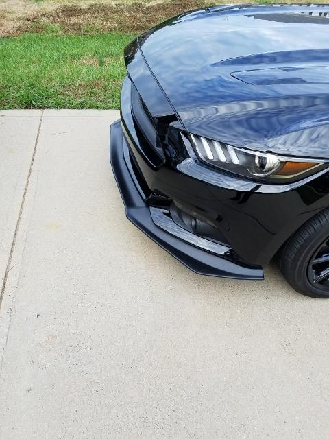

Just installed mine on my PP. Fitment isn't perfect (around the fender liners, etc.) but it sure looks nice. Came without instructions. Purchased from s550parts on instagram for $95 shipped.
It doesn't fit over the PP lip. On the PP, the OEM lip is actually two pieces. Drill out the two rivets and remove the "skeleton" support brace from the lip. Transfer it to the new lip. Slip it on the bumper, center, and drill holes to match up with the OE screw locations. I ended up using the OE hardware in the original locations with no tape. This method allows you to use the OE belly pan, however it doesn't completely cover the underside on the outer edges. Not a big deal IMO. As far as the appearance, I love it. The lines match the car perfectly.
I just installed this lip yesterday on my car it looks pretty good but the only thing that I really don’t like about it is the middle kind of curls up! Unlike the PP lip that continues to flow in a downward direction
I don’t think that it is flexible enough to take that upward angle out without breaking are crackingsame here...was thinking of adding struts to try and get rid of the curl. not sure though. but i do like the way it looks. for the money i dont think its too bad.....
mine seems fairly flexible. can get it to point down by hand no problem. waiting for struts now so we'll see what happens. let everyone know what happens as soon as i can get to it. :shrug:I don’t think that it is flexible enough to take that upward angle out without breaking are cracking
