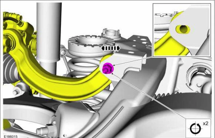

I installed the eccentric bolt and set camber, also set the rear. My lack of patience has gotten the better of me and will be going to get the car aligned. This process is way to tedious for my patience. Any how, my final settings up front currently are -1.8 LF -2.0 RF and -1.4 rear. The rear has about a -.6 to -1.4 adjustability. I have attached the illustration showing the bolt and slot where the rear adjustment is to be made. As I said, this is a very tedious task and also want the toe set properly (I am not even going to try lol) so im taking her in.

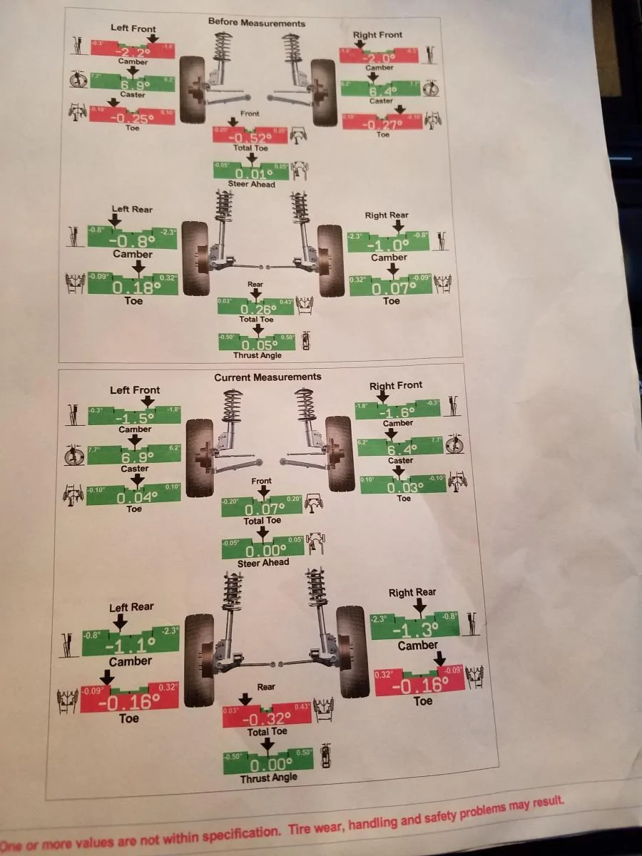

So the shop is giving me a warning of the settings specified by Ford performance. They are worried that I will wear down the tires too quickly. I guess I rather prefer them provide a warning then no warning at all. But please just set the alignment to the Ford performance specifications SMH
Zitrosounds
Zitrosounds
Oct 20, 2015
67
3,407
2,164
Madison, AL
Harold
16 GT350R/16 GT350TP/15 GT-PP/12 GT-PP
So here are the final measurements from the alignment rack. She is good to go and within FP specs. Check out the initial front toe!!!!
