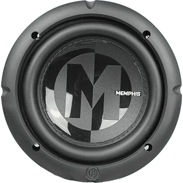

I have the premium shaker 9 speaker system without the subwoofer and it sounded weak, but I didn't want to spend a fortune upgrading it. This is my daily driver so trunk space was important, and I listen primarily to heavy metal so smaller subs would be better for me. As you can see the subs were mounted to the rear deck in custom boxes and it looks almost factory imo.
I went with an MTX Thunder 500 amp and Memphis PRX6D2 6.5" subs in a custom enclosure and spent right at $700. I think it turned out great and I finally have some good low end.

I see that the Memphis has a much shallower mounting depth than my JL solution. When you get a chance if you could measure the depth of the enclosure I would appreciate it!

The memphis mounting depth is 2.96" and my enclosure is just over 4.5". That MTX amp is only 2.25" tall, so you can see the enclosure is about double it's height. I know it's hard to tell from the pic, but it's a really tiny amp.

Thanks for the info! The subs I am looking at are around 4.5 in depth which would make for a much deeper enclosure. Based on yours I have the visual. Enjoy!
