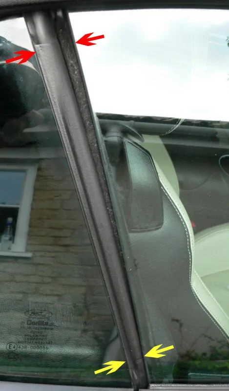

I think I have this same rear window problem on my 2016 'vert. It's done just over 15000 miles. It's the RH rear window (in this case, the driver's side) and the rather poor picture below shows the problem...
As well as rising, the closing motion involves rotation in a fore and aft plane and this doesn't complete properly - leaving a large gap with the front window at the top (arrowed in red) compared with the much smaller gap at the bottom (arrowed in yellow).
The gap can be reduced by manually pulling the top of the rear glass forward (after which it can't be pushed back again), but the window still ends up slightly misaligned. Is this the same problem as yours MustangS550?
