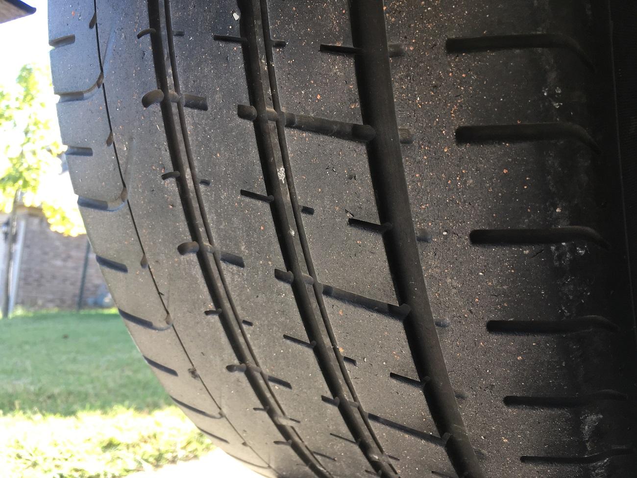

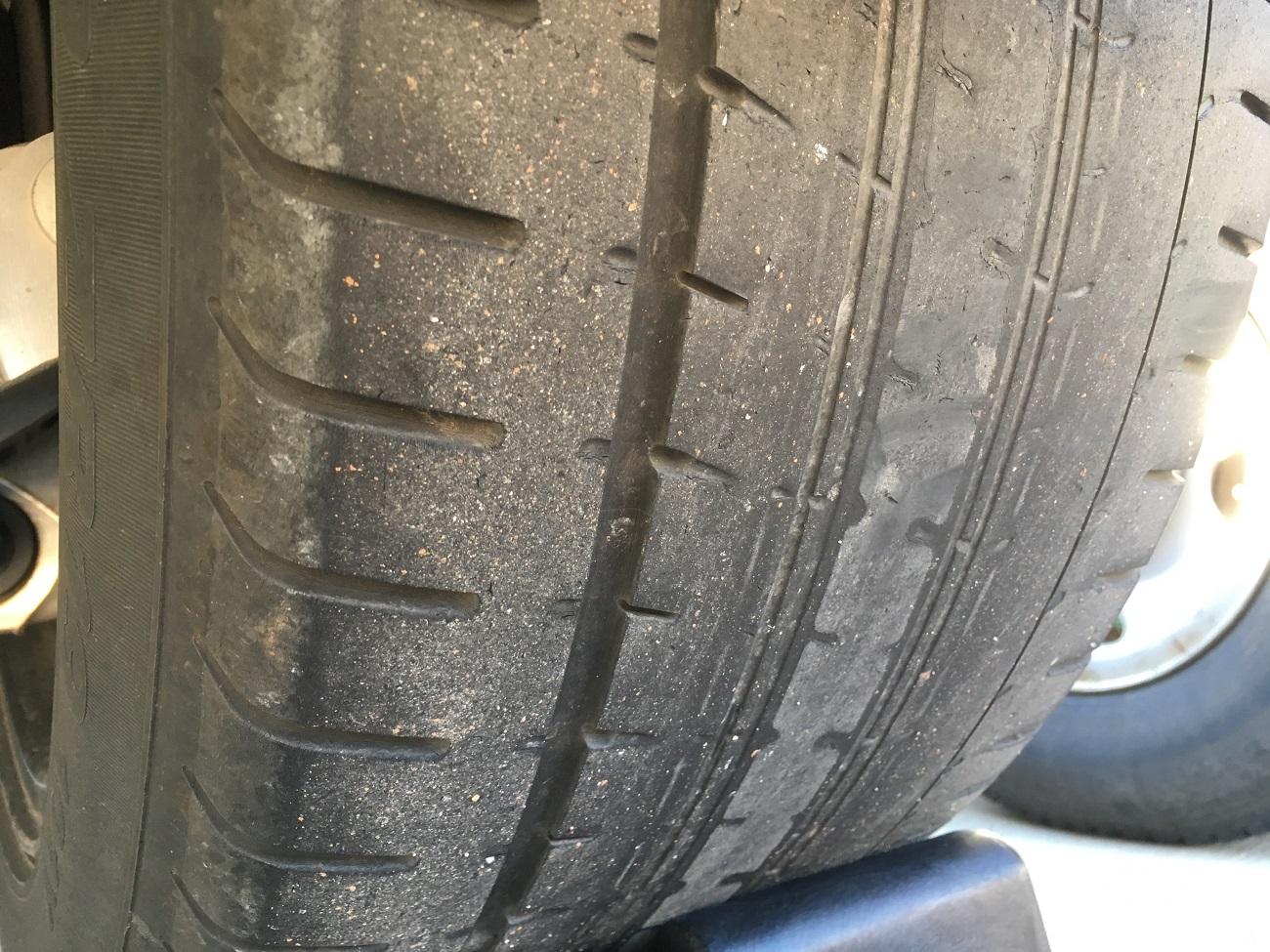

I have this same issue. Dealership will check alignment on Monday.
16,200 miles
0 burnouts
0 rotations
32 psi all around
Passenger Side:
Driver Side:
I'm thinking this might be a power to the wheels thing, but I want my alignment checked before I drop $1,200 on a set of Michelin A/S 3+ tires.
