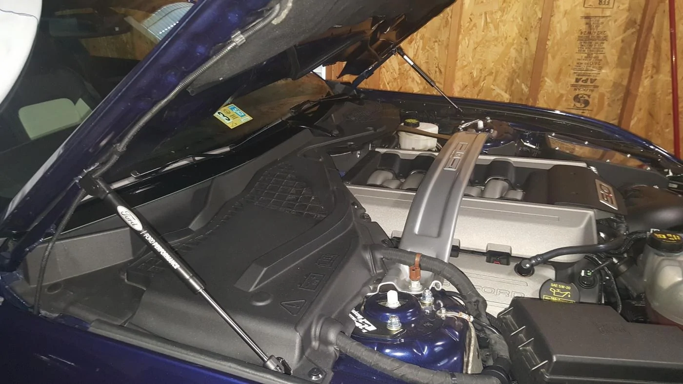

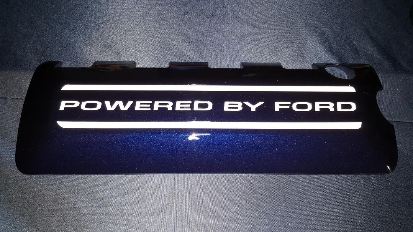

For those interested in painting your coil/engine covers, I found a great tutorial online that gives you the step by step details on how to do this. I followed the steps and made a few changes and I think the results turned out awesome.

Before Pic
Coil cover painted

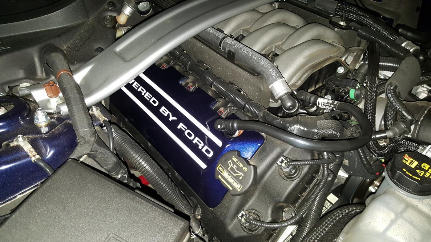

Coil Cover installed

Automotive touch up FTW. I have used their products in the past as well. I did an entire body kit which contained full front and rear bumpers and side skirts for the rockers and used their paints and clears. Never needed to do any blending, it was spot on perfect out of the can.
Well done, looks great.
I would like to see what you did to the engine cover though, don't see it in the pics

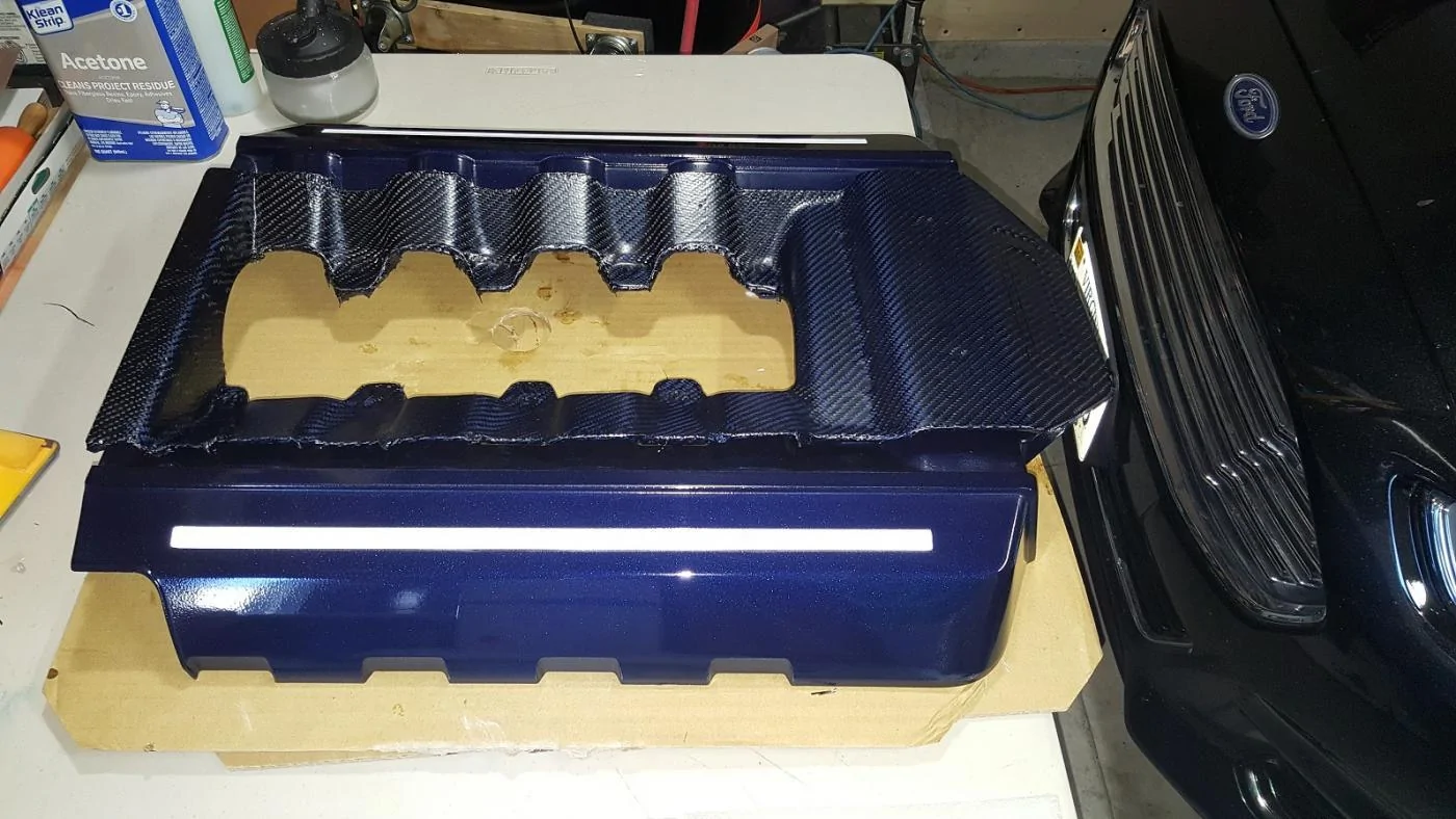

Still working on the engine cover. Need to finish sanding and buffing it but the big hold up is the center section that I am covering in Blue Carbon fiber. Needs more coats of Epoxy and then sanding buffing.

I can see what you are after. Man after my own heart, Matt. And like me I'm sure you wont be satisfied till its "right"
I haven't looked at the cover in detail yet, but is the center removable from the rest without destroying the connection points?

The center I had to drill out the plastic rivets. Drill the holes out the put a bolt in its place worth a washer and use nuts to tighten it back together. The epoxy should hold the bolts place as long as you don't torque on it.
Its just sitting on top right now to see how they look together. I think I'm going to airbrush the 5.0 over the carbon fiber in white.
Did you vacuum seal the CF on? If not, you did a hell of a good job by hand! :thumbsup:
