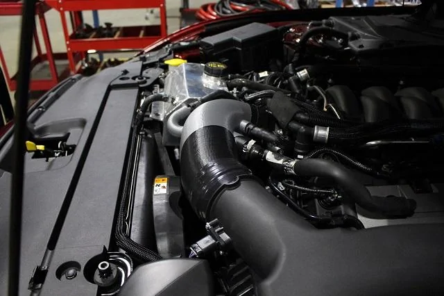

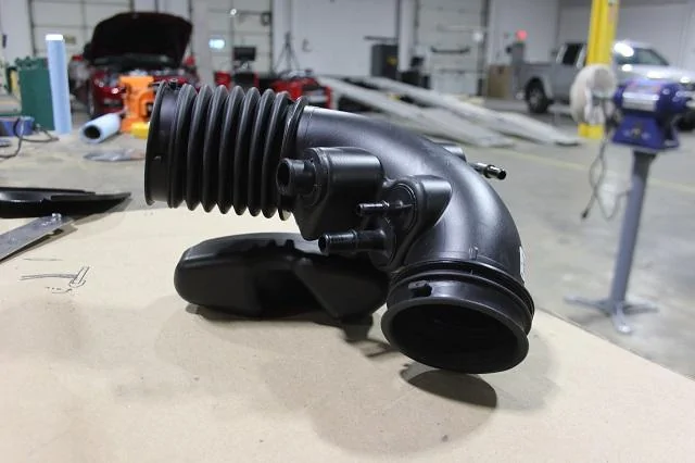

Improving airflow is now a recurring theme for the stock 2015+ Mustang GT intake. In addition to finding air flow restrictions in our project to replace the entire stock intake system, we’ve also found several ways that a silicone induction hose for S550 drivers could improve airflow for drivers who would rather not replace their stock intakes. The stock piece is not only restrictive in size, but it also makes use of a resonator. We can make several improvements to take this induction hose design to the next level.
The hose itself is straightforward, except for the number of ports and attachments. We will be including those four ports in our design and will incorporate quick-disconnect fittings. Take a look at the image below.
To increase the amount of airflow that can travel from the airbox, we must enlarge the entire tube. This will produce give us an increase in volumetric area inside the tube. Although our goal is to increase airflow, we want to ensure consistency with this increase to prevent turbulence. With more airflow we hope to increase power as well.

Where is your data to prove the stock tube isn't good enough? Where is the data to prove yours is better?
This!!
When people see bellows or expension joints they assume the flow is restricted. There is no way this type of design restricts the flow. It is a smooth almost 90 degree elbow and the pressure drop through that piece should be the same with the same diameter piece. We need some proof to see that the factory piece is restricted. CFD analysis or some sort.

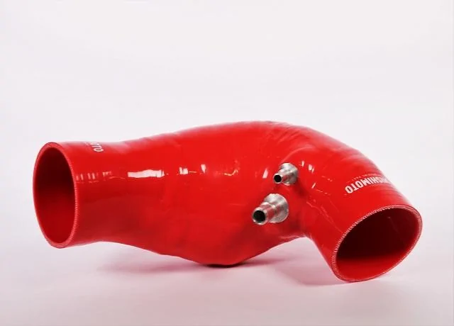

We are now one step closer to completing this induction project! The bulk of our testing is just about finished and we have gotten some awesome results. One of our biggest objectives was to increase the internal volume over the stock intake. With more air surging through the hose, the potential for improved power output is increased as well.

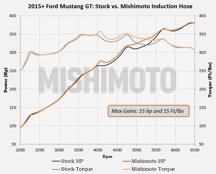

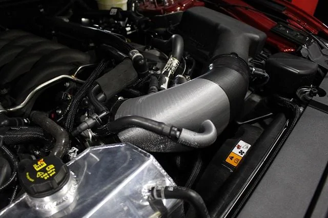

In our previous post, we said we would include all four ports and attachments. However, we decided on a complete omission of the sound imposer port. You will see what that looks like later on in this post. The 3D printed part you see above does have the port, but it is blocked off, simulating how the final design will perform on the dyno. Speaking of which, let’s look at our dyno runs!
[ame]
The stock intake tube begins at 95mm from the top of the airbox, which then leads into the accordion section that necks down to 87.5mm. The throttle body section necks down slightly more to 86.5mm. Our induction hose is a different story. The measurements were nearly the same, but the key difference is the internal diameter. The hose starts out the same size as stock on both ends, but it increases to 121mm at its center! This is definitely a contributing factor to the max gains of 15hp and 15 ft-lb of torque in the midrange to the top end.
We were definitely aiming for decent gains with this induction hose, but we were quite shocked when we saw just how much we’d get. Either way, although specific to a certain power band range, we got consistent runs with this output improvement, so this is going to be an excellent add to your S550. This will, also bode quite well for the full intake kit we are making for this car!
But what does it look like now?
The Big Reveal

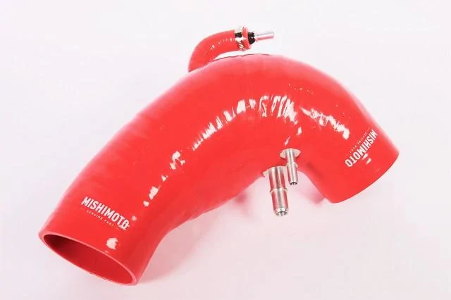

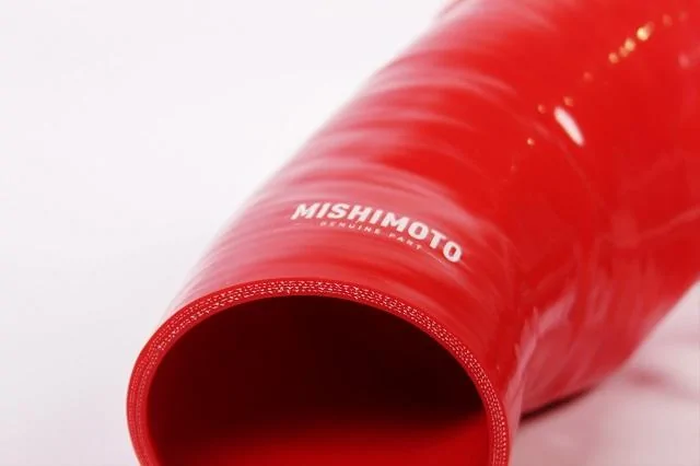

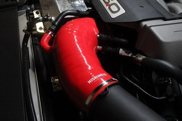

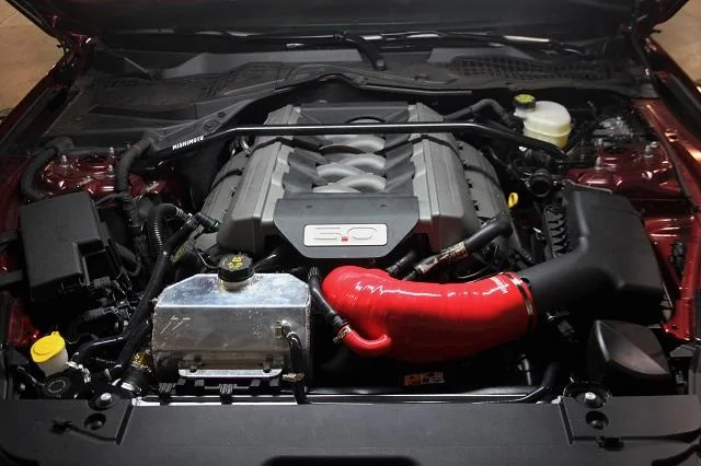

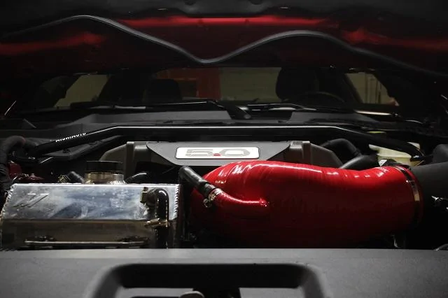

Our production samples finally arrived, and boy, do they look good! This induction hose will come in black, red and blue, and since we have a beautiful Ruby Red S550, we threw our red hose on there. This induction hose has an awesome yet subtle aesthetic underneath the hood, which would make any owner proud to show off their engine bay. This hose is a direct fit into the 2015+ Mustang GT without any cutting or modification required. The five-ply silicone is reinforced with steel wire to prevent misshaping under vacuum, and the hose will stay durable enough to last as long as you have your GT.
What’s pretty neat about this induction hose is how the key design element that produces the power is nearly hidden from sight. The underbody of the hose has that deep curve, fairly difficult to see at first glance, which contributes to its subtlety.
Let’s check out some install shots!
