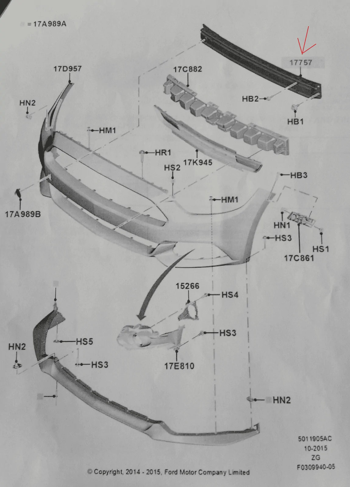

I just found some info on a different model year's part.
Its only 12 lbs.
http://scrs.com/data/uploads/pdf/Ford_Structural_Parts_Fact_Sheet_Final_7-21-10.pdf
2005-09 Mustang List Price (3-26-2010) $176.08 $98.99
Front Bumper Beam Material Boron Steel Mild Steel
5R3Z-17757-AA Material Cost/Pound $57.00 $40.35
CAE Test Performed Weight 11.90 lbs. 11.15 lbs.
Thickness 1.36 mm 1.20 mm
Production Process Cold Rolled / Heat
Quenched / TIG
Welded/Martenized
in production
Stamped / Spot
Welded
Maybe there isnt enough weight savings to justify it.

I don't think it's worth the 600 +. I think we could get a group buy and have a fabricatior to bend some multi cell extruded aluminum beams into front and rear bumper beams for close to a single GT 350 unit.
The only plus is the oem ones may crash better...

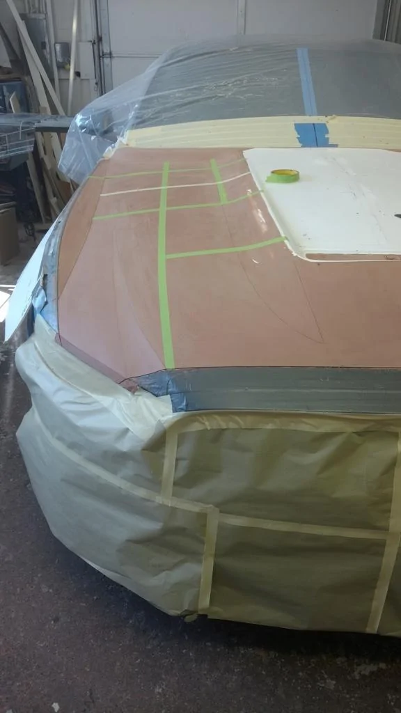

I reached out to Benny to inquire about a group buy. Without have someone fab some stuff up. I don't see a great alternative.
I am hoping to have one of Helion's GT 350 Style carbon hoods soon. That's likely to be a 17-20 lbs savings.

Yea pretty excited for it. Lots of work.
Benny mentioned they have to go freight, so that would likely negate most of the savings of a group buy.
