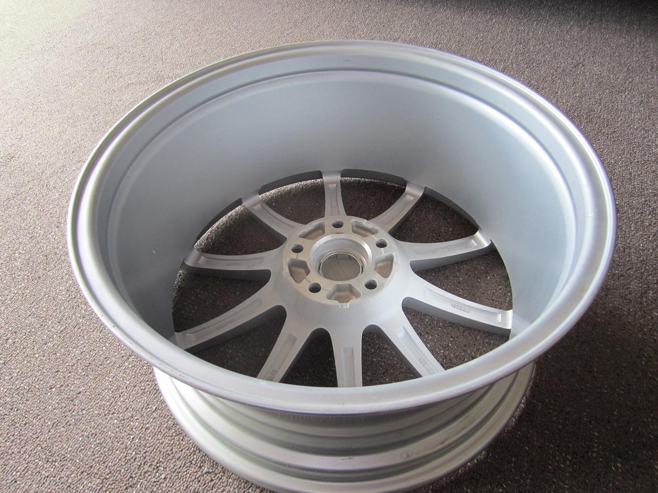

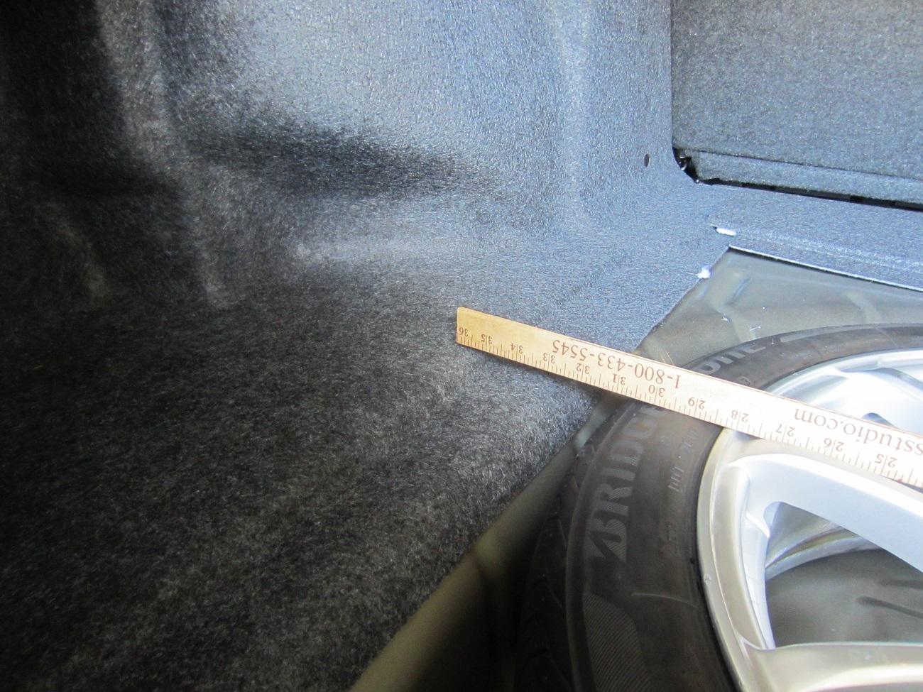

I finally completed my GT350 Spare Tire/Wheel Solution and I thought it was worth sharing, even though it may not suit everyone.

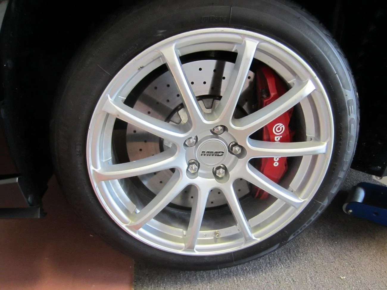

MY REQUIREMENTS:
1. Must be full size tire/wheel, and must fit into the spare tire well
2. Must be same circumference as OEM tires. (85 1/2 in. circumference)
3. Must Clear Brembo Brakes and must fit on Front Or Rear Of Car

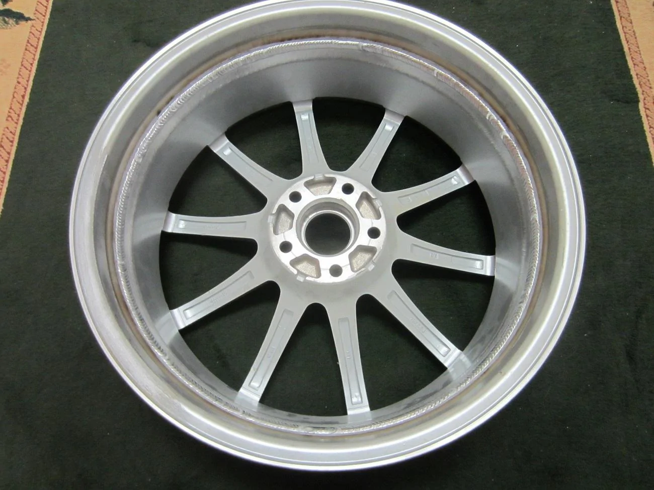

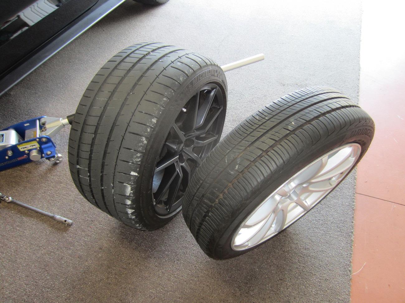

I started by finding the narrowest aluminum wheel that would fit on the GT350 Front and Rear. I caught a MMD Axim 19 x 8.5 Silver wheel on sale that was on clearance at American Muscle. (Cost 111.00)

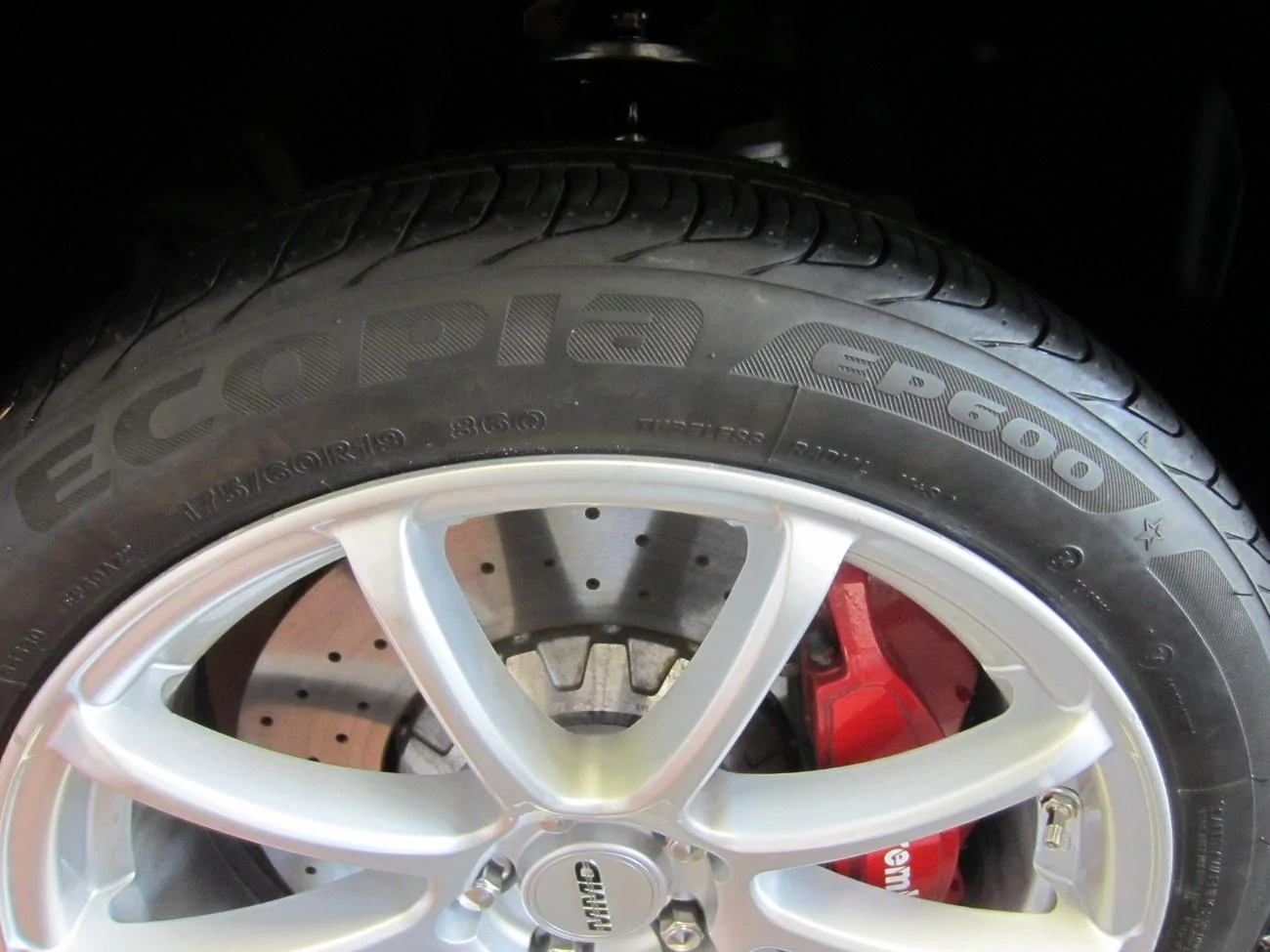

I then found a 19" tire for a 6 1/2" rim that would measure 85 1/2 circumference. I found a Good Used Tire (Bridgestone 175/60/R19 tire on eBay from (GoodUsedTires). Cost 53.00

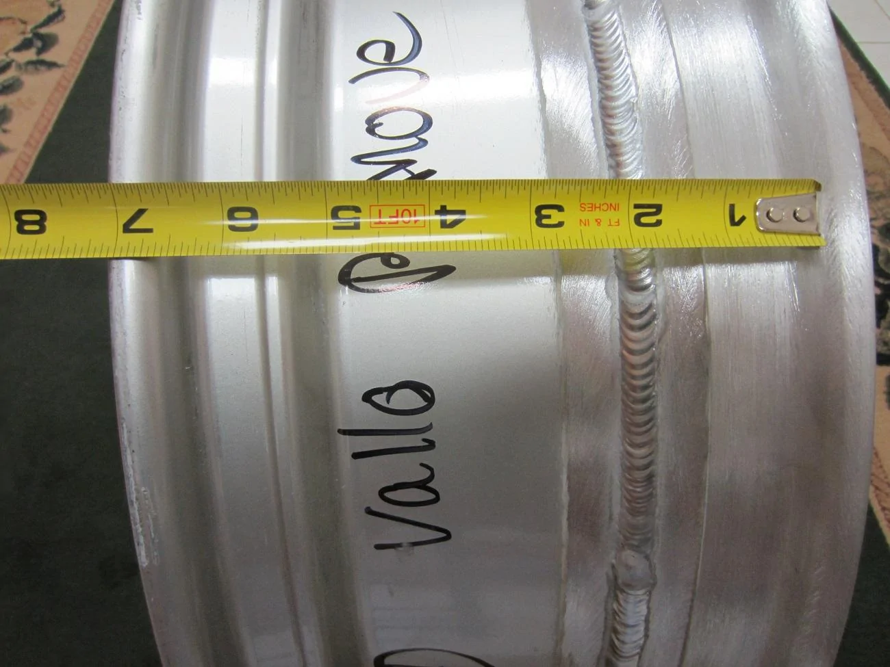

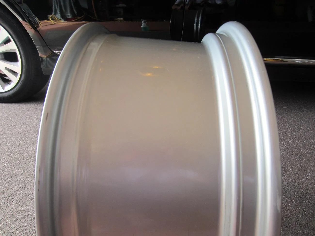

I Sent the MMD Axim Wheel to: WeldCraft Wheels Inc (Lavonia, MI) to have 2 inches taken out of wheel (Narrowed 2") (Cost 200.00) plus shipping both ways.
I bought a chrome Valve stem from eBay (Cost 2.50)
Total Cost: 394.00
