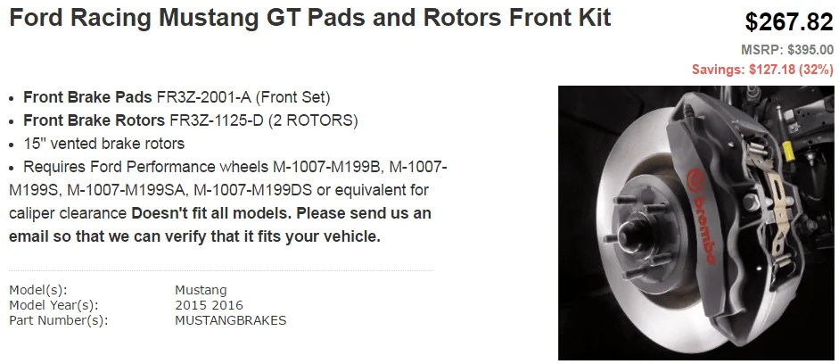

Firstly I went to find the rotors and pads, and I found them together as a set here for $267.82.

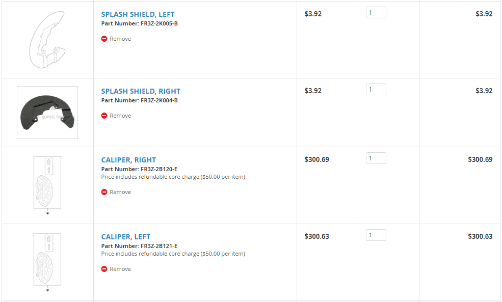

Then through Tasca, I searched out the shields and calipers which came out to $609.16.
Together this comes to $876.98. This seems like a huge savings over buying the kit from a vendor, but I am wondering if I am missing any of the components? From what I read on these forums the hardware, master cylinder, and brake lines are the same for either brake setup.

[MENTION=9199]LevittownFordSuperCenter[/MENTION] any idea why in this kit it mixes the performance pack 15 in rotors (paired with the Brembos) with the non-Brembo brake pads?

Have not done the switch yet, but planning on it. Attempting to figure out the most affordable solution. Did contact Tasca and was fortunate to find out the calipers listed come with the bleeder screw and caliper retainer kits, so that will save some money. Right now trying to figure out pad options and pricing.
You passed the test :)
Our bad not sure where this came from but we will update it.
Thank you,
Benny
