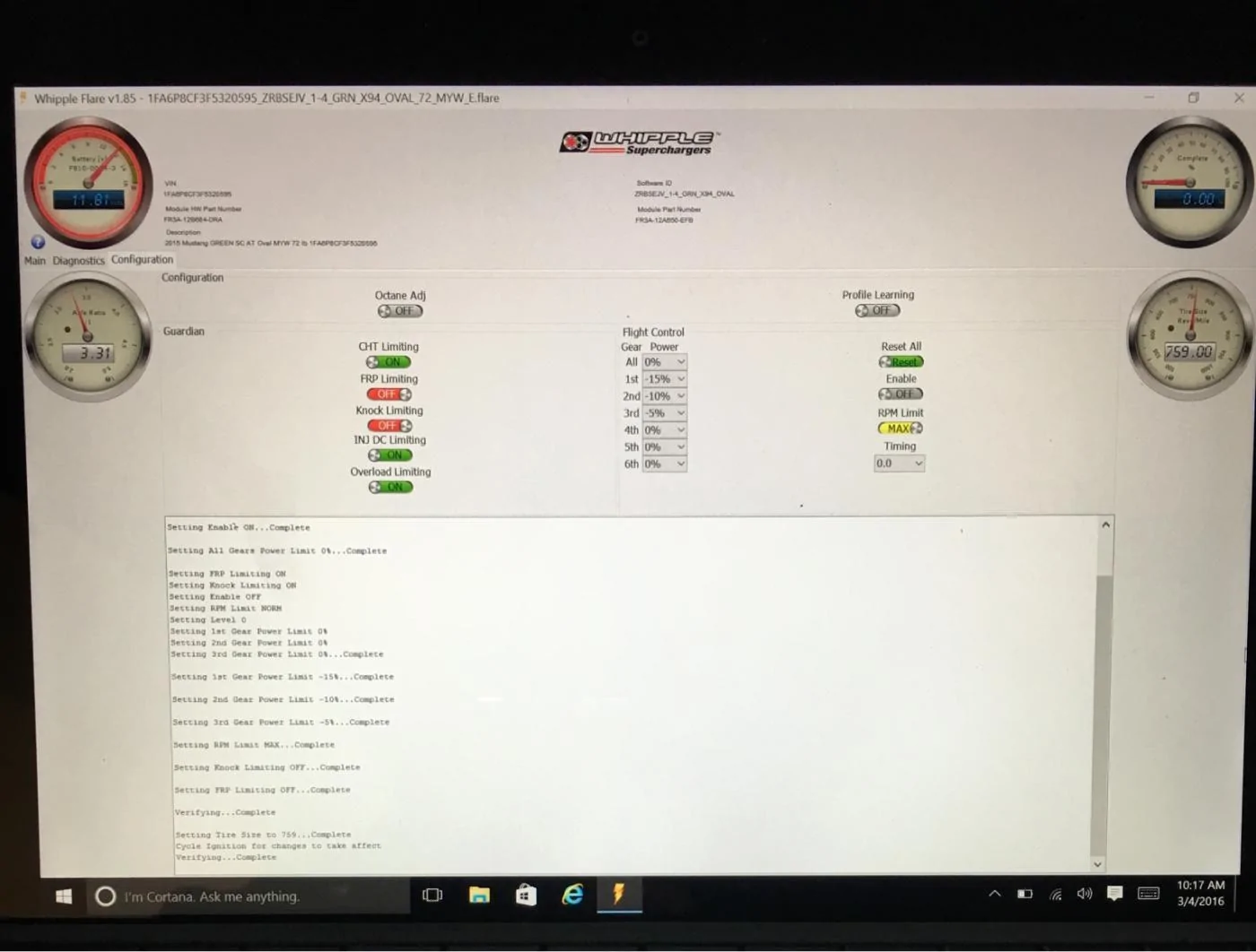

Hi, I just received my Flight Control cal and thought I would create a thread for all of us to share our setting and experiences with them. Maybe after we get a bunch of people commenting I can create an Excel file to keep things organized.
I thought we should keep editing our individual posts with results after trial and error and hopefully this would keep the information easily found.
These are the factors I thought we should compare. Let me know if you think something should be added or deleted from this list.
Anyway, these are exciting times for us Whipple guys & gals so let's share our experiences!
Jmeo's car (I will update everything once I load cal)
6 Speed MT-82
132mm TB
Enclosed Airbox
10 Rib Pulley Kit
72# Injectors
170º Thermostat
Original ICP (for now)
Kooks LT with "green" cats
McLeod RXT & Billet FW
Stock DS
3.31 gears with Torsen
MPSS 305/35/19 rear tires (759 RevsPerMile)
Configuration:
Octane Adjust: Off
Profile Learning: Off
Guardian:
Enabled: Off
CHT Limiting: On
FRP Limiting: Off
Knock Limiting: Off
Injector DC Limiting: On
Overload Limiting: On
Flight Control:
Overall: 0%
1'st Gear: 15%
2'nd Gear: 10%
3'rd Gear: 5%
4'th Gear: 0%
5'th Gear: 0%
6'th Gear: 0%
Enable: Off
RPM Limit: Max
Timing: 0.0

My initial flash settings
6 Speed MT-82
132mm TB
MMR Balancer
72# Injectors
170º Thermostat
carbon DS
Configuration:
Octane Adjust: Off
RPM Limit: Off
Timing: Normal
Guardian:
Enabled: On
CHT Limiting: On
Knock Limiting: On
Overload Limiting : On
Flight Control:
Overall: What %
1'st Gear: -25%
2'nd Gear: -25 %
3'rd Gear: -15 %
4'th Gear: 0 %
5'th Gear: 0 %
6'th Gear: 0 %

Thanks for sharing Jason. Your setting look good and most likely what I am going to start off with. I look forward to hearing your results when you get to work tomorrow :)

The flash seemed longer than previous cals and at one point every error msg available flashes on the dash.
