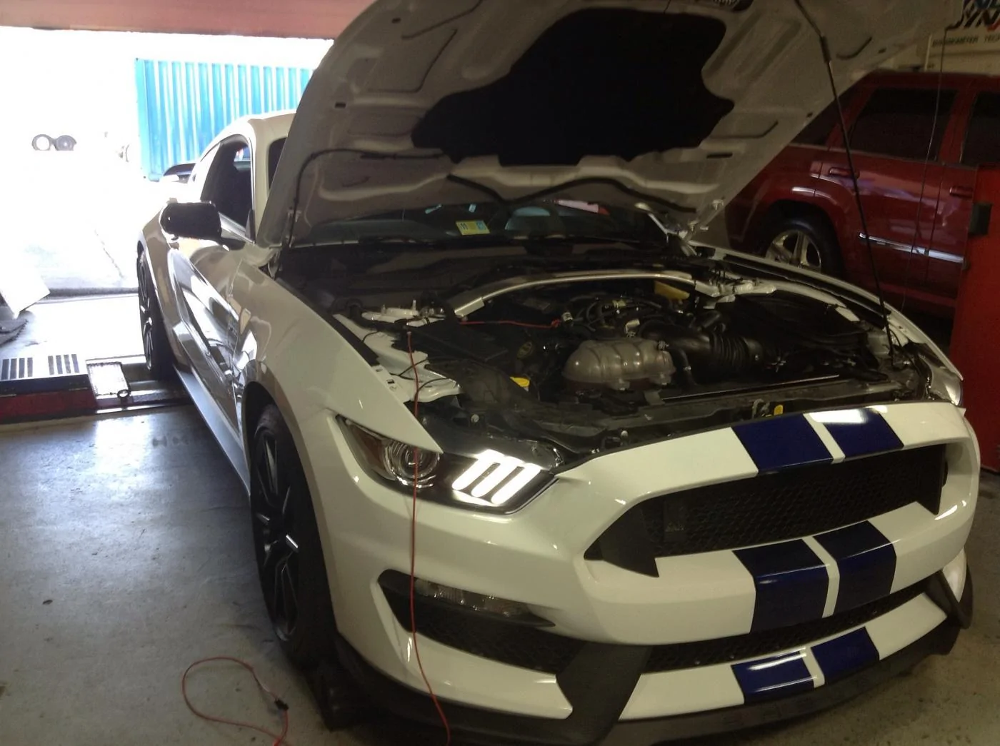

Installed a JLT CAI today and tune by DTP Racing
UPDATE FROM JLT PERFORMANCE:

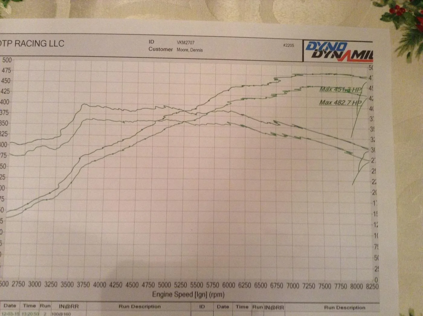

First we made some baseline pulls on the car, completely stock no tune. That's the 451whp run which was the best of the baseline pulls.
Then we had Brent from DTP Tune the car on the stock airbox, best run on that was 464.5 with the tune.

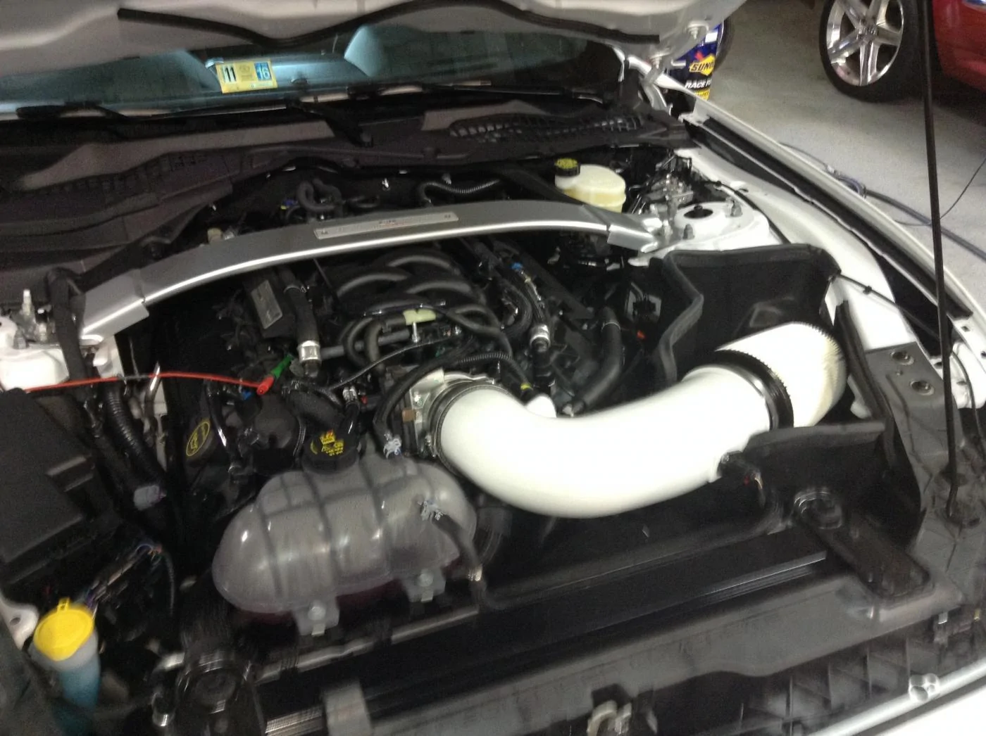

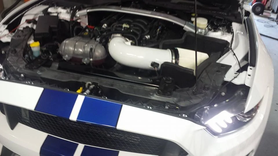

Then we installed the intake system and tuned the vehicle from there. Best run was the 484 and was backed up with the 482.7 run pictured in the graph attached.
Tune only numbers we're right in line with what Lund racing posted in their car. There isn't a ton left in these car's from Ford, the stock tune is pretty aggressive already.
On Sunday we're going to try to get a cleaner RPM pickup so the graph is not as ugly, we'll also get some pictures of the inside of the stock tube to show some difference with what we've improved on.

Wow! Picked up 31whp with tune and intake?!
Intake is massive!

Sorry the pics are not the greatest, was using my Ipad, the CAI looks great in person

We did a base line pull, a tune pull, and a tune & CAI pull. The tune alone picked up 13HP

The tube is larger and allows more air flow, the tune allows the motor to utilize the additional air
