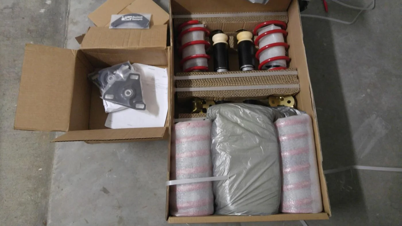

My Roush Single adjustment coilovers arrived today. Installing them and MM caster/camber plates tomorrow. I'll be glad to share some feedback.

If i can stop looking at them in the box I'll get'm installed and post some thoughts on the ride. :thumbsup:
