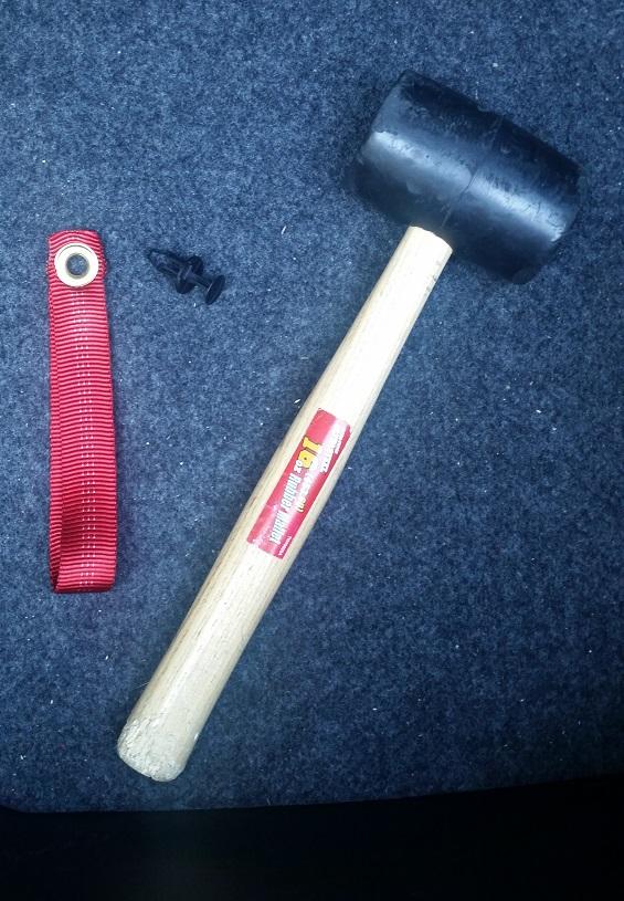

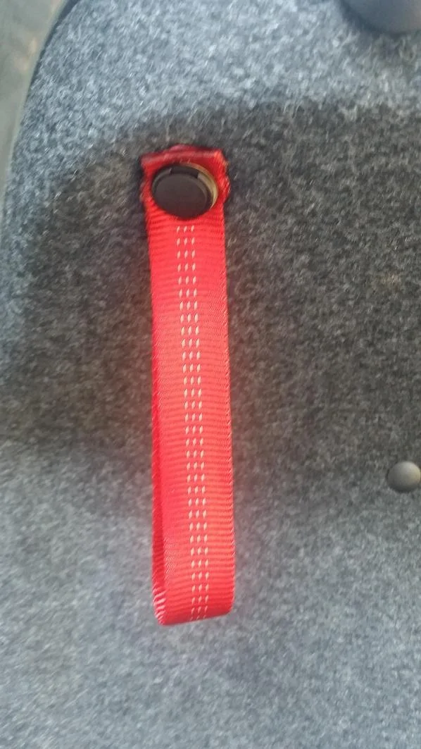

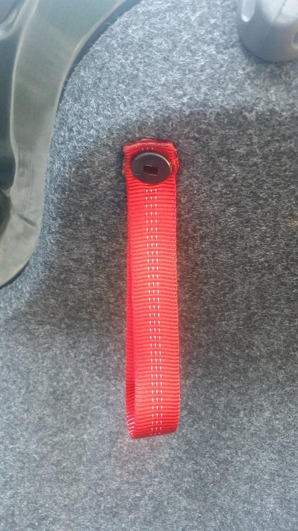

Hands-Free Trunk Kit Installation Instructions:
Tools Required:
1 x Nylon Loop (included in kit)
1 x Fastener (included in kit)
1 x Rubber Mallet
1 x hand (left or right, your preference)
1 x 2015 Mustang
Installation:

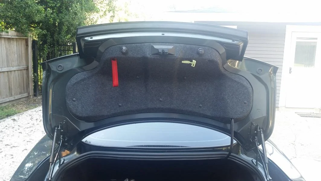

Step 1. Open your trunk.
If you didn't know (don't feel bad, I didn't), there's a small rubber button directly above your license plate, facing downwards. With your keys in the pocket, press that button. Presto! Trunk open. 1 step closer to hands-free Mustang operation.

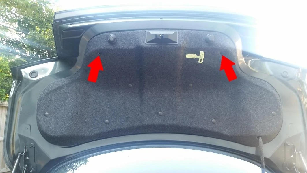

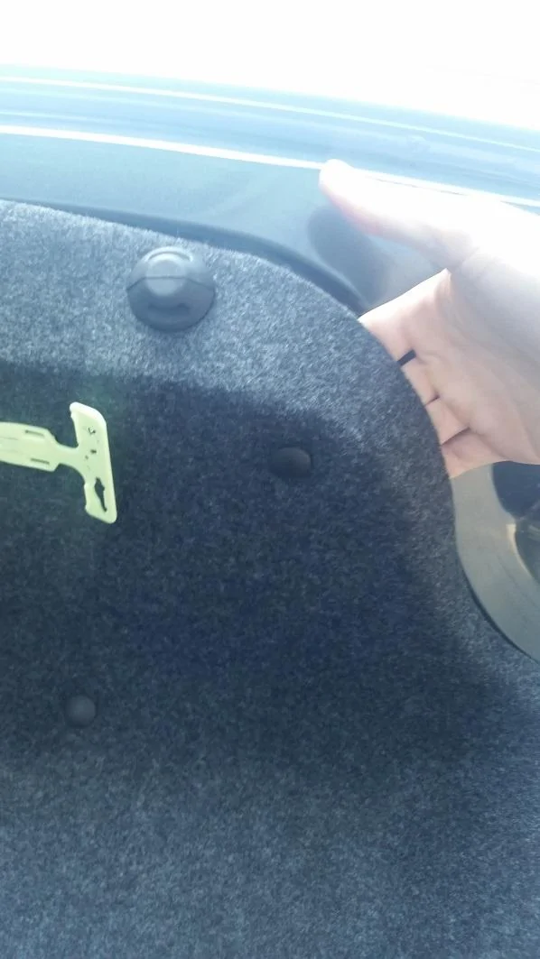

Step 2. Choose your location.
All the small, black plastic rivets holding the trunk liner in are the same. Personally, I would choose the upper left or upper right plastic rivet for greatest trunk-closing leverage. We're going to replace this rivet with the fastener included in the kit.

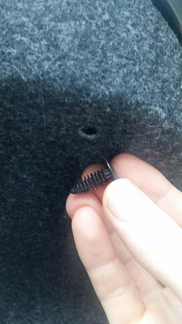

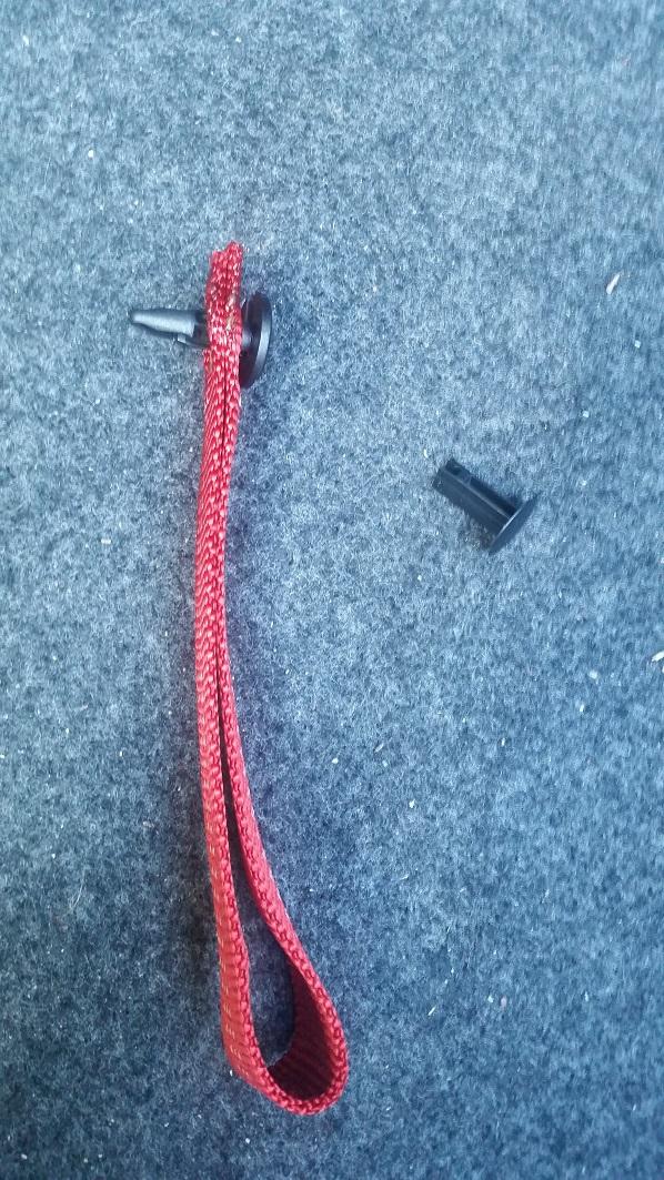

Step 3. Remove plastic rivet.
Slide your hand underneath the liner, with a finger on either side of the rivet and pull. They're not very strong. Promise you won't hurt anything. Put that one in your spare parts bin, it's no longer needed.

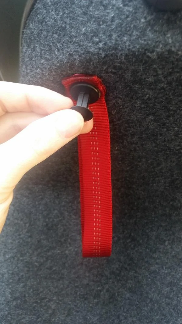

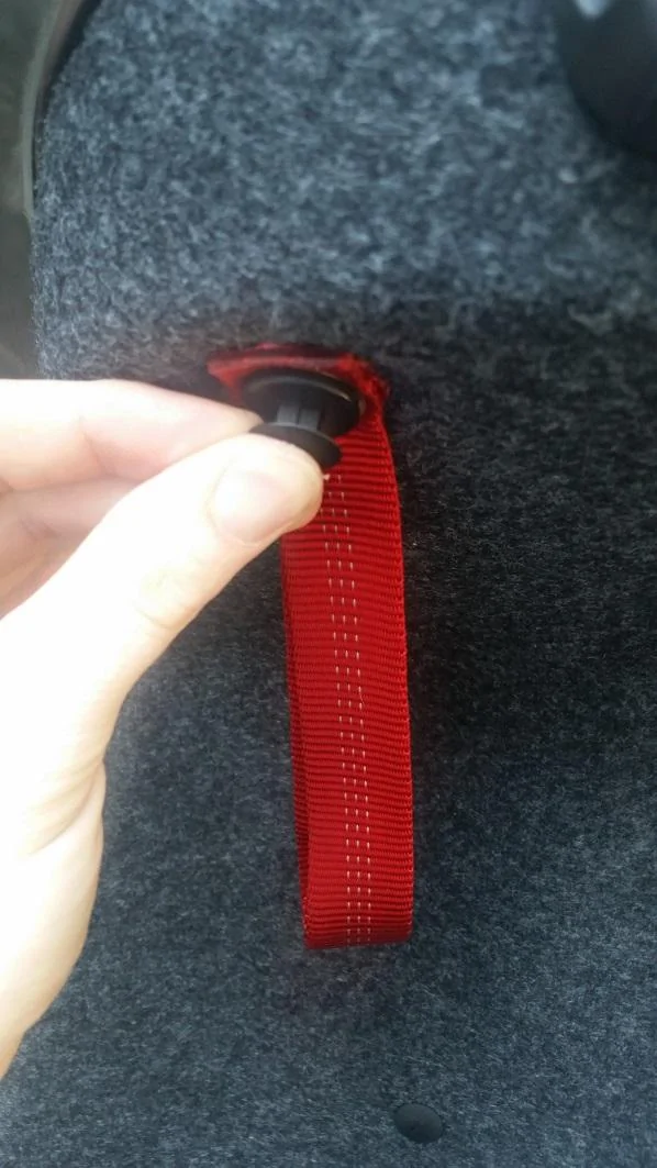

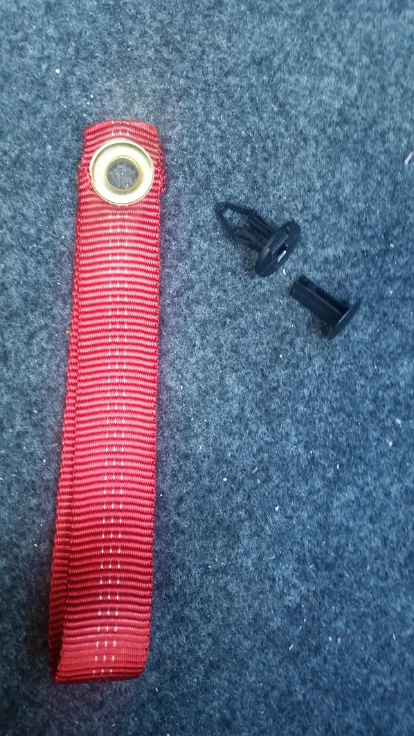

Step 4. Install the lower half of the new fastener.
The fastener is two parts. Shove the lower (collapsible) portion through the brass grommet in the strap. Then install where you removed the oem plastic rivet.
Step 5. Secure pull loop with the upper half of the new fastener.
Insert the upper half into the lower half. It will go most of the way in with just "thumb pressure".
Step 6. Break out the big guns!
Not really. But one swift, accurate wack of the rubber mallet will seat the upper half into the lower half. This fastener is oversized for the hole, so it is tight on purpose. If you ever need to uninstall, a flat head screwdriver will easily dislodge the upper half.
Step 7. Try out your new fingerprint-free strap!
And reward yourself with a beer. :cheers:

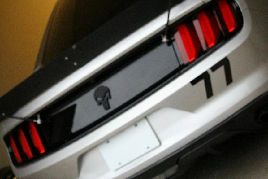

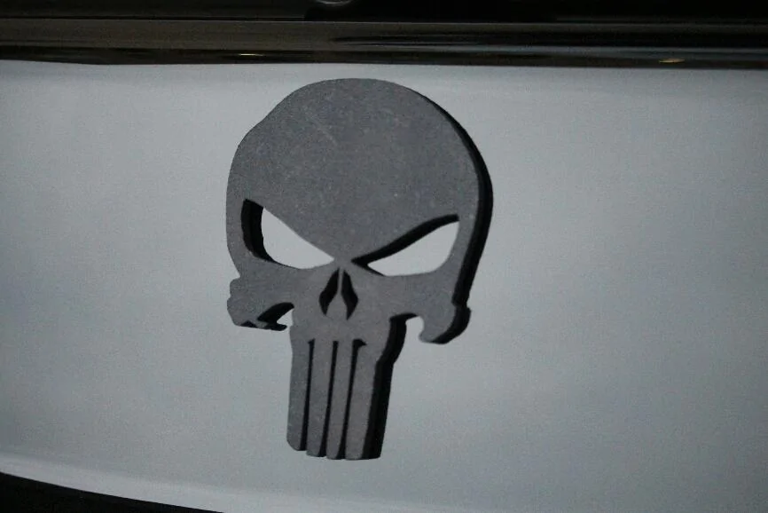

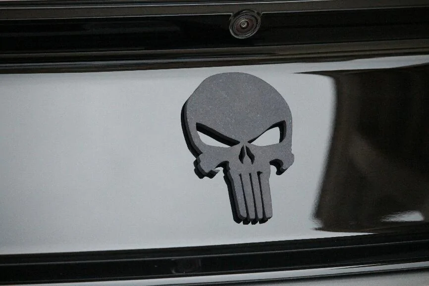

Punisher decklid badge is ready!
Thanks to [MENTION=14791]Cheezebandit[/MENTION] for playing guinea pig with the prototype. His car looks amazingly mean!
:cool: :headbang: :eyebulge:
Ready for order here: https://www.shapeways.com/shops/spacecityspy

Installed the Hands Free Trunk Close Kit today. Works GREAT! Highly recommended mod for everyone to do. Easy and simple!
Thanks OySmallFry!

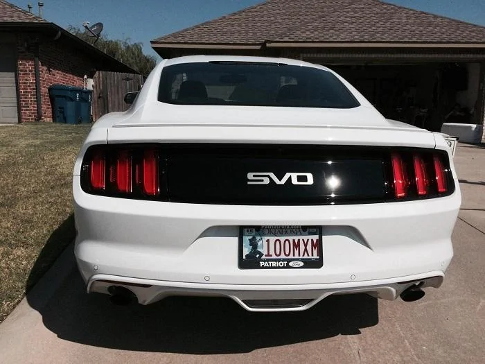

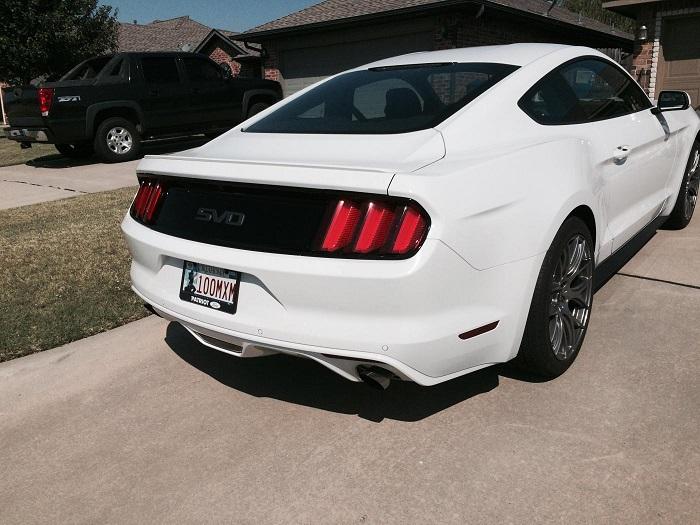

And now, a few photos of the prototype SVO ecoboost badge! It's looking absolutely killer on [MENTION=17656]higdominator[/MENTION]'s ride! (from thread http://www.mustang6g.com/forums/show...hlight=SVOmage)
FYI, higdominator did some pretty in-depth polishing and painting on this one, so don't think it will arrive quite this on point. These are 3D printed by our friends at Shapeways. You can choose your final color, material, and finish on the SCS Shapeways site.
From feedback, it's been shortened a little. For official, final dimensions, check the SCS Shapeways site: SCS Shapeways

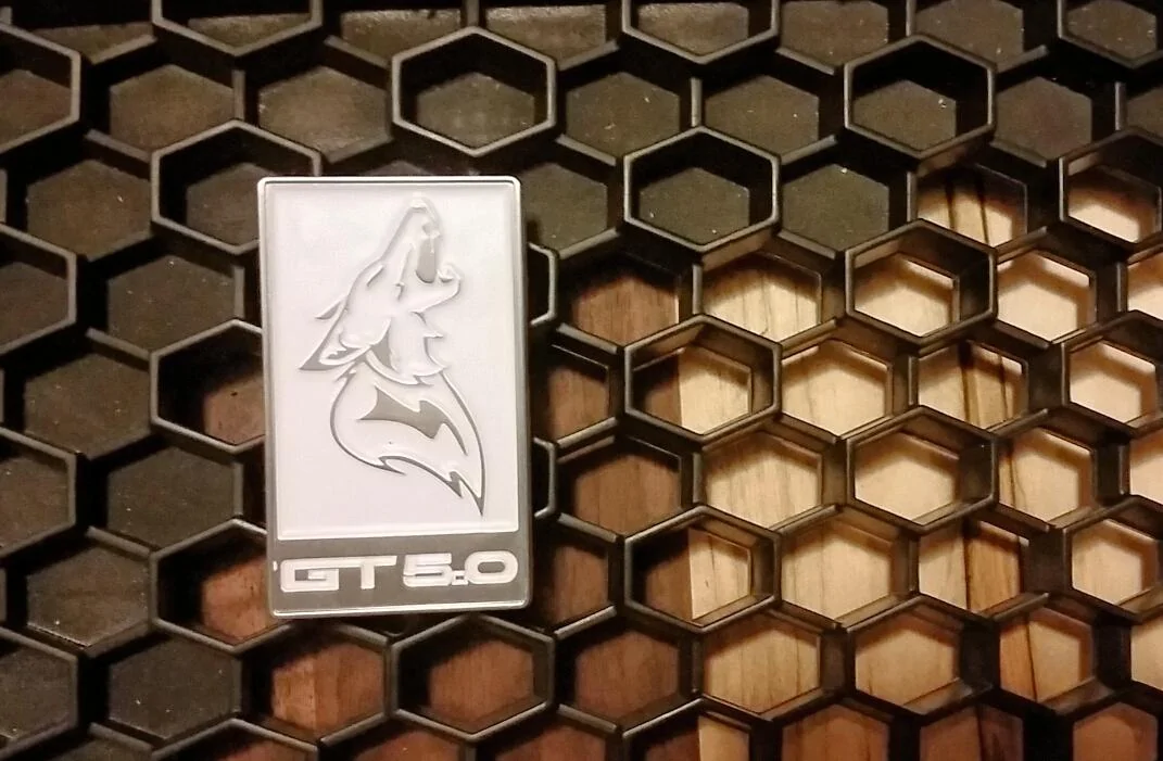

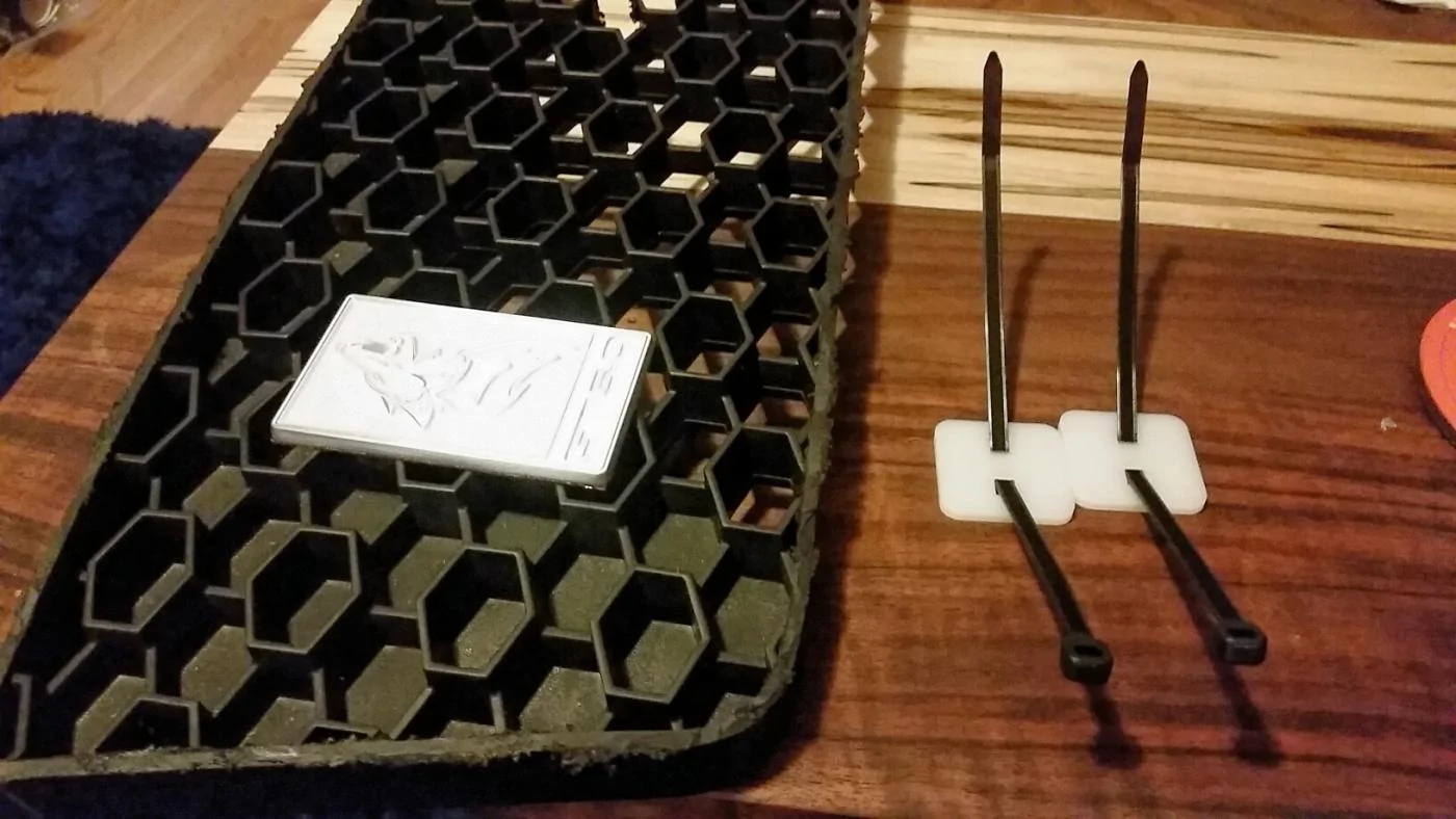

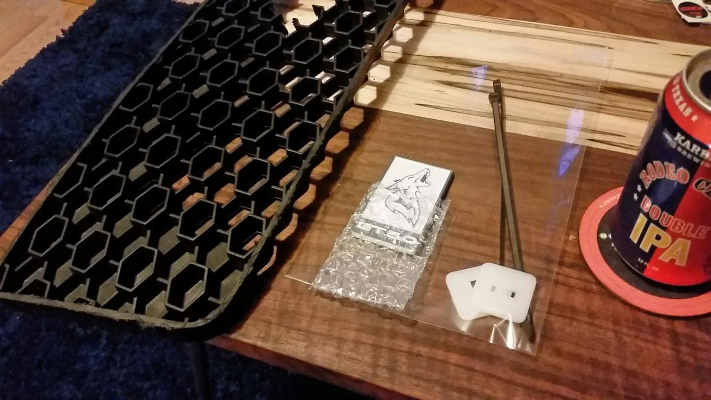

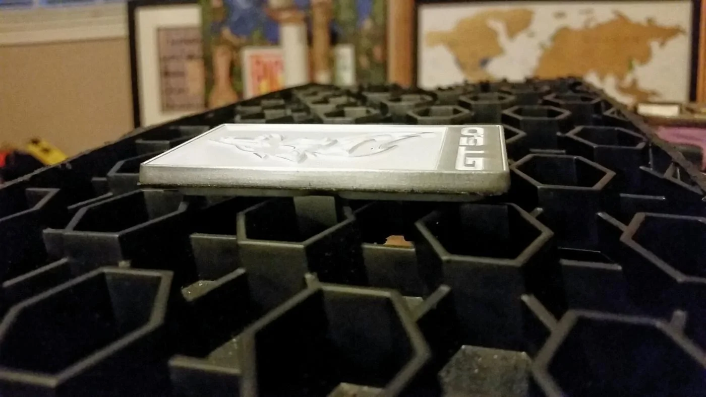

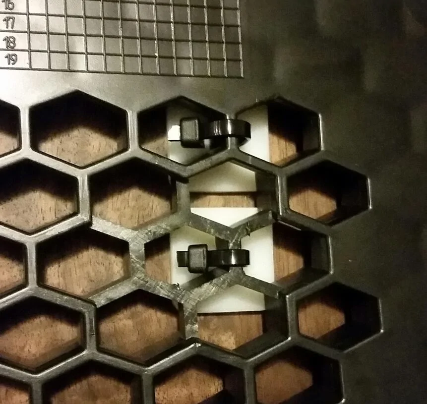

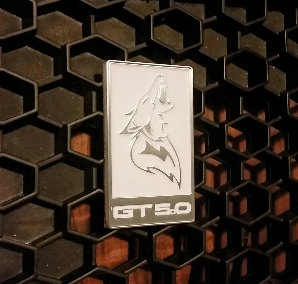

Front Grille Badge Mounting w/ Mount Kit
Maybe this is self explanatory for most, but I figured I'd throw up this quick guide if there are questions.
**This can be done without removing your grille / bumper cover. 10 minute install.**
Step 1. Gather your supplies.
(Please excuse my shredded R&D mule of a grille)
Step 2. Choose your mounting location. Make sure it looks good. Stock GT350 location is far left side.

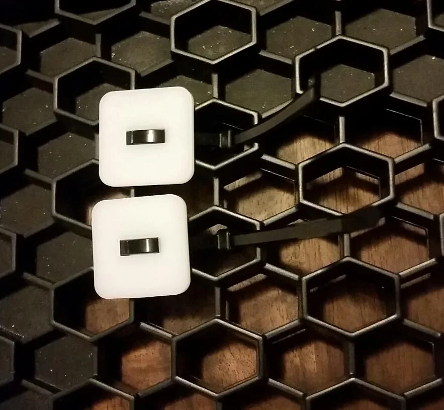

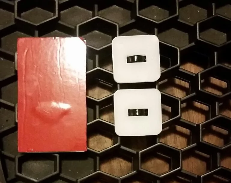

Step 3. Thread your cable ties through your mounting plates. Each plate is 1" across, so 2 will take up the majority of the size of the badge.
Step 4. Thread the end of the cable ties through the grille mesh and hand tighten. At this point some vice grips will really help to tighten the cable ties down. Don't worry if the plates are not perfectly square, you've got wiggle room so the badge will still be straight.
Step 5. Clip the ends. Good scissors are required. These are thick cable ties.
Step 6. Pull off the red adhesive cover from the backside of the badge.
Step 7. Line up and apply! Press firmly. Done.
Step 8. I dare you to try to rip it off now ;) 3M adhesive is no joke! (I tried.. but really, don't do it.)
