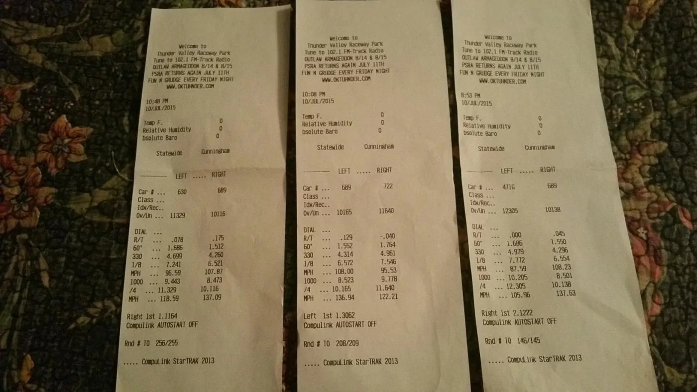

I'm new to this sight. My first post. Got everything finally sorted out on the new Mustang Auto and most of the supporting mods done. Took it to the track and got some pretty good results. Here's a list of the mods and a look at the time slips.
Procharger Stage 2 with F1A
BBK 1-7/8" headers no cats
Magnaflow race cat back
95lb injectors
DSS 1400 axles and 1000 hp driveshaft
Custom tune
3200-3600 Circle D converter

Wow! Our slips are very comparable.
How do you like the converter? I still have the stocker.
Do you have any power/ET results with the LT's? I also have the stock headers, and was considering upgrading.
Good job!

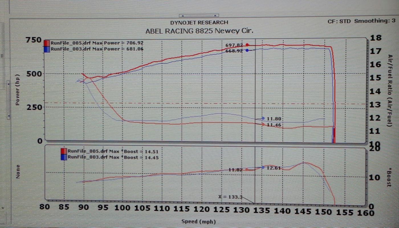

The converter is great for performance but, it's not so fun driving around town. It makes the car drone with the stock exhaust. We just did the full exhaust and it's horrible. The results were pretty good for the full exhaust. Here's a pic of the graph before and after. Thanks, Tim

Wow! So you gained roughly 30 whp from the exhaust, nice!
Thanks for sharing. I am still torn on whether or not to do the LT and Converter - I just don't think the $3000 price tag will do much for my combo, but I could be wrong.

It was running 10.50's @ 133 before the exhaust. So it dropped 4 tenths and gained 4 mph in the 1/4 mile. The smaller pulley should be here mid week. I don't have a cage and the track techs are already all over me. They will let me run to 10.0. I will probably get to make 1 or 2 nine second passes before they get me.
