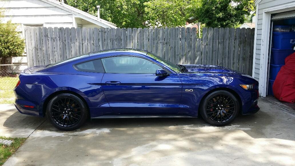

I just dropped my 15 GT PP at the shop today for a wing install and you guessed it: a Roush Hood scoop. arggggghhhhh!!!!!! Inever thought about the heat factor.... I actually bought my scoop off ebay ( new) but for a great price... now I am wondering if I should call my body guy and delay the install...:headbonk::headbonk::headbonk::headbonk:....
WOW - this car pops! Love it. I wouldn't even bother adding any visual mods to this beauty.
