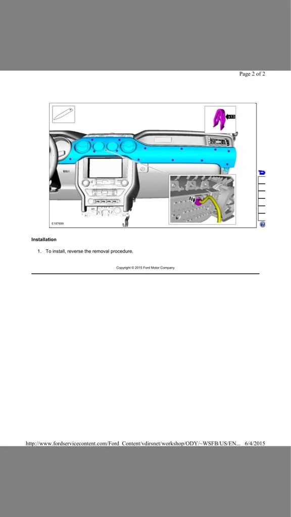

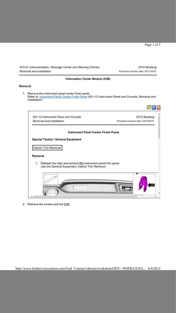

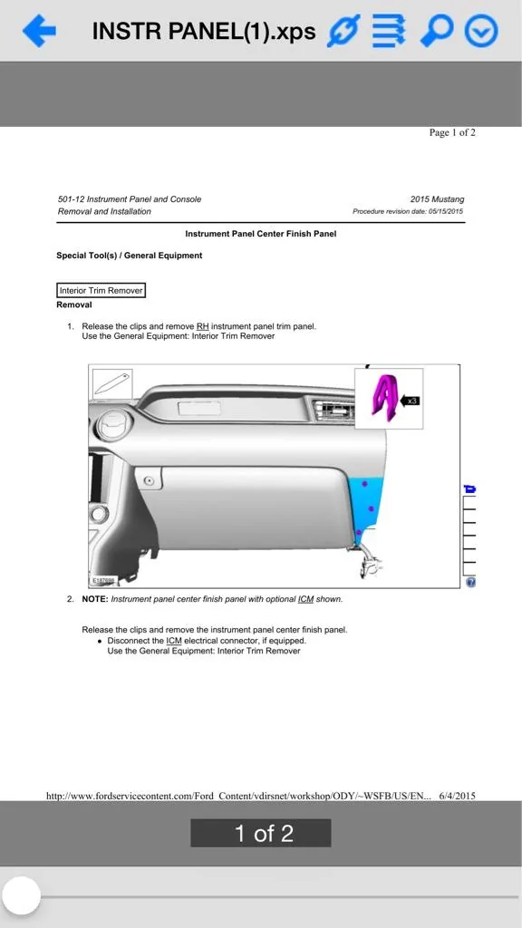

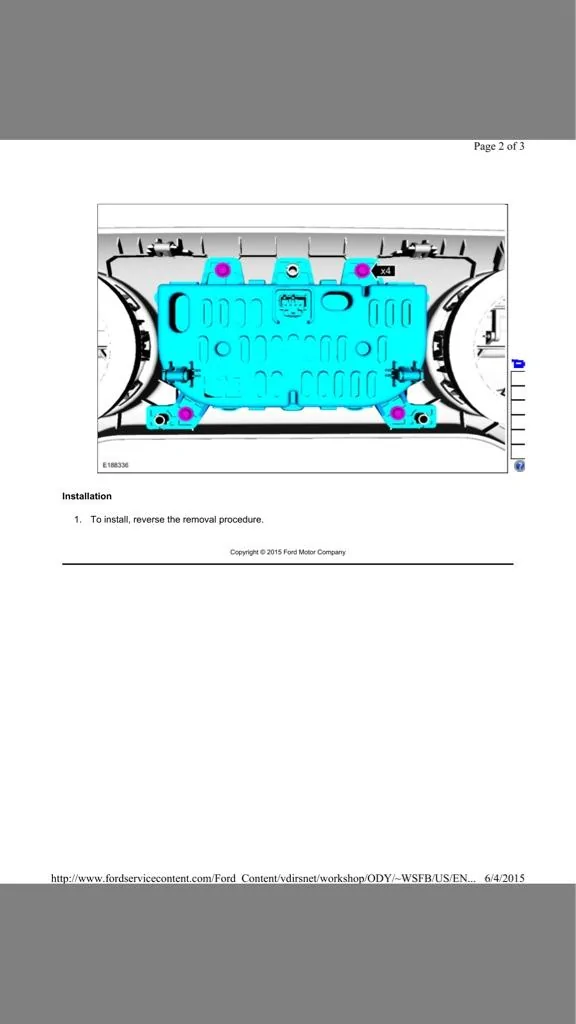

Well, I took another leap of faith (you may remember I bought take off optional 20's and proved they fit the PP) and purchased the OEM boost/vacuum gauge from an Ecoboost and installed it in my PP Whippled GT tonight. Well, IT WORKS!!! It was a simple plug and play thing and not only does it work, it seems to be balls on accurate as well based on what my dyno pulls said my boost levels were.
Not much else to say so here is a video of me testing it in neutral before I buttoned everything up and very shaky video my wife and I just shot on our way out to dinner.
