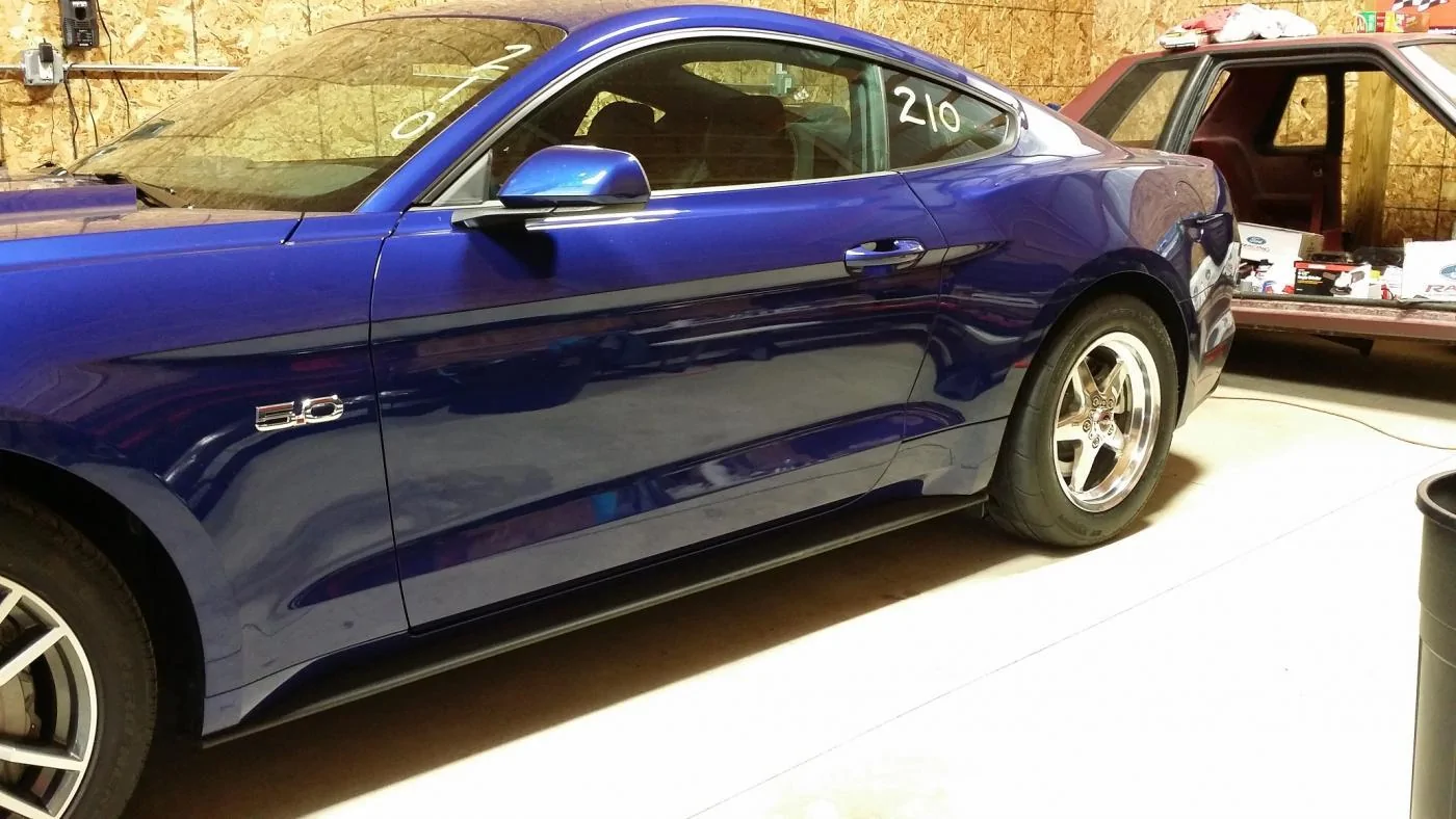

Just installed Race Star 9.5 x 17 from Team Beef Cake with M/T drs working on fronts now:cheers:

you plan on daily driving with this set up? just wondering ive thought about buying a nice drag radial set up but mines a dd. Side pic please :)

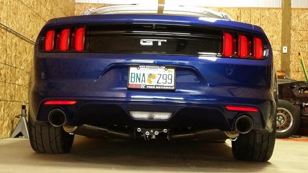

your drag radials are facing the wrong direction...
Good eye, I have set up to mount them in my garage but not to balance. I stuck them on just to check for any fitment issues out to get balanced today hopefully :cheers:

Not to good for DD wear out fast and bad in rain it`s not my DD. I`ll have better pics later taking for balancing today

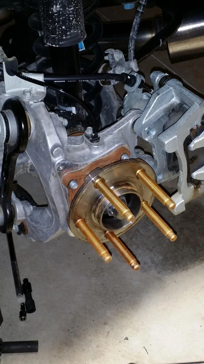

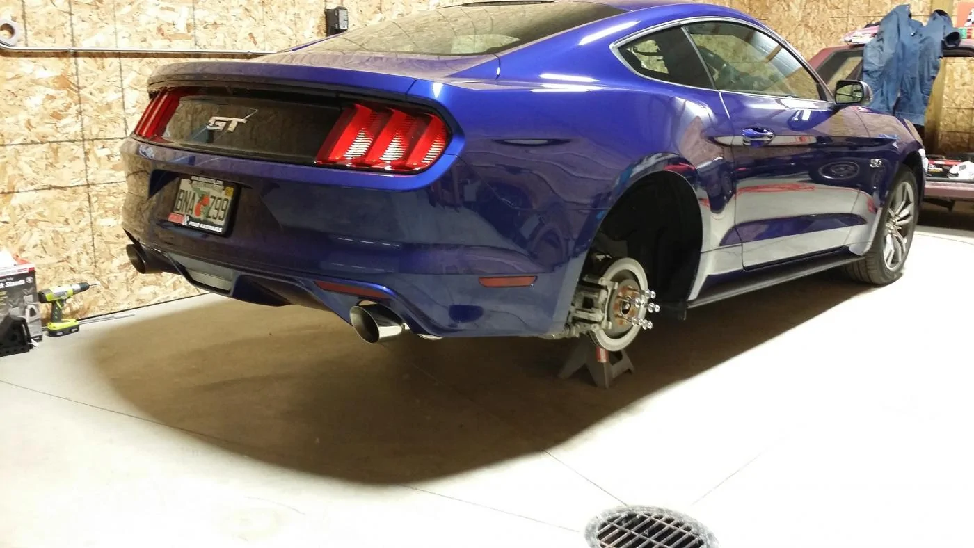

In a different thread you wrote you are putting longer wheel studs. Help a noob to know why.

With aftermarket wheels at the drag strip NHRA rules the studs need to be seen out of open end lug nuts. Most tracks do not enforce this safety rule but at large events they may not let you race. I have had that happen in the past, I will be at the NMRA event this weekend for three days in Ohio and do not want to take the chance of not racing. Plus more power is going to be added in the future :)

Thanks, man. Very cool. Are those ARP Racing 3" Mustang Wheel Studs?
