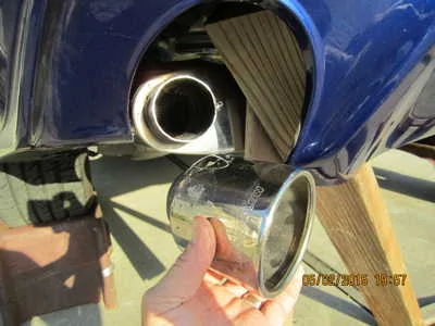

The 1st pic is me cutting them off when I decide to get serious about cutting my mufflers off, sliding them forward and trying different types of tips.

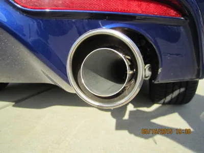

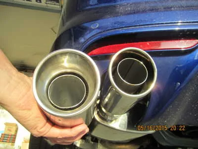

The 2nd & 3rd pics show the 2 1/4" x 10" long pipe extending thru the resonator tip to the outside bottom edge.

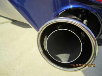

The 4th pic, I am holding another test resonator tip that I like the looks of better than the 3 1/2" dia. Spectre 22354's that are mounted. I only have one of the one I'm holding (3 3/4" dia. DC Sports EX-1010S). And the one I am holding is shown with a piece of my 2.25" pipe inserted in it.
