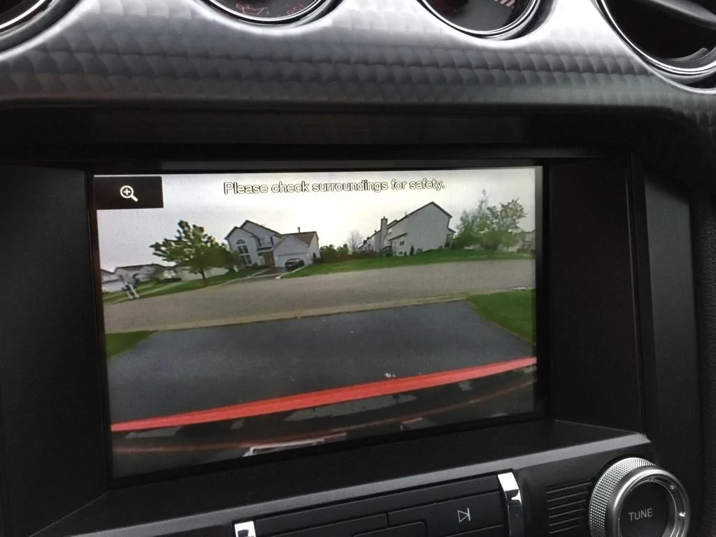

For some reason parking aid lines disappeared from the rear-view camera. I did read the manual, and it says that after the battery disconnection they may disappear and will appear after the car will go faster than 12mls/hr. I did drive probably 30 miles today after I picked up the car but the lines did never came back. Does anybody knows what the issue could be?
Note: Upon a battery disconnect, the active
guidelines may not be functional until your
vehicle has been driven a short distance and
exceeds a speed of 12 mph (20 km/h).

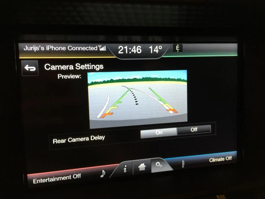

By the way - I don't even have an option in the menu about active guidelines. I have only option for the camera delay.
Zoom button on the screen beeps when pressed but doing nothing. I did try to reset to the factory settings. Didn't help.

Thanks for the reply but:
