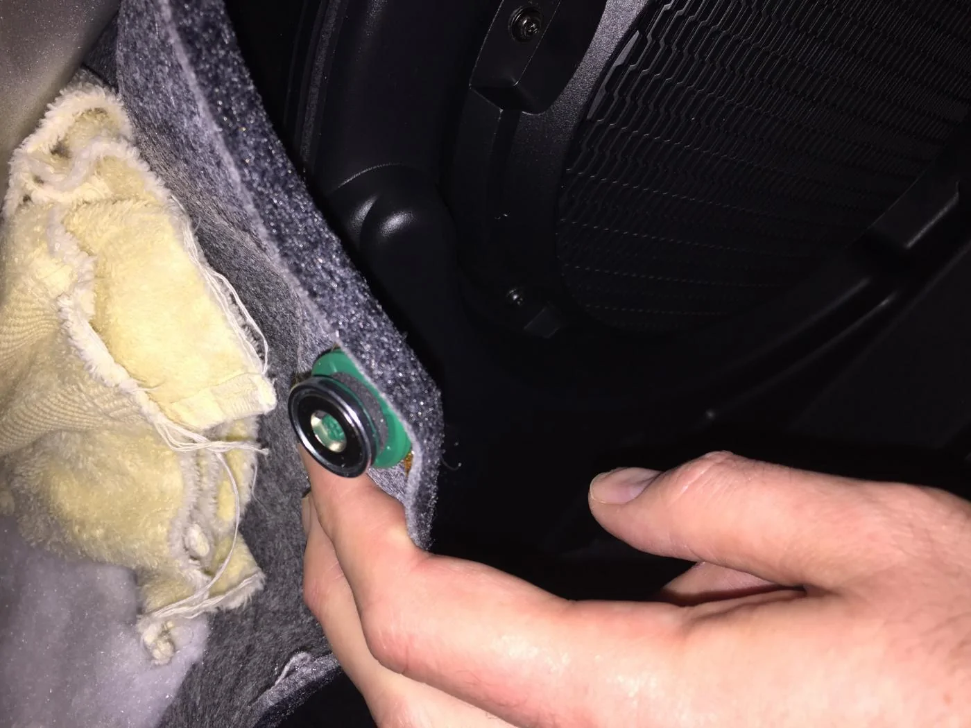

I fixed the BSR (Buzz, Squeak, Rattle) issue on my car this afternoon. I'm not sure if this will apply to everybody who has a similar issue, but it might be worth a try.
I found that on my car the noise was coming from the trim inside the trunk just above the subwoofer. (My sub wasn't loose at all upon investigation.) This trim is held on by magnets and super easy to pull down. I wedged a towel as far back into the space as I could to absorb the vibration. (Sorry, but the picture self orients to landscape, but I took it in portrait.)
So far it sounds perfect. (Well, as good as the shaker pro can sound...) I hope this helps!!!
