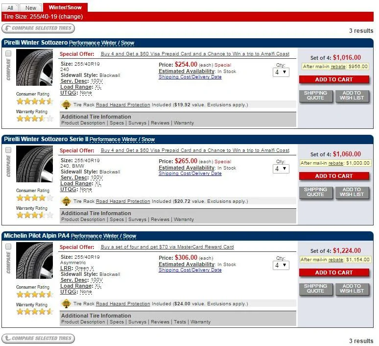

Performance Package Winter Tire Shopping is going to be a NIGHTMARE!

You can do a lot better if you expand your size range a touch. Tirerack has Dunlop Winter Maxx 245/45R19 tires, which will fit fine, for $169 / each.
JimmyTwoTimes
Jun 23, 2014
50
3,287
385
New York
2015 GT Premium
Wait, I didn't even see; you have the Ecoboost PP, not the GT PP. That can take 18" wheels no problem (same brakes as the non-PP GT). I had 18" Michelin X-Ice Xi3's mounted and balanced on Sport Edition A8 wheels shipped to New York for $1,400 / set, and I could have gone cheaper if I wasn't getting the top-of-the-line winter tire.

Here is my winter setup. 225/55-18 Dunlap Winter Maxx. Cost somewhat over $900 for the tires and wheels.

Look at what Jimmy and dgc333 posted. Since you have the EB PP, you can fit 18" wheels and tires. There is a large selection at good prices. Also, keep in mind that you don't have to get exactly the same size as stock. When you're looking at tire rack, click on a tire you're interested in and then look at "Specs". You can see overall tire diameter. Stock on your car is 27.1". Find something equal to that or slightly larger (for winter, more ground clearance is better), up to say 27.5" or so, so that the error for your speedometer will be within a very small amount.
The ones dgc333 posted are 27.8" diameter, so you'd be off 2.7%. At 60 mph, your speedo would only show ~58 mph.
