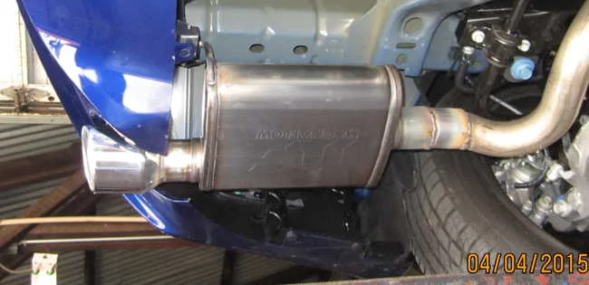

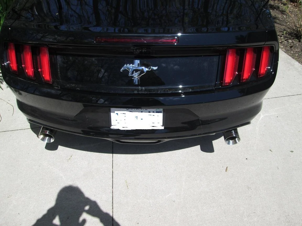

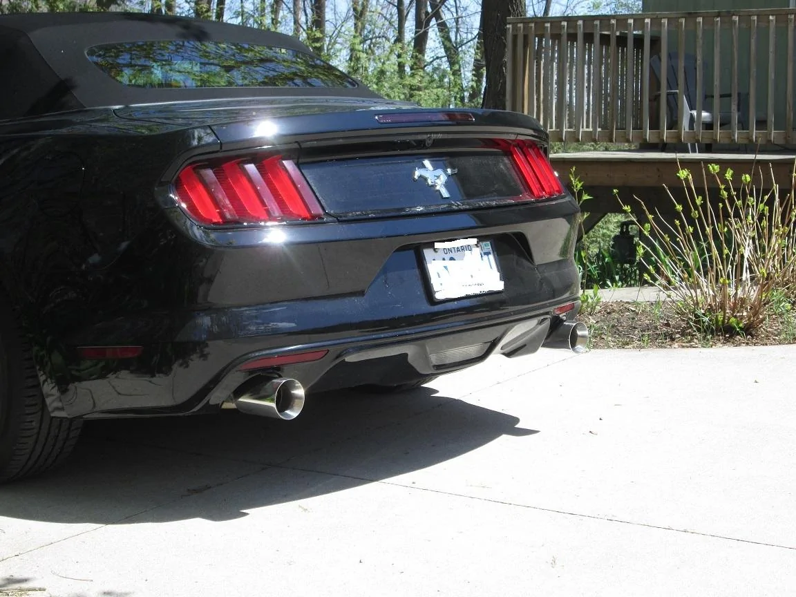

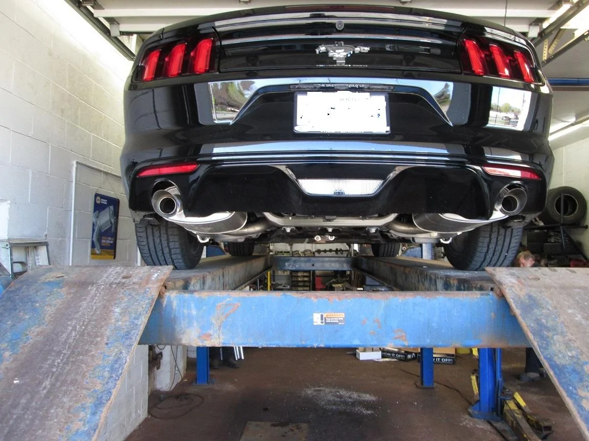

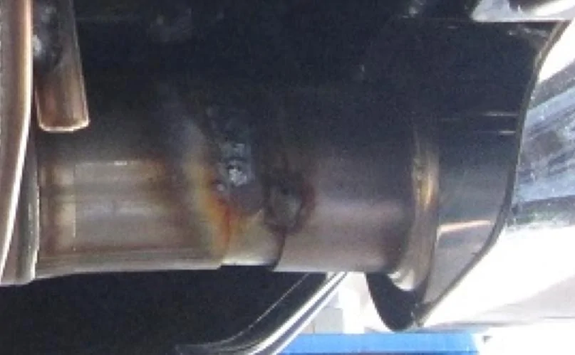

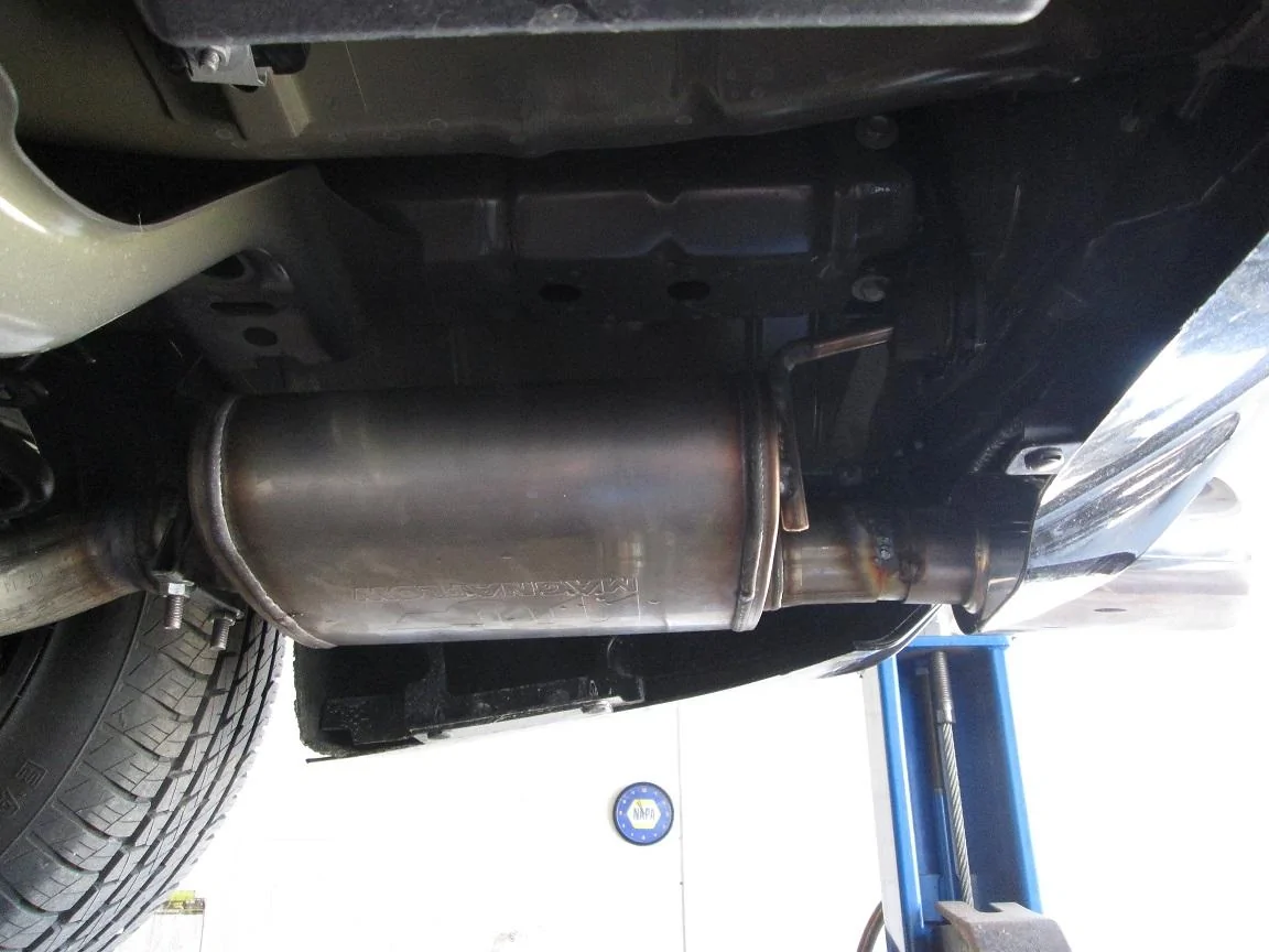

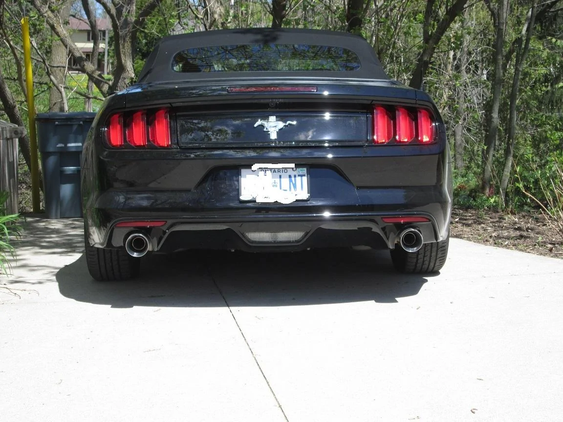

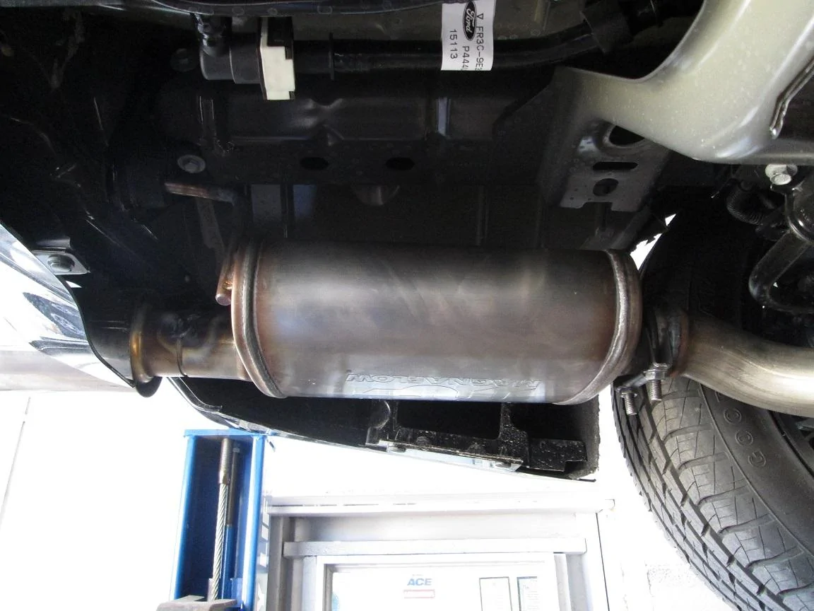

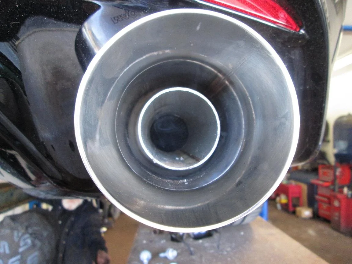

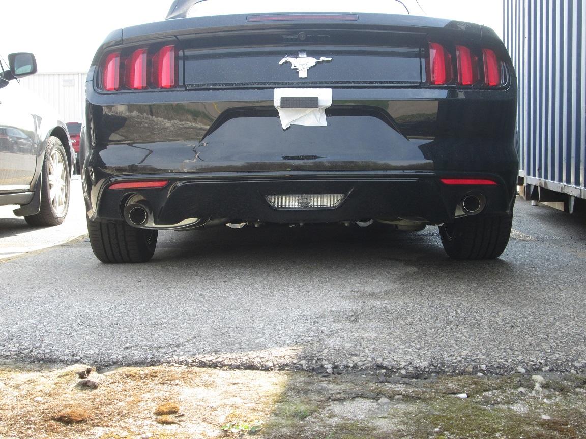

OK Dave, the magnaflows are installed. As per the first pic taken at the dealer one can see how messed up the pipes were. This caused much difficulty installing the Magnaflows as the pipes attached to the resonator to the muffler where not symmetrical in the least. However, the shop got them on.

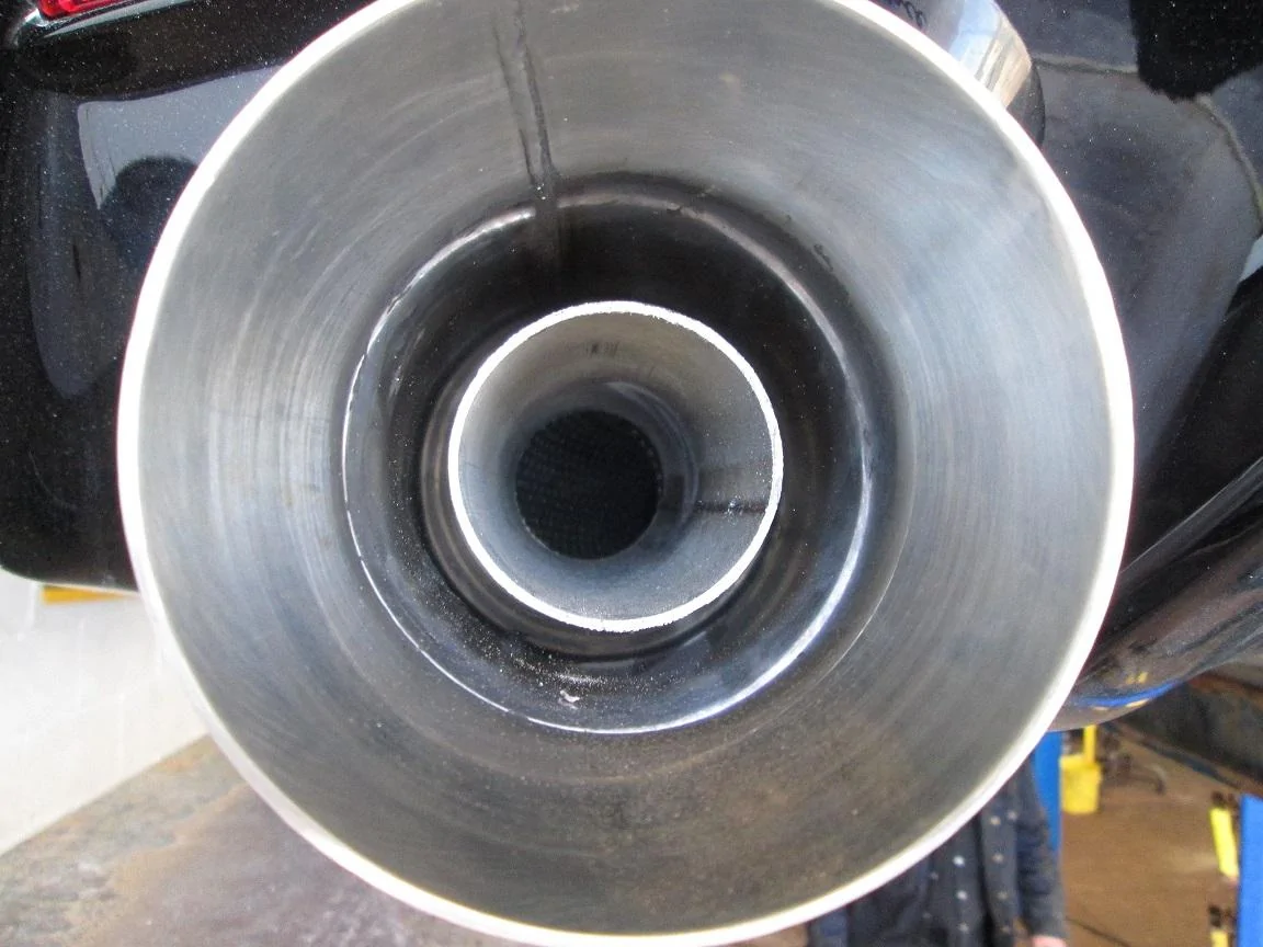

Pipe details: the engine side of the muffler was cut off about 1 1/2 inch. A smaller pipe extending thru the tip was then slid into the stock pipe (from the resonator). It was clamped. I think they had the resonator on and off the car 3 times attempting to equalize the flawed pipes. So far that was/is the only problem with the car. Everything else is flawless.
The pipe that was slid thru the tip terminated 3.15 inches (8 cm) from the street side of the tip end. It then went back thru the entire tip and into the street side of the muffler where it was welded.
Results: Fantastic. Very deep, deep, sound. Zero rasp. Loud? Nothing as loud as your vid. Drone? It's louder at highway speed than stock, but not intrusive. My sedate sister thought it was great; radio/conversation no issue.
I'm very pleased. Thanks for leading the charge. The Dynomat is certainly on the back burner. I'll do it when I feel the need to burn some money. But right now I'm going to order a set of Steeda springs.
Here comes some pics.

A few questions to see which differences between yours and mine that I can try to duplicate.
The two main differences is see are:
1) You used even smaller diameter pipe inserted into the 2 1/4" tailpipe (from resonator.) That joint like mine is right at the bend and the pipe is 'not' round, so getting the next sized pipe (2") to slide inside even an inch might not fit. I wonder if he might have used 1 3/4" pipe even??
a) do you know the o.d. and aproximate length of the inserted sleeve pipe used to connect the muffler to the tail pipe? So how far into the muffler and into the bend of the tailpipe?
b) Do you know the o.d. of the pipe and how far 'into' the muffler it was inserted? (all the way up to the bend inside muffler or just some way into the muffler's outlet connector pipe.
2) Your tips protrude much further than mine. Measuring from the to center of the tip to the 'outside' edge of the cutout lip, mine dimension is 1 3/4". What is yours?
Your inlet and outlets to the (2 1/2") muffler core were reduced from 2 1/4" down to 2" (or maybe even 1 3/4"?). My 11366 inlet is 2.5", as is the extension/connector on the front. My outlet that the tip is connected to is also 2 1/2". With 1 1/2" cut off the inlet side of your muffler and the longer connector I have there, my muffler is probably 2 1/2" further back than yours.
When I know the size of your 'insert' pipe connectors, I'll look to duplicate that on mine and move them further forward.
What tips are those? You went with something different than the MF 35126's that Russian and I (initially) used.
Blaster
Mar 4, 2015
171
30
Ontario,Canada
Black V6 Vert, manual, 051A, 3:55, no spoiler
Blaster,
Congratulations on your good sounding exhaust!!!!! :cheers:
Will you be able to do an interior and exterior sound clip for us soon? :D
That would be a job for my son. I have no clue as how to do that. :eyebulge:
Don't know exactly on the OD. The entire exhaust including the resonator was removed from the car because it had an errant bend from the factory. See first pic above. They had to fit and remove the entire section 3 times before they got it straightened out. They were getting frustrated as it was an awkward two man job. I gave them space. I know they cut about an inch or so off the muffler inlet and did some flaring. As for the exact pipe they used to connect the muffler to tail pipe I do not know, but it was heavier gauge and a tight fit.
Just enough into the outlet/inlet to secure it I would assume.
4 1/4 inches more or less. Difficult measurement to be super precise.
The "shop" pipe inserted thru the tip into the muffler and welded was 2 1/4 OD and 2 1/8 ID. That I know and measured. The "shop" pipe between the muffler and the pipe from the resonator I did not measure but PIC enclosed.
Those are 35126. Right off the box. Dave, the biggest difference between our setups is that my tips are out much further than yours and I have that 2/ 1/4 inch heavy gauge pipe running thru until 3 1/8 inch from the street side.

But this part is really hard to make sense of:
"The "shop" pipe inserted thru the tip into the muffler and welded was 2 1/4 OD and 2 1/8 ID. That I know and measured. ...."
because the outlet pipe on you muffler is 2 1/4" and the spec from MF on your 23126 tip's inlet is also 2 1/4". Yet in your picture the connecting pipe fits inside both of those. And looks to do so maybe even with a loose fit? Weird.

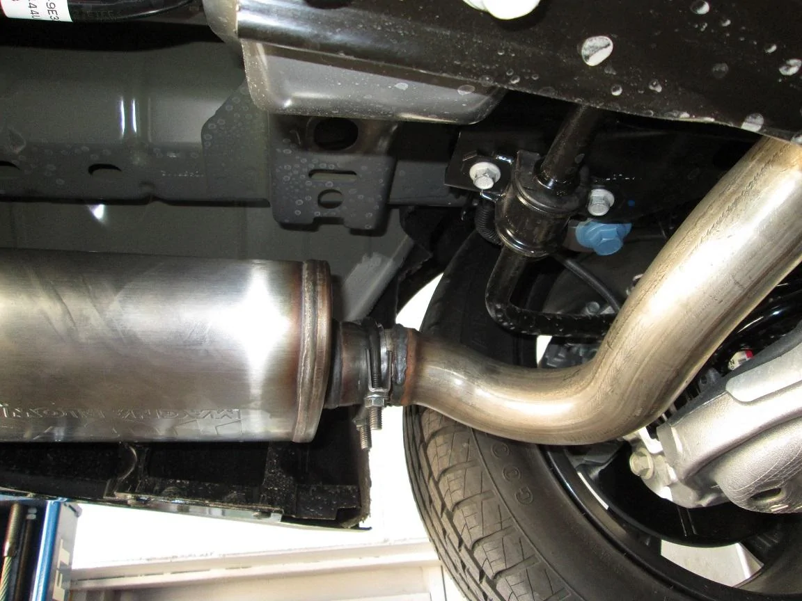

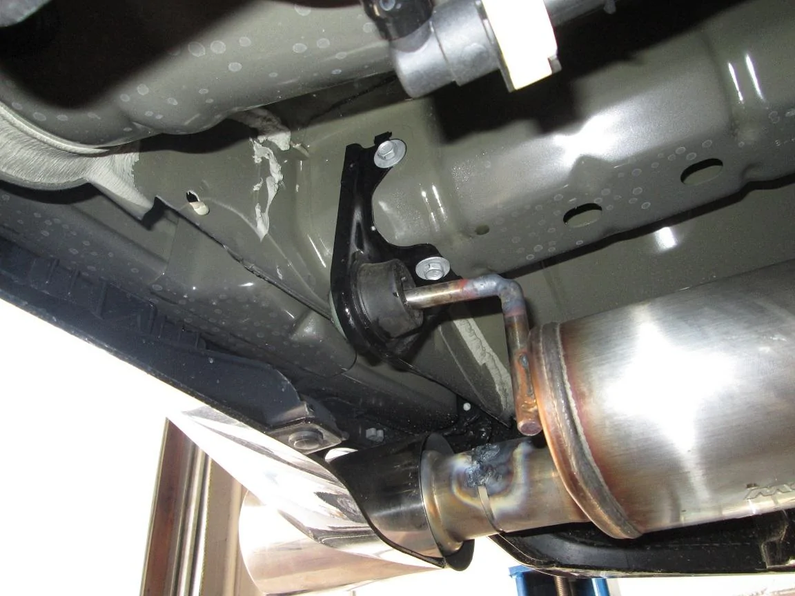

First picture below is shows my MF 35136 tip installed, with the top of the 15º angled tip being maybe about 1 1/2" from the outside of the cut out. (vs. yours at about 4 1/4").
Second pic is AJfrench's (same tip and muffler as yours), but his tip appears to be mounted in 1 1/2" or more in from yours comparing the back edge to the lower body piece. And Aj reports very mild if at all drone. Maybe the tip further out does lessen drone.
Third pic below is a blow up of your muffler to tip sleeve.

OK Dave, I'll grind this out best I can. :D
My initial intentions where to photo record the entire procedure in an organized fashion. But after it was discovered that Ford's screw up on the driver's side exhaust was no simple hanger adjustment and required the resonator on back to be taken off and re-installed 3 times, those plans went astray.
I'm attempting to describe the pipe that was supplied by the shop and inserted thru the Maganflow 35126 and into the muffler outlet. It was a tight fit in the tip and then they flared it in this machine so it would be fairly tight in the outlet. Then it was spot welded ... not to my exact liking either.
So the question might arise; why did I have this "pipe' inserted so far into the 35126? Well after fooling with it I thought the 35126 acted a bit like a megaphone so the inside pipe might nullify this a bit. I also thought that the further away the street side of the 35126 was the better chance for less drone. I also like to see these tips.
In summary, when travelling along at 60 mph in 5th or 6th, under a slight load, the exhaust sound in the interior with windows up , is slightly higher than stock. But that is only logical. The sound when you want it is very deep. This is one of those "shot in the dark" actions that met it's target as some of my experiments don't turn out as desired. :lol:
