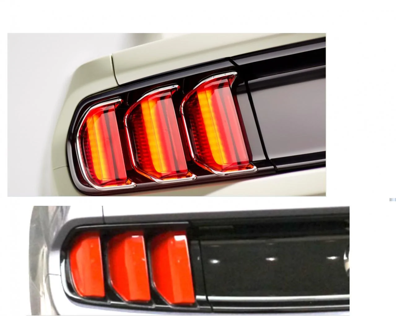

I've included a photo of my car before attempting the tail light / trunk lid alignment. Haven't taken a photo yet, after the adjustments. I've been somewhat successful, but it took quite a bit of pounding and whacking and adjusting of hinges and sheet-metal. The best it will ever look though (I'll show a photo when I'm done) will not be perfect, because the trunk lid is improperly designed, as is the Black Plastic on the Lid.
In addition, the quarter panels are incorrectly stamped in that area (poor die) as well as poor weld alignment.
Also showing the pre-production LE and the Design Team Clay Model, to show what it was meant to look like.
Also a photo of my car at work, before starting. From a distance, you can't see any problems. It's only when you get up close or know where to look, you see the problems.
