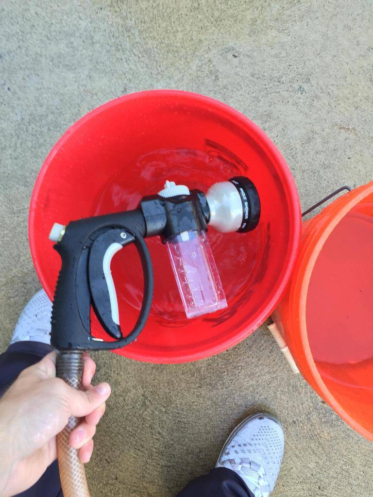

(2): Buckets, and Hose Attachment of your choice!

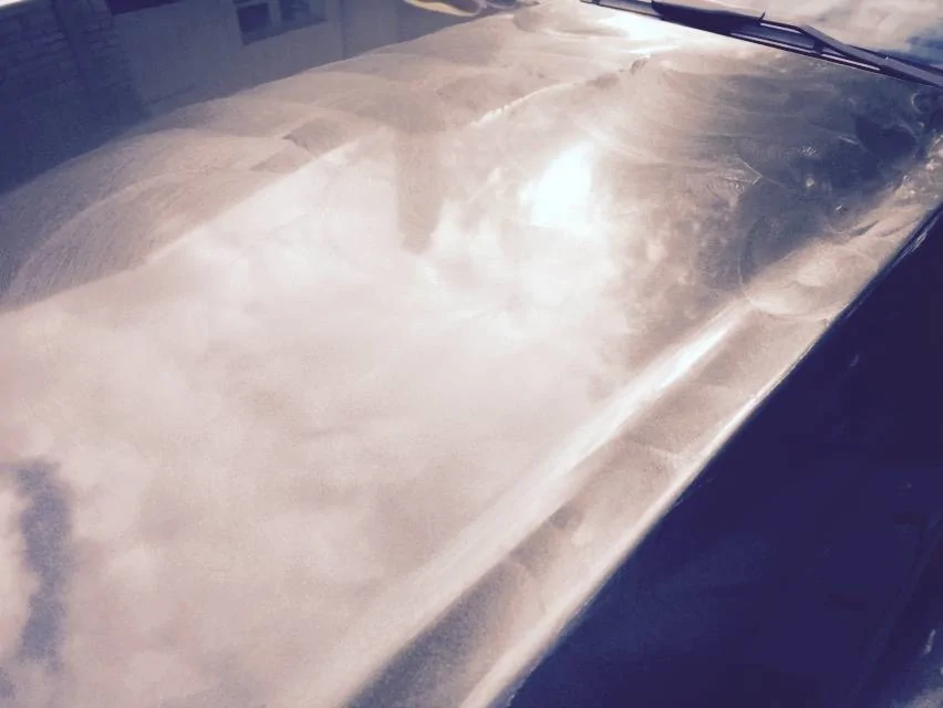

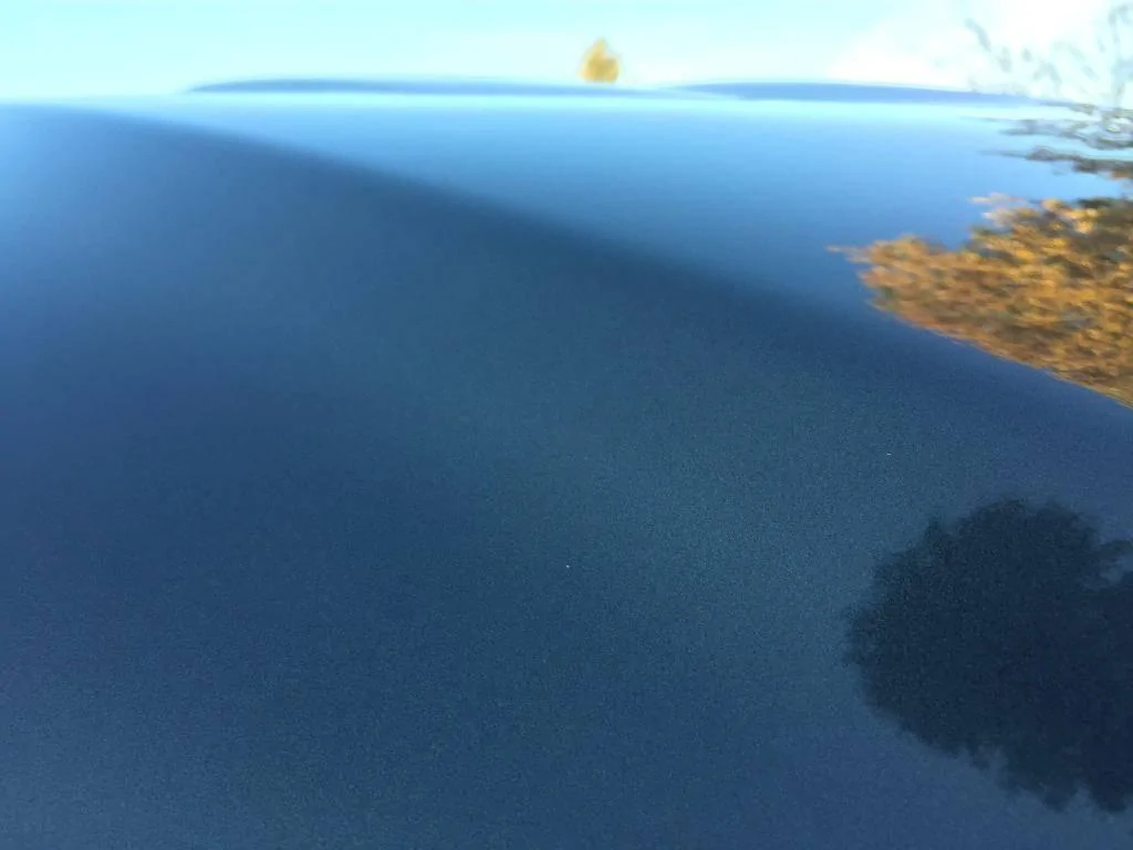

The first day of doing this on the Stang, I did not have much time (about 3 hours). What I got done was washing and drying the paint followed by a full-car clay bar for all of those nasty watermarks from the rain. The car is now fully prepped and ready for polish, paint sealant, and CARNUBA!

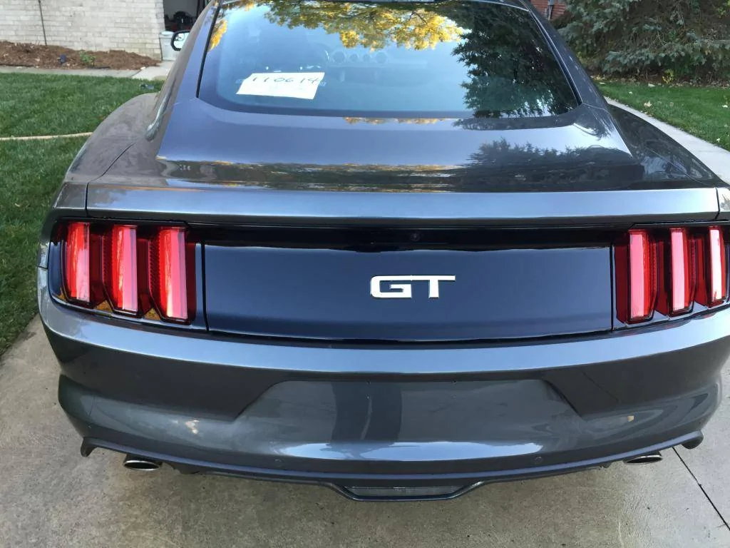

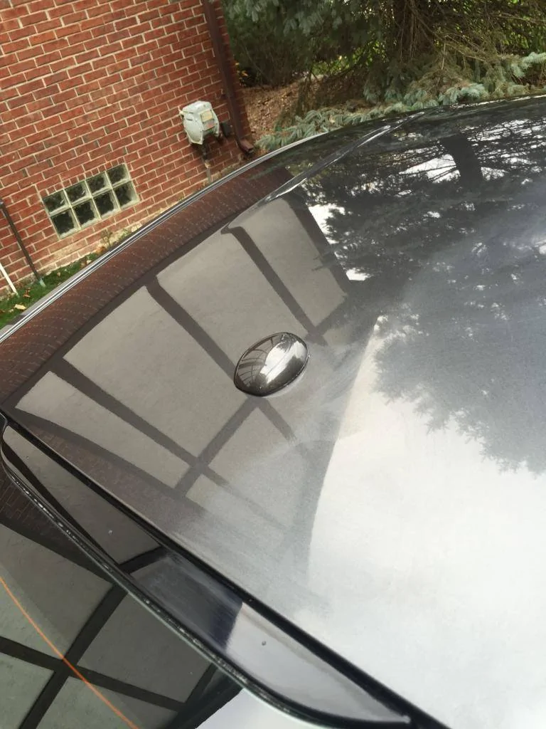

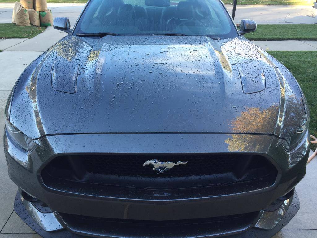

Here is a picture of what I am referred to, not pictured is some other gunk residue from stickers as well as BIRD S**T, just my luck right?
I forgot to take a picture of the car all suds'd up, but here is after a full wash and rinse down, prior to drying. I used a sample I received for Blackfire Wet Diamond Shampoo, It smells good and seemed to do the trick!

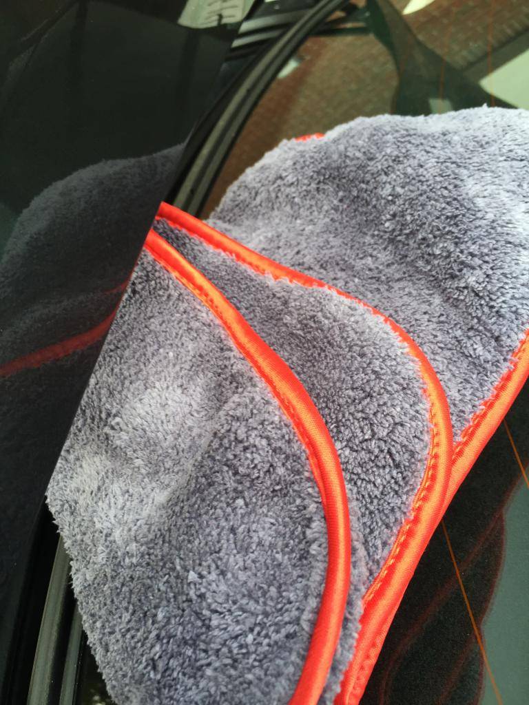

Post drying, Used a cobra guzzler waffle weave drying towel, followed by a super plush chinchilla dense microfiber towel. Temperature was low, so streaks did not fade as fast, but they are completely gone and the car looks much better!

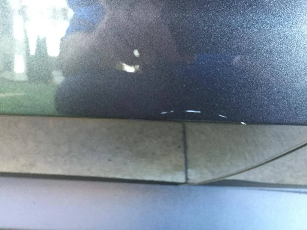

Darnit, I thought the car was perfect. One battle scar from the dealership... Small barely through the clear coat scratch on the bottom, driver's side door. Someones boot probably knicked it. I will try and use a rubbing compound or more abrasive compound to level out the scratch, other then that not bad!

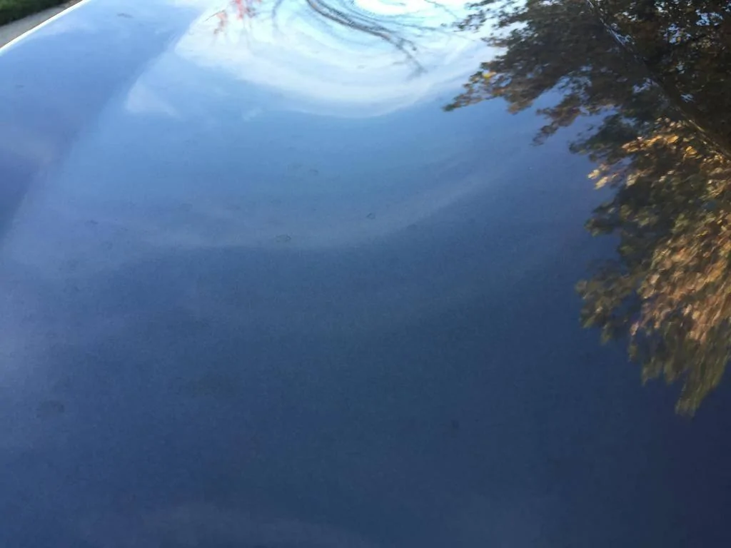

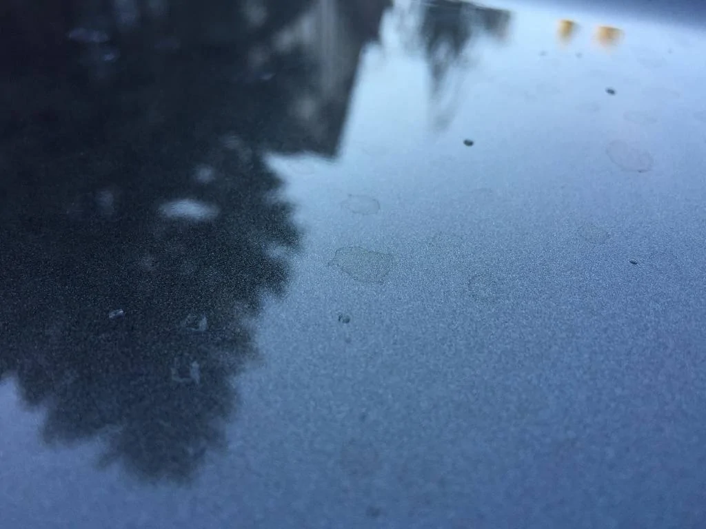

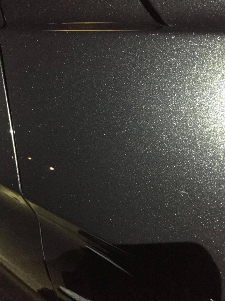

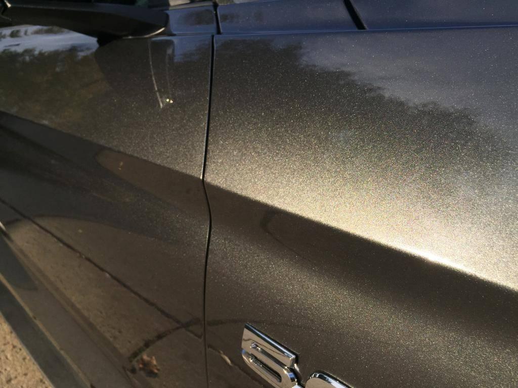

After the sun started to fade, the clay bar came out and I went to house trying to get it done properly so I could get inside and study, here are some pictures of the flakes. Wow do these things pop. The car looks good with the vette in the garage as well! More pictures to come, this has been a fun prep for the S550! My clay bar of choice was Mother's California Gold, Easy to use and smells very good! I also used Chemical Guy's Ecosmart Waterless Wash and Wax to prep up area's as well!

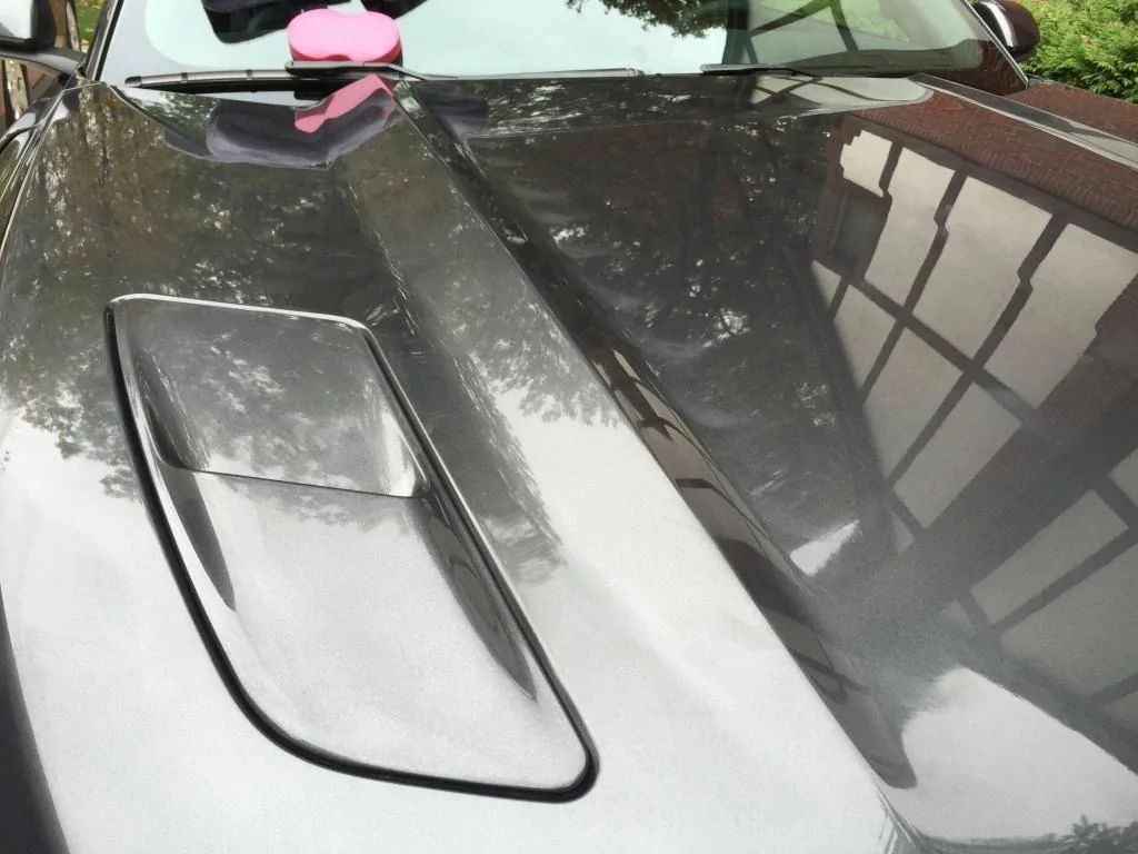

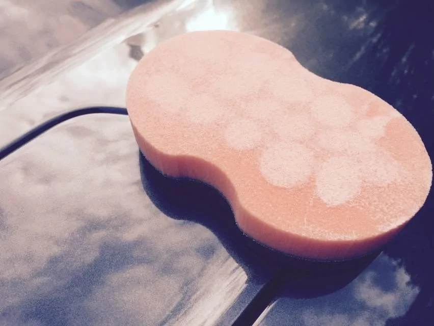

Following the Polish, I then began the sealing process. My product of choice was Blackfire Wet Diamond All-Finish Paint Protectant. This is the final step other than topping it with a Carnuba Wax. It bonds to the paint and protects the newly refined clearcoat from the step above. It claims to be good for 6 months, so I recommend doing this before and after winter if you are daily driving your car! I used a very soft foam applicator along with chubby microfiber buffing towels. Again, be sure to keep the towels clean and free of dirt, shake them out multiple times and feel for debris in the towel with your fingers before buffing off! Allow the product to "Flash" (or activate with a hazing effect before buffing off.) This product has an 8 hour curing time via instructions, so don't expose it to any sort of water after you complete the car!

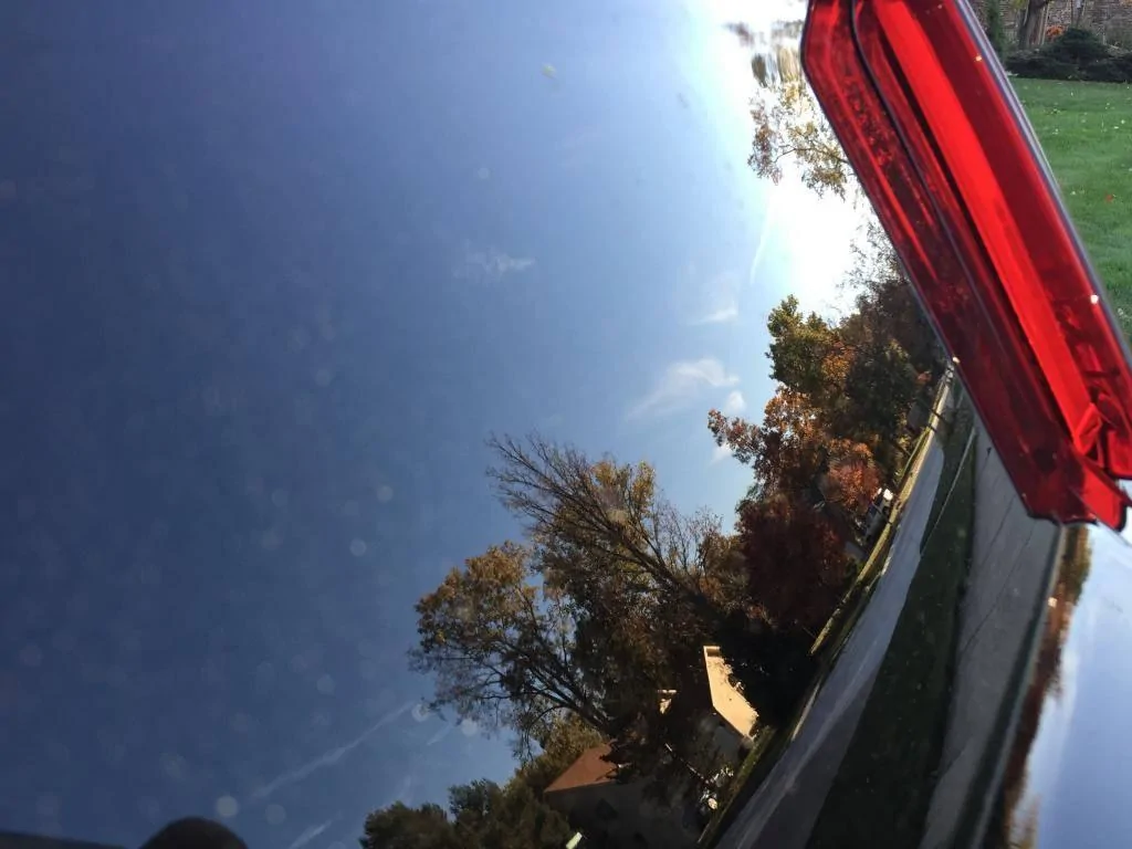

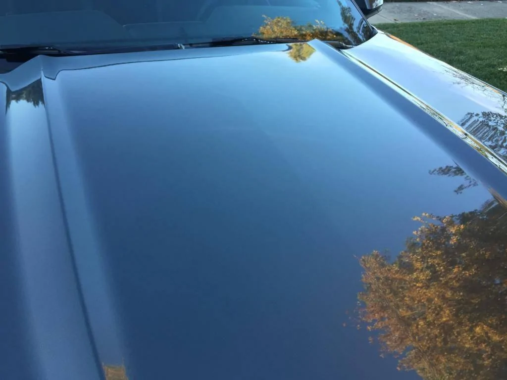

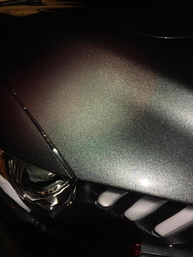

(Here some 50/50 shots of the hazing on a panel vs a clean panel)
Its hard to see on the hood picture as the lighting is bad, but the hazing is clearly there.

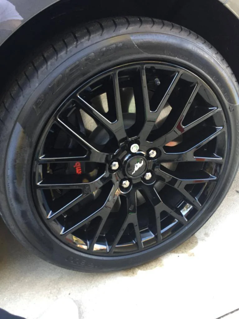

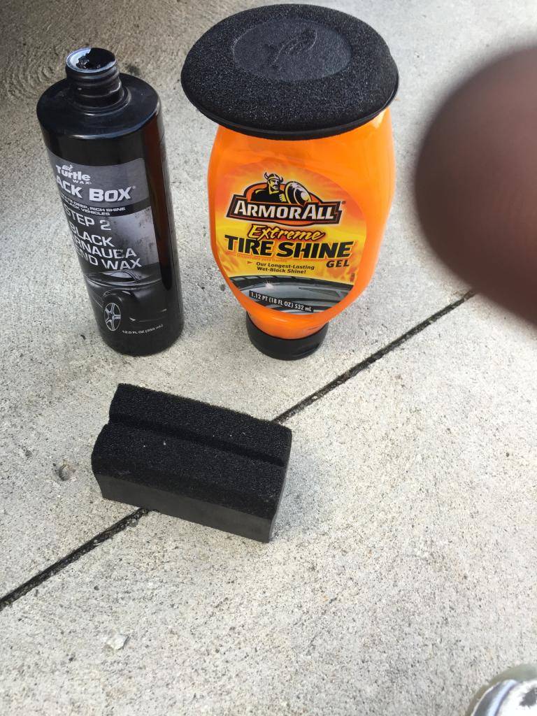

After the sealant, I worked on those ever-so-fun gloss black wheels that we all love... I used Armor-All Tire Shine along with Turtlewax's black carnuba wax on these bad boys. I used a degreaser along with a wheel-cleaner to prep the wheels before applying any product. Make sure you use a different towel for the tires, as they get black really fast. I suggest keeping a few towels strictly for tires, another few strictly for rims, and then the rest for strictly paint work. These pictures don't do justice!

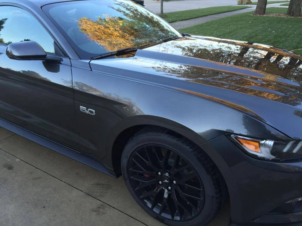

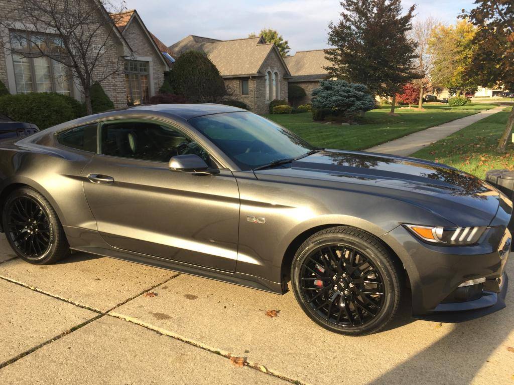

Here is the finished product for the day (BEFORE THE CARNUBA), I had to wait for the paint to cure to apply the carnuba the next day, but man does this thing pop!

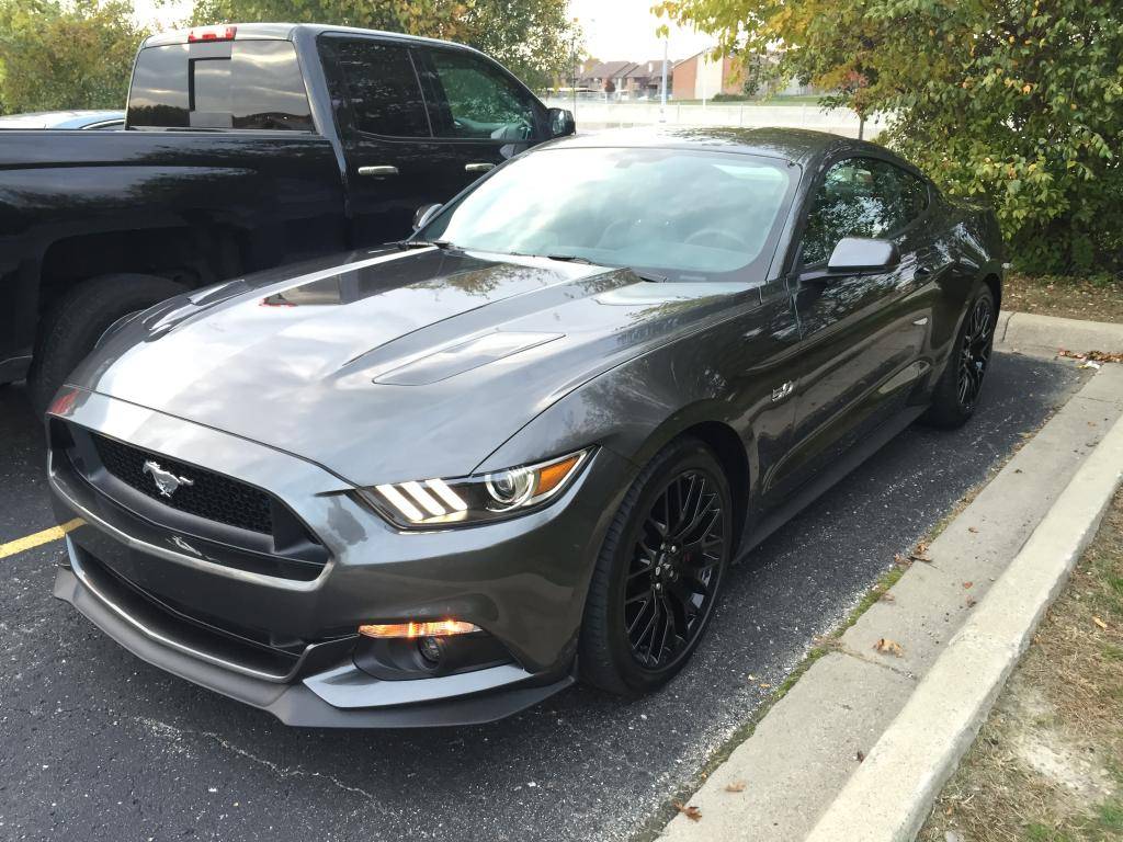

I didn't get pictures of this step, so I apologize! These next pictures are taken from various photographers during the xceedspeed BBQ car meet I attended, the paint and the car attracted a lot of attention! I used Blackfire's signature Midnight Ivory Paste Wax, all of the reviews are right about this wetfire-over-ice combo between all of these products, amazing is an understatement.
