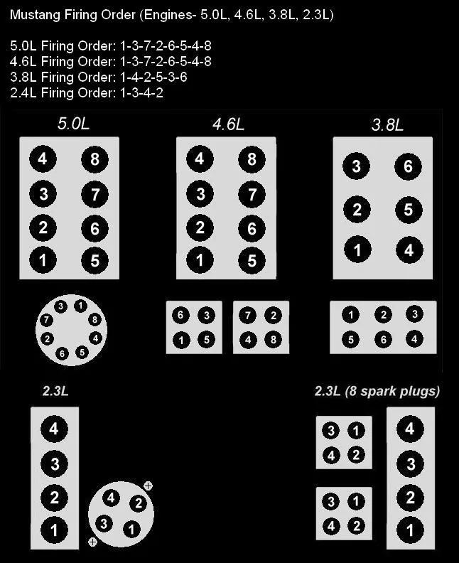

Yeah just had a quick look under the bonnet and took the engine cover off but couldn't see anything glaringly obvious... I may have another look in a bit but as it's only piston 8 I'll check around there just gotta figure out which one is piston 8

Engine cover off won't do much, need to pop the sparky out.

front left is 1, back right is 8 (That's left and right as you look at the car from the front).
