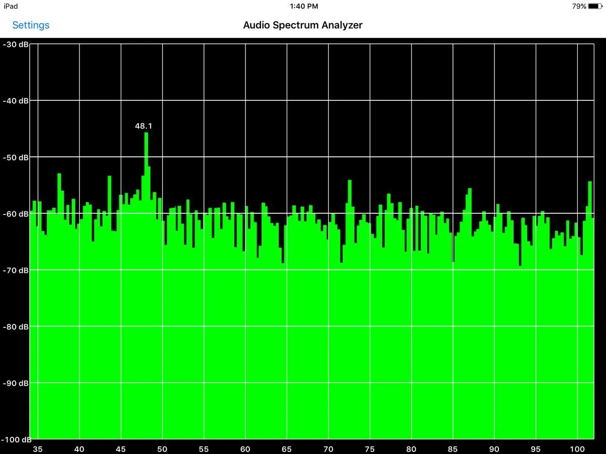

There shouldn't be too much guesswork as to whether you are hearing something or not. I bought an iPhone/iPad app to "listen" to the sounds in my GT. It cost about $4.00 as I recall, which is hardly worth mentioning. Just get it.
The sound frequency that was most noticeable in the car was 48Hz which is also the same speed as my driveshaft while driving 110 Kph. If I slowed down or sped up, then there was no standout frequency, but at about 110Kph (68Mph) it was very noticeable. Use a cheap app to help you diagnose your sounds.
Read the posts on page 118 and 119.
Blake

Thanks man.
So I used this on a smooth road going 75. It looked like this for some time. Dropping it down to 60mph and the peak isn't that high at all. So I guess I show them this

Did the frequency go up and down as you sped up and down? It should.
What is your gear ratio? Manual? Auto?
In my Manual GT with stock 3.31 gears and stock size tires at 110Kph (68Mph), the driveshaft turns at a CALCULATED speed of 47 times per second. (47 Hz) So my iPad hearing a very loud sound at 48Hz was close enough to know that they were a match.
In MY car 75 Mph would have given a sound of about 52Hz.
Do you have the auto with the 3.15 diff? That would explain why your frequency is different than mine. Of course, the phones/iPads could be a little off as well.
Sure looks like you are hearing the same thing I did.
Mine has been perfectly quiet since I did the DS balance last year.
