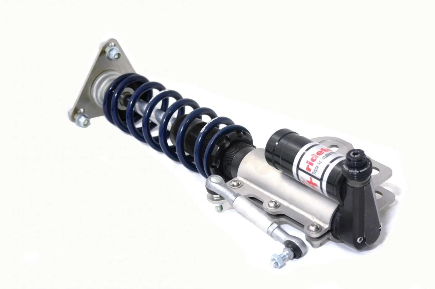

Do you have any pictures of how you mounted the remote reservoirs?I love my triples!! These coilovers and swaybars will make your car a machine! I've had the chance to run my car along with some good drivers in what would be comsidered better cars and hang with them on track.
Thanks... I appreciate it. What about in the front?I'll try and get a picture tommrow. It's 140 in my garage during the day... Lol I mounted them to the Evap case in the back. Works really well
Our triple adjustable strut uses a "piggyback" design. It's all one unit, no hoses like the rear.Thanks... I appreciate it. What about in the front?
