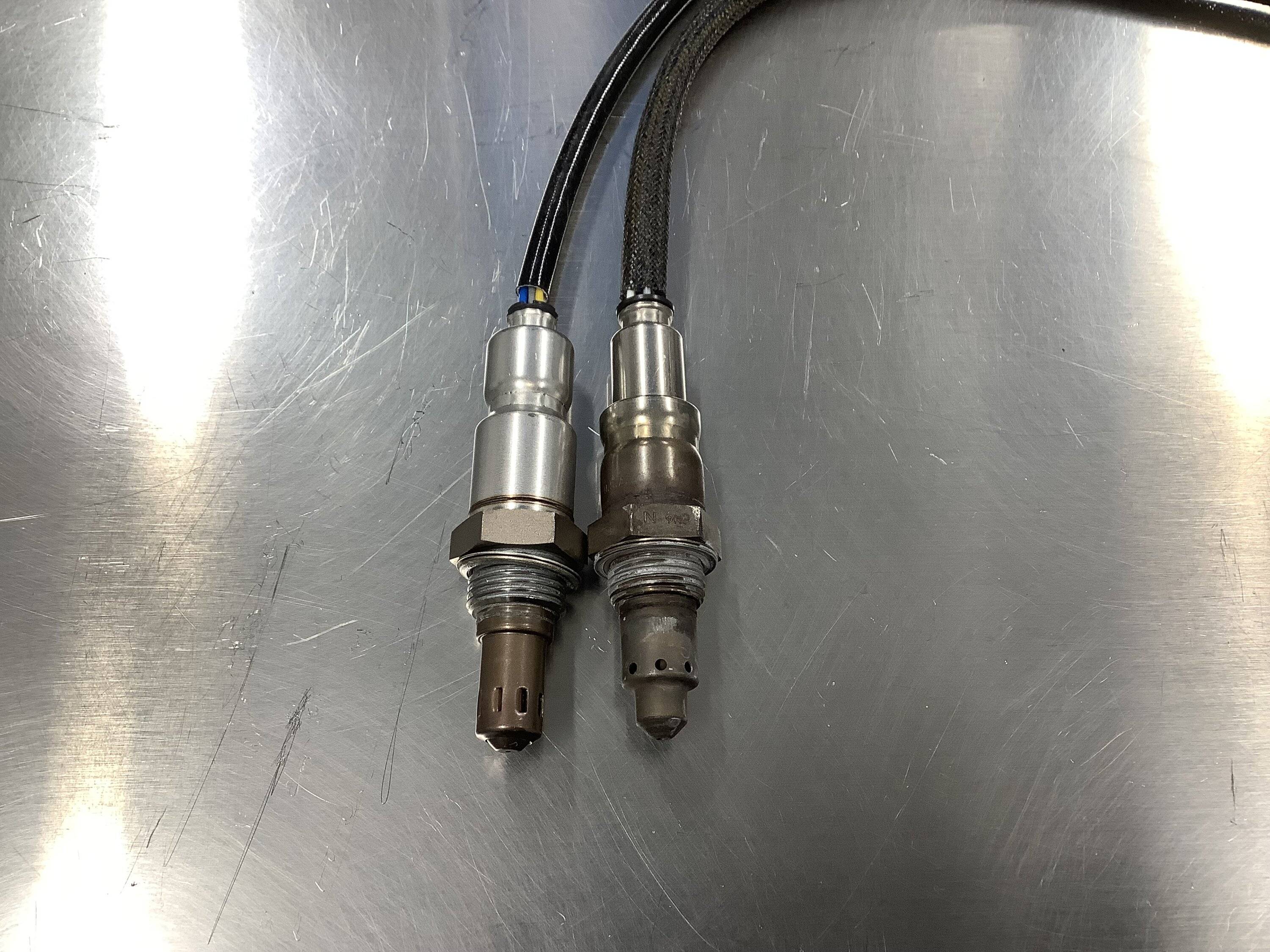

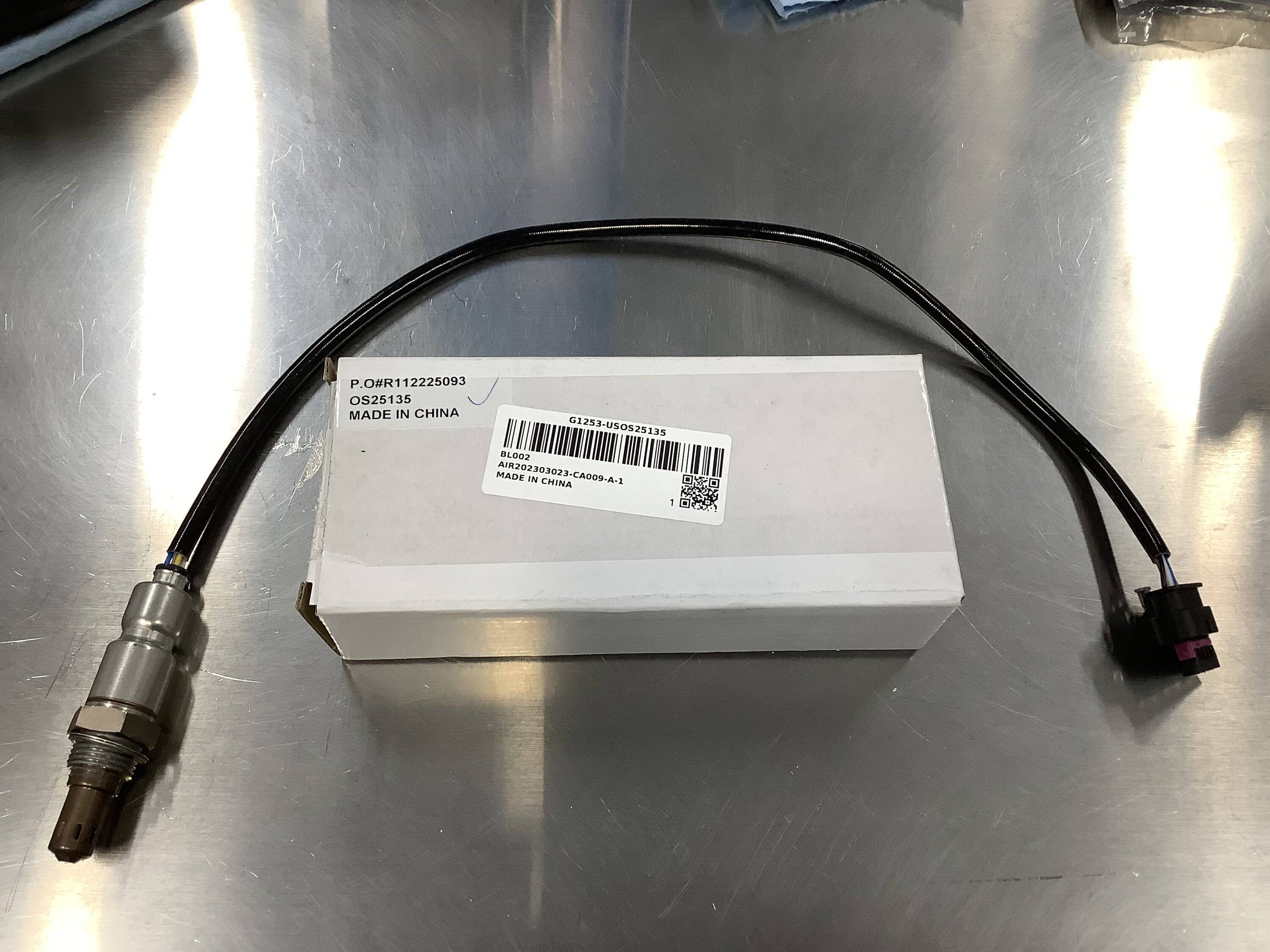

Last week, I installed new non OEM upstream o2 sensors and my car threw the following codes: P0300, P0301, P0308 and P0316. In addition to these codes, the car stumbled, popped and bucked. The car ran so poorly, that I couldn’t even get the car down the street.
Yesterday, I removed the non OEM sensors and installed new OEM sensors. I’m now awaiting the arrival of a new air filter for my CAI Kit. I should have that in hand on Tuesday, at which time I will start the car and take it for a test drive. I’m fairly certain this will fix the problem.

Wow, I am pretty certain you found your issue as it started with the replacement of your o2s. What non oem brand did you happen to go with? I know the o2s are very critical sensors on these cars. Running e85 can be detrimental on them if they are not angled (which my stainless power LTH are not angled) during my process of restoring everything back to stock I threw on some new motorcraft f150 upstream o2 sensors since these are longer and it bypasses the use of o2 extensions with long tube headers. I ran e85 briefly on my old o2 sensors which is why I replaced them, just in case the readings were erratic.
My crank sensor is a year old. The old one was covered in clutch material. I might take my car back to ford again as they can now communicate with the computer since the car will have the stock tune on it. First I am going to replace all the spark plugs with oem ones that are pre gapped. Last time they tried telling me my spark plugs weren’t properly gapped and were going to charge me an arm and a leg to replace them all. I currently have NGK spark plugs gapped around 0.050 inches
I ordered them from Parts Geek. See part number on box, along with a pic of the sensor.
In this pic you can see the difference in the tips between the non OEM sensor on the left and the old OEM sensor on the right.

That’s a pretty noticeable difference! I am 95% sure that would be your issue. My f150s o2s look more like the one on the left. Just has a longer wire
