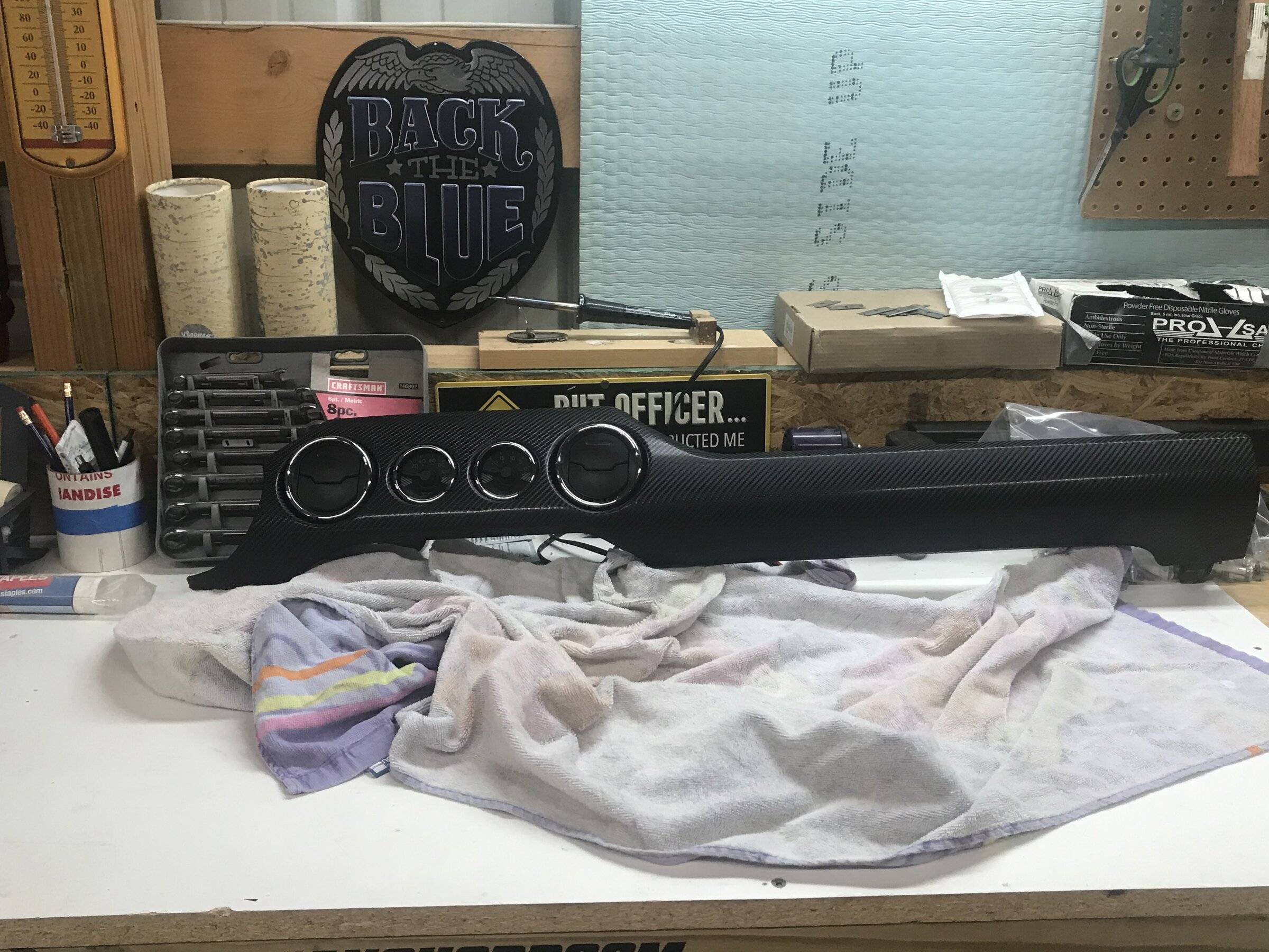

Ill have to buy another dash piece to try it out on. Ive never done anything like it, but I like learning new skills. Is the fiber tucked behind the panel or is it cut flush with the metal with some kind of adhesive?
It's laminated with epoxy, and cut along the edge of the metal, not wrapped around.

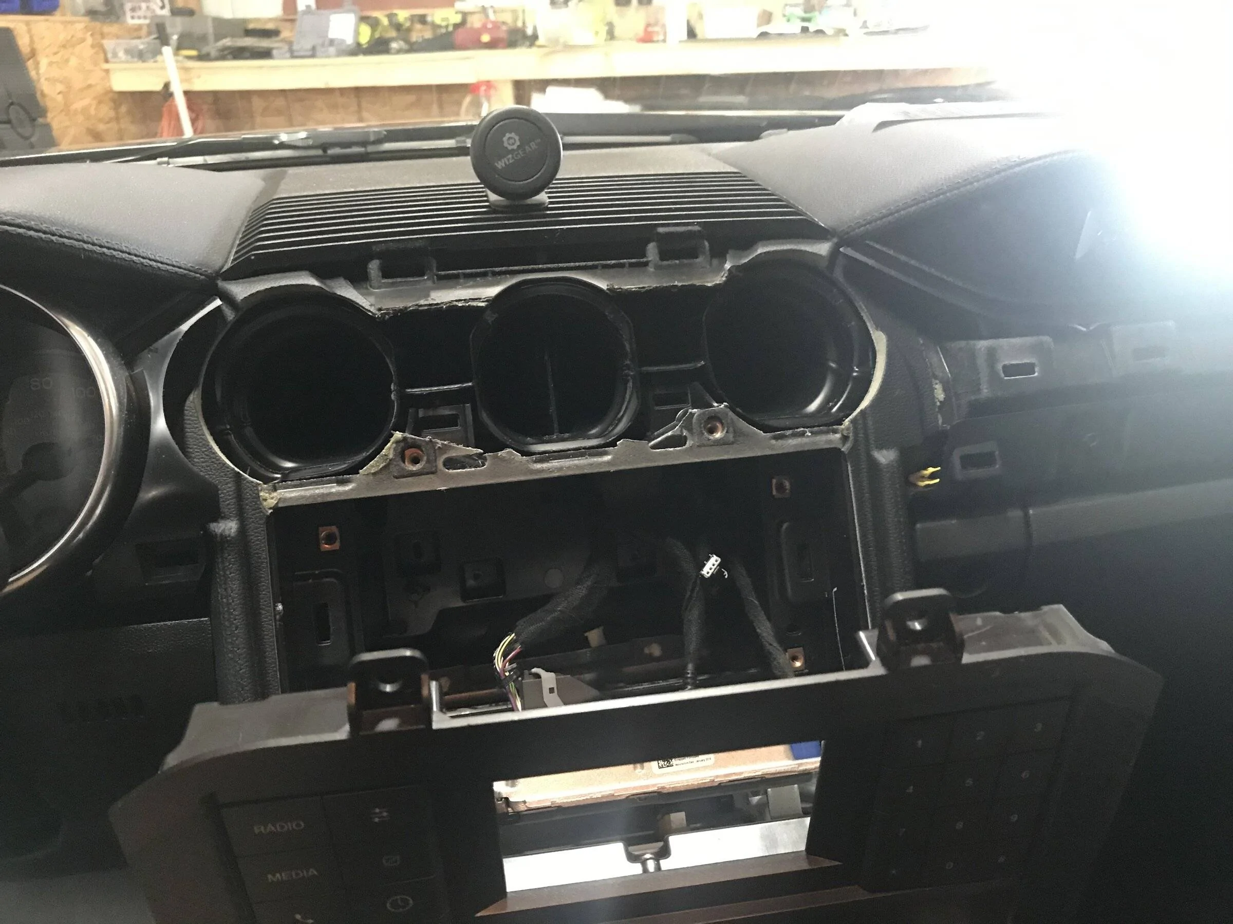

Alright, Iā€™m a glutton for punishment and I canā€™t just cap off the middle vent. How do I remove the non-PP air duct and install the PP air duct? (21 GT base non-PP 301A 6M) I know I have to remove the dash, but I canā€™t find any good info on this (looks like there were some pics posted detailing the procedure but the links are dead now).
Yes I know itā€™s dumb to remove the whole dash when I could just cap off the center vent, but it would bug me for eternity.
Thanks!

I had to cut out the middle air duct Know air Duct replaced I cover up mine with a piece of plastic and some duct tape this was before I put in some plastic over the duct

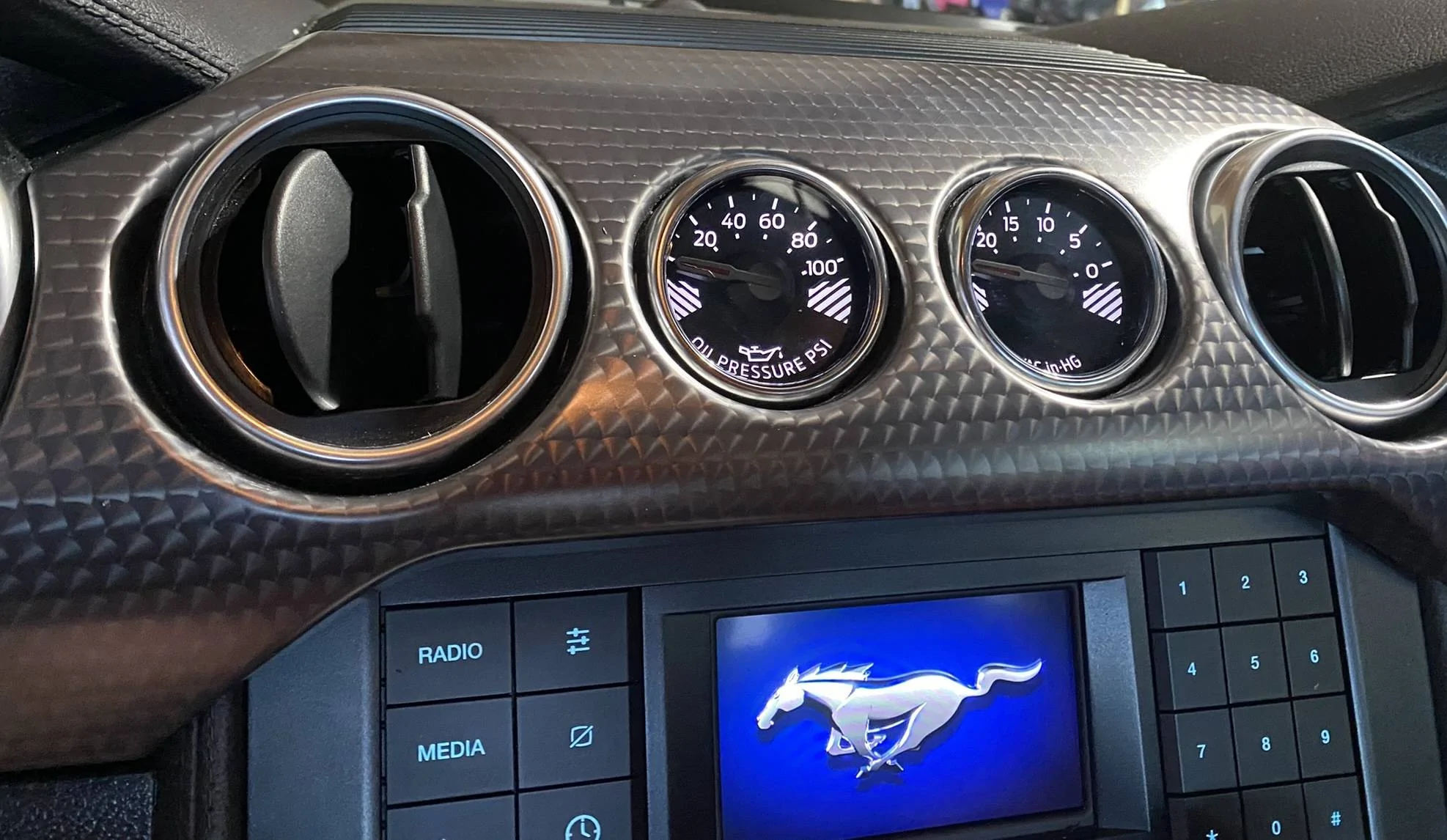

2020 Mustang GT
After months of searching eBay for a a dash panel that wasn't beat to hell, I finally found a set. Got them installed easily enough and they worked right away on my 2020 base GT. Thanks to all those that contributed to this thread. Made the install a breeze
