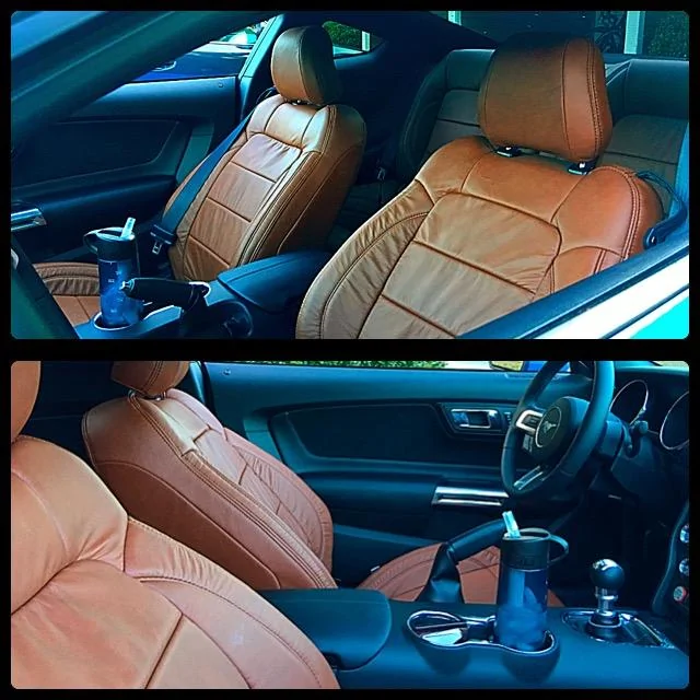

I'm almost finished changing my cloth to leather. I Just have the driver seat back left. Passenger seat and rear seats came out perfect and tight just like it came from the factory.
I did want to add that I purchased the seat belt straps and found a solution to replacing the rivets with 1/4 bolt and a u clamp. Didn't want to by another rivet gun and bigger rivets then I had on hand

Come on updated pics!! :D
