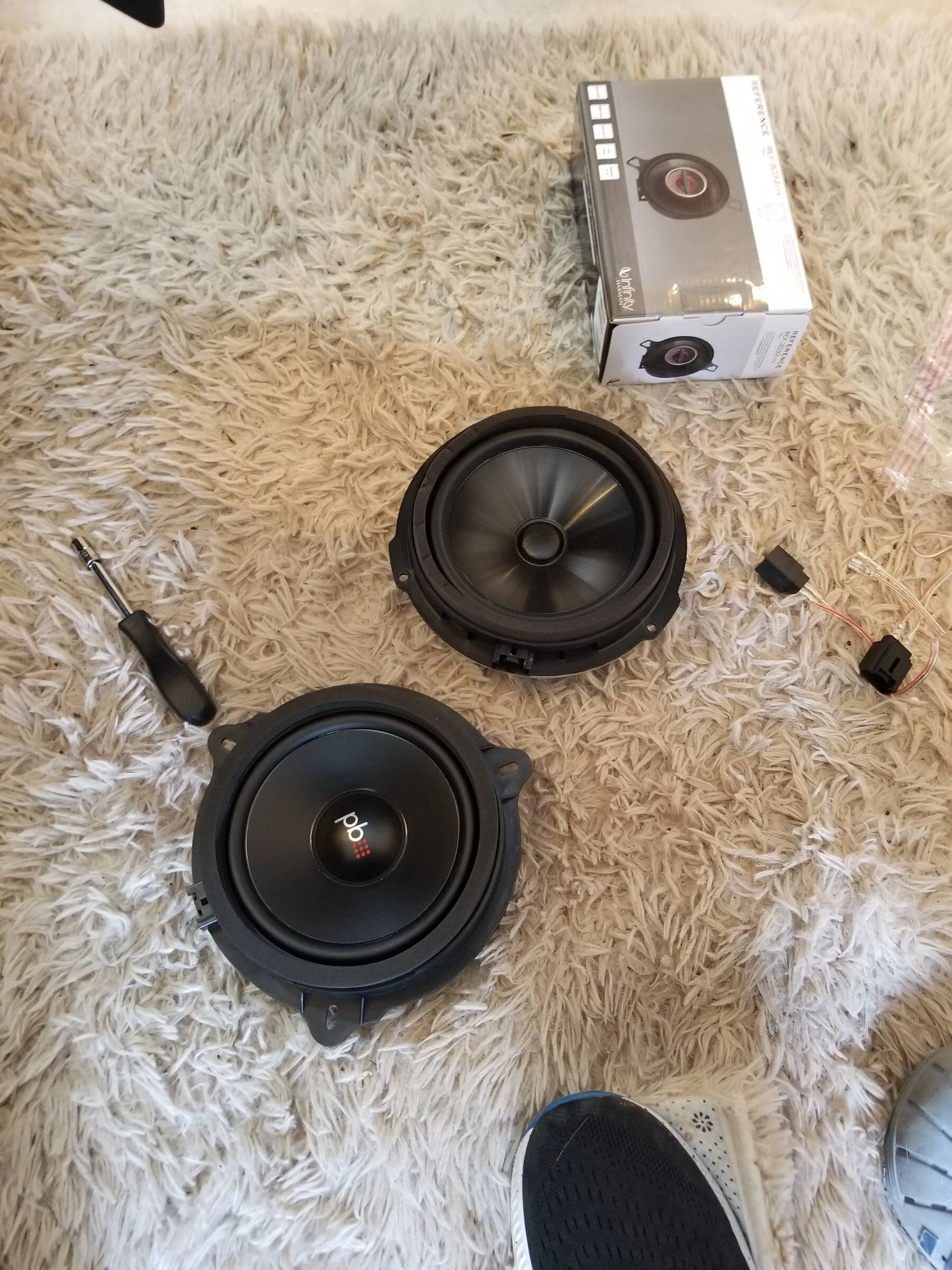

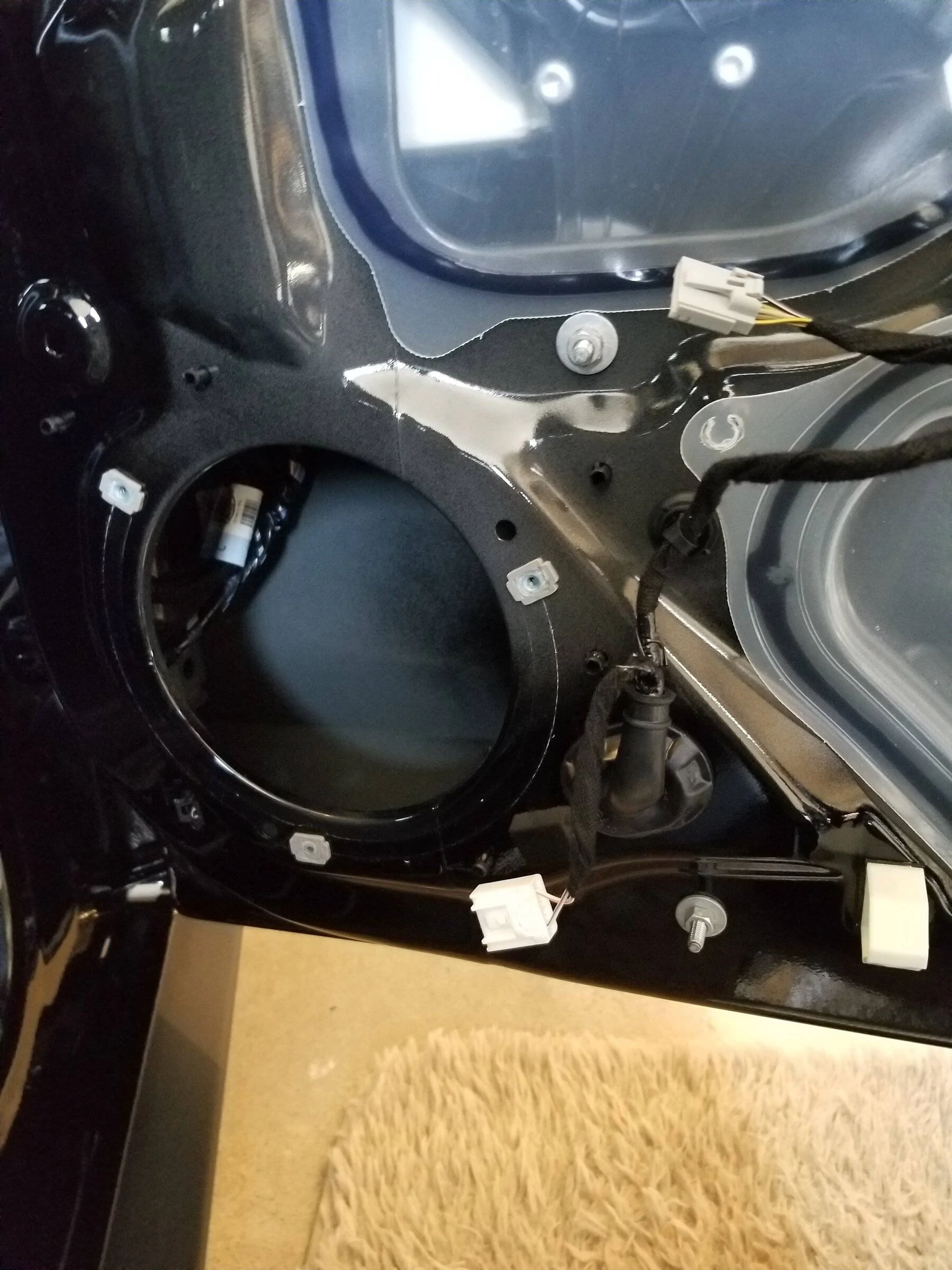

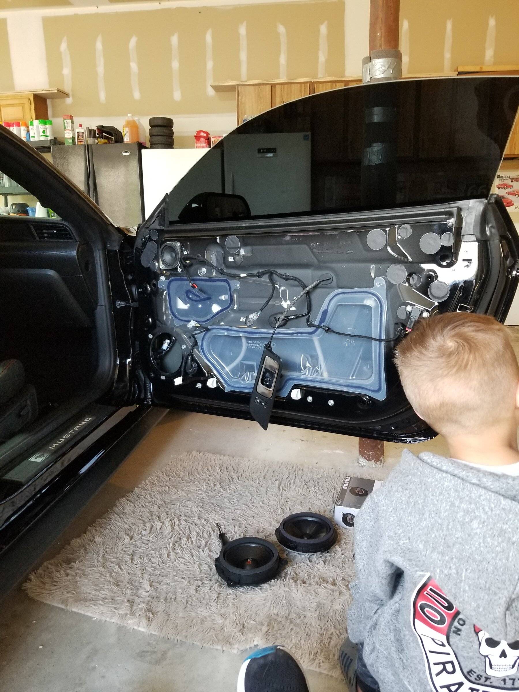

For now, i ended up going with crutchfiels recommendations, plug & play PB set up for doors n deck, Infiniti 3.5s for doors. I've read were this alone has made a difference that many were happy with....well see.
not installed yet. i figured while at, attempt to sound deaden things too. so i ordered a box, its been delivered and now im just staring at the pile of goodies to go in. I also ordered Forscan tool, downloaded software and getting ready to turn off the eq. hoping this is a win when complete. I'll post up results when done.How did this set up work out for you?

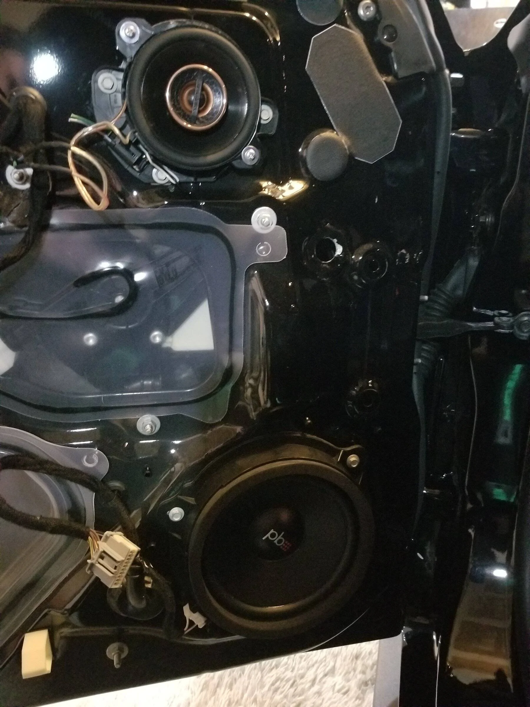

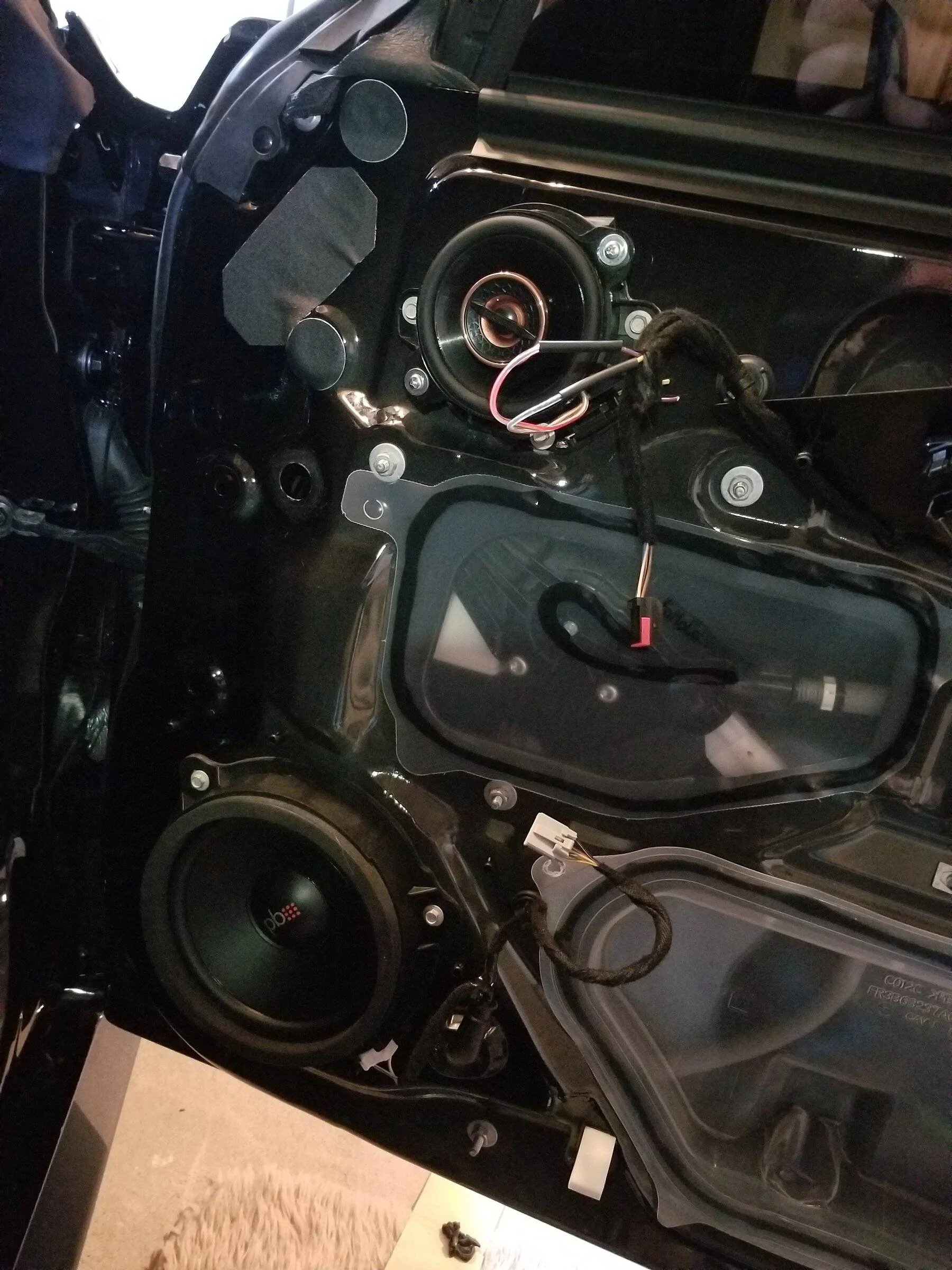

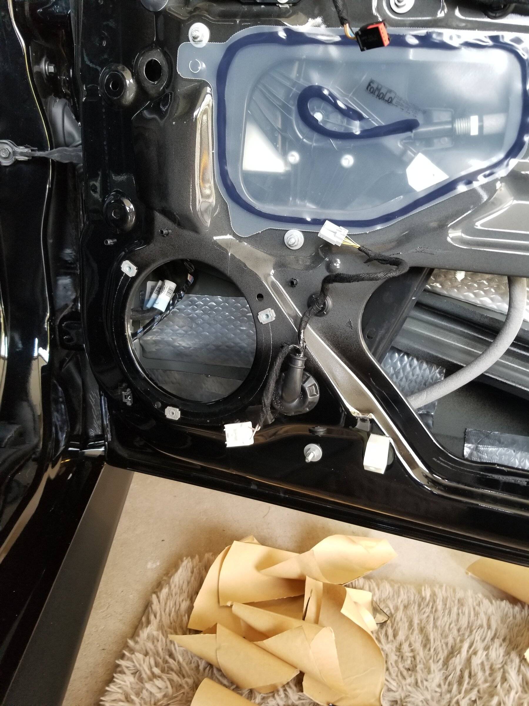

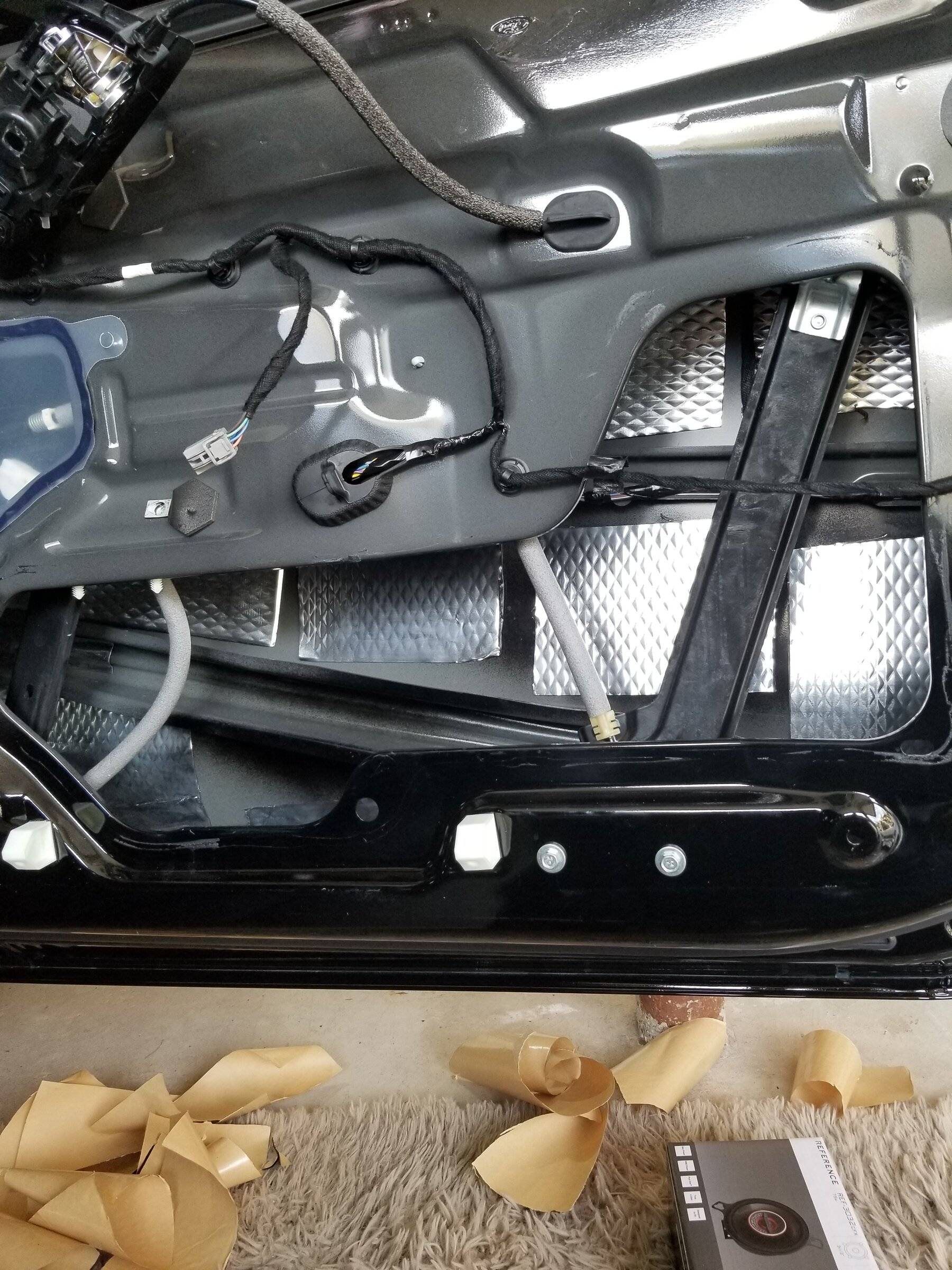

Thanks for this write up. Really interested in hearing how you feel after listening to it for more time. Did you end up disabling the factory tweeters in the A pillar? I have the same woofers in the doors and also switched out the tweeters that came with them. After some time I came to dislike the sound as I noticed some weird popping from the woofers when turned up. I was going to put it back to stock since I didnāt hear it that way. I started with the tweeters and was going to do the woofers the next day and noticed the popping was completely gone with the stock tweeters back in. I can only assume it was due to the impedance mismatch from the 4 ohm tweeters I put in, which are wired parallel with the 3.5s. The 3.5s you installed are 3 ohm? If you still have the factory tweeters installed then the total impedance is like 2.2 ohm now instead of 4 (8 ohm and 8 ohm parallel factory). Really curious if you come across the same issue I did.I made some progress this week and finally wrapped up the front doors yesterday. Everything installed with no isssues. I was able to add 3 sheets of deadener to each door, that seems to have made a decent impact. The doors have a more solid feel to them now. From only a few minutes of listening....theres a nice improvement already.
Hey Mike, no i have not disabled the factory A pillar tweets yet... I was going to put the PB tweets in but after more reading and coming to find they are probably not that necessary, will just leave them alone for the time being. so far, the few minutes in it yesterday i felt like the sound deading helped a lot in the doors, sounded more dense imo. no rattling.Thanks for this write up. Really interested in hearing how you feel after listening to it for more time. Did you end up disabling the factory tweeters in the A pillar? I have the same woofers in the doors and also switched out the tweeters that came with them. After some time I came to dislike the sound as I noticed some weird popping from the woofers when turned up. I was going to put it back to stock since I didnāt hear it that way. I started with the tweeters and was going to do the woofers the next day and noticed the popping was completely gone with the stock tweeters back in. I can only assume it was due to the impedance mismatch from the 4 ohm tweeters I put in, which are wired parallel with the 3.5s. The 3.5s you installed are 3 ohm? If you still have the factory tweeters installed then the total impedance is like 2.2 ohm now instead of 4 (8 ohm and 8 ohm parallel factory). Really curious if you come across the same issue I did.
Yes, I do have an opinion on that. I was hesitant to do it, wasnāt sure what was actually happening when āflattening the EQā. I wasnāt convinced by what I was reading here. I wasnāt going to buy the OBD interface just for that. But I ended up wanting my DRL situation fixed enough to buy it for that purpose and while I āwas in thereā I decided to try the EQ thing as well, knowing I could just switch it back. Iāll tell you what, I wish it was the first thing I did. As it is now, I think the biggest place the 9 speaker falls down is the 3.5s in the door, hence my interest in this thread. The rears are almost non existent as far as I can tell and I wouldnāt mind getting more out of them, so thatās something I may tackle down the road.Hey Mike, no i have not disabled the factory A pillar tweets yet... I was going to put the PB tweets in but after more reading and coming to find they are probably not that necessary, will just leave them alone for the time being. so far, the few minutes in it yesterday i felt like the sound deading helped a lot in the doors, sounded more dense imo. no rattling.
