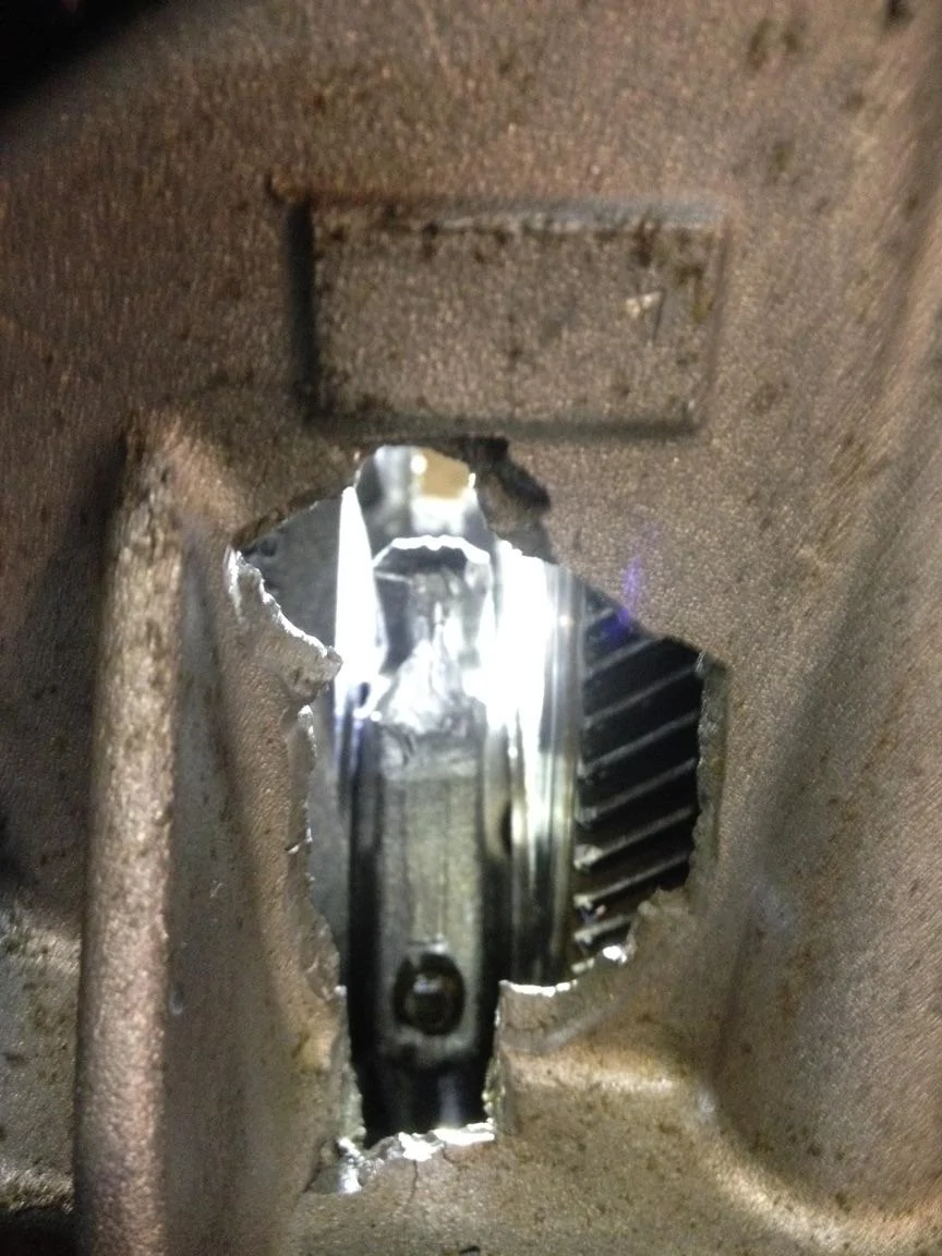

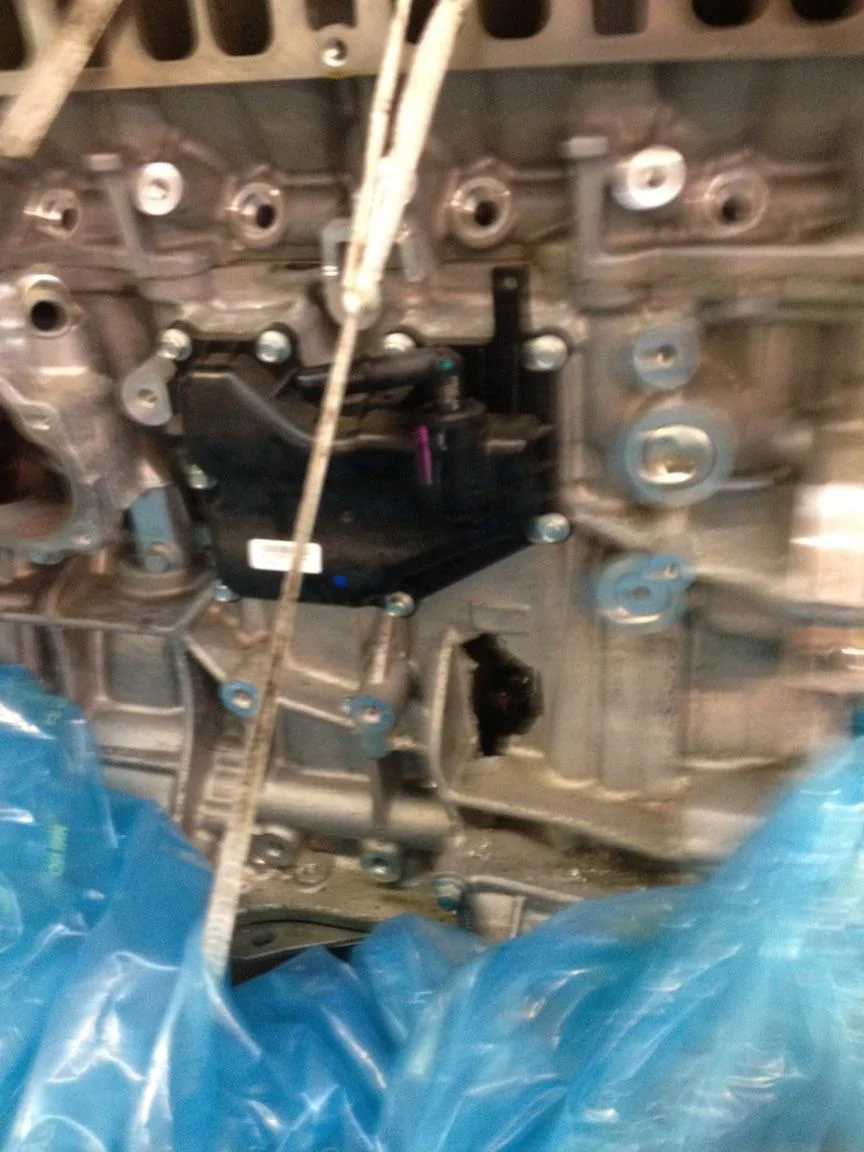

I have followed this forum since I purchased my 2016 PP Ecoboost in October of 2016 so I joined the forum to post what has happened to my car at 12,000 miles. When I purchased my car my local dealer, which I am family friends with, did a transfer from an Atlanta dealership from which I found the car online. I got the help from a very reputable tuner on this site that worked with the dealership and purchased (a 93 custom tune, catch can, intake a plugs) to be built in the loan. I got a bout a thousand miles on the car and added the mods. The car has been flawless. I was leaving work and getting up to speed on a 4 lane, not a lot of throttle and very little boost and BAM, (oil, smoke, and pieces coming out from under the car). Luckily for me, I called my friends at the dealer and they sent a truck, brought it to the dealer, let me pull the tune out, they covered everything under warranty, put a 2017 engine off the assembly line in, and now I'm driving the car again.
So what happened to the engine was a rod broke into and the pieces came through the block as indicated in the pictures below. Also, the mechanic at the dealer showed be the balance shaft assembly, it also came apart. This was a Cleveland engine.
So, I am going to give my opinion on what I think occurred. A couple of months ago the car started idling rough so I got with my tuner and tried a few new tunes to get the idle corrected, we never could get it as smooth as I wanted. Here is my thought and my tuner thinks I may be onto something. Looking at the balance shaft assembly, I think it was a defective part from the factory and over time found a weak link in the rod.
I would love to here other inputs and what others may thinks. Glad to me a new member with some input.
