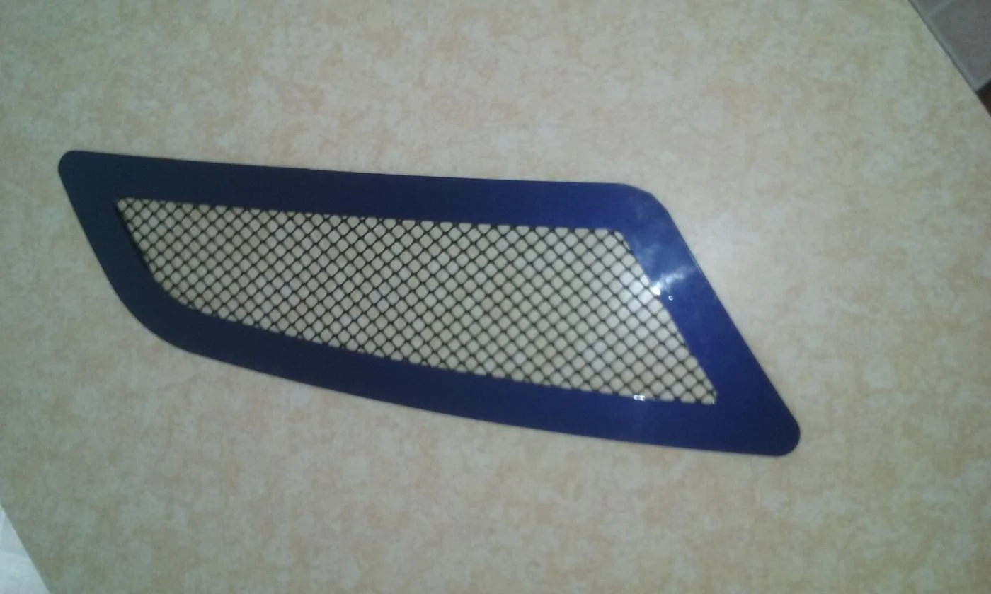

While I changed to the Roush vents, they do little to no change from the stock setup. However, I gutted the Roush vents and opened up my hood passage as well. My first goal was to help elimate lift but heat is also extracted at a much better rate. I no longer get hood lift at the track and this is speeds up to 140mph. Rain or washing the car is a non issue since my air box is closed on the left and nothing is affected on the right. I also have a grill that allows full flow of air across it.
Before adding edge trim.
Trim protection added.

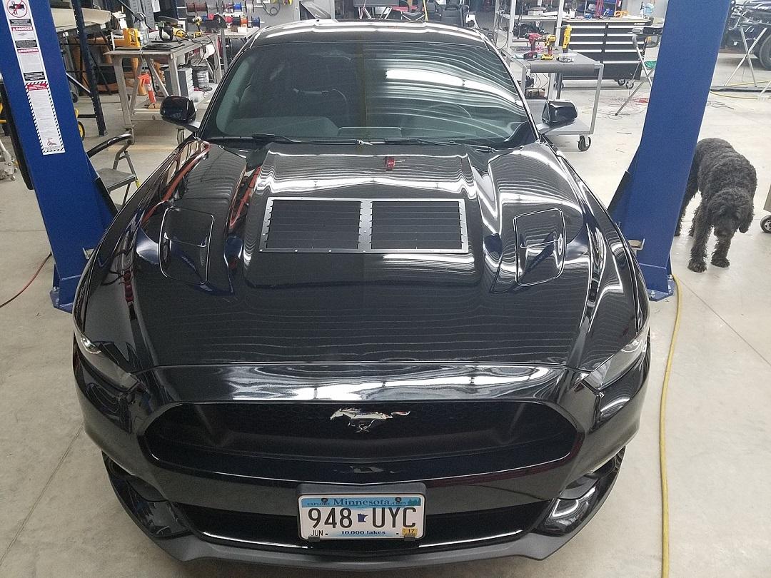

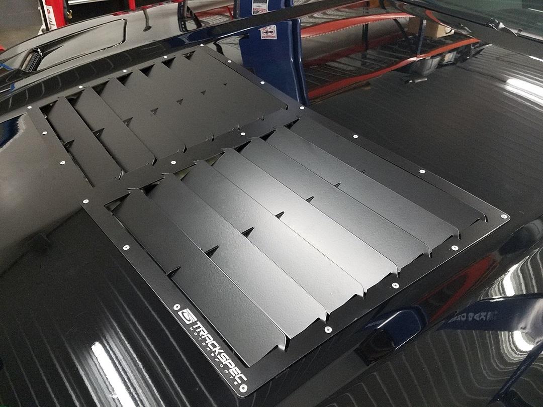

I followed 908ssp's lead (Thanks for sharing the mod!!!!!, Great Idea!!!!). Seemed the most effective solution.

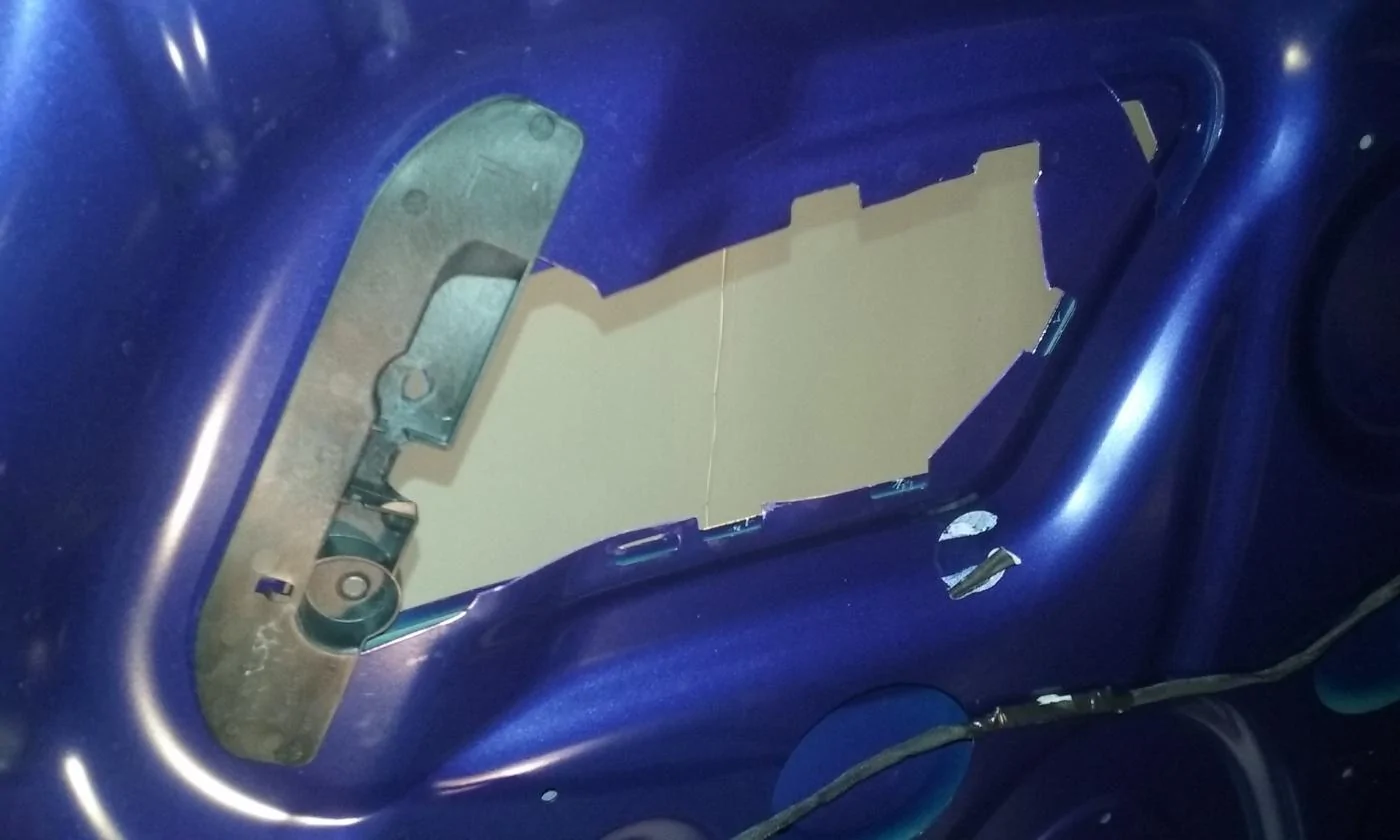

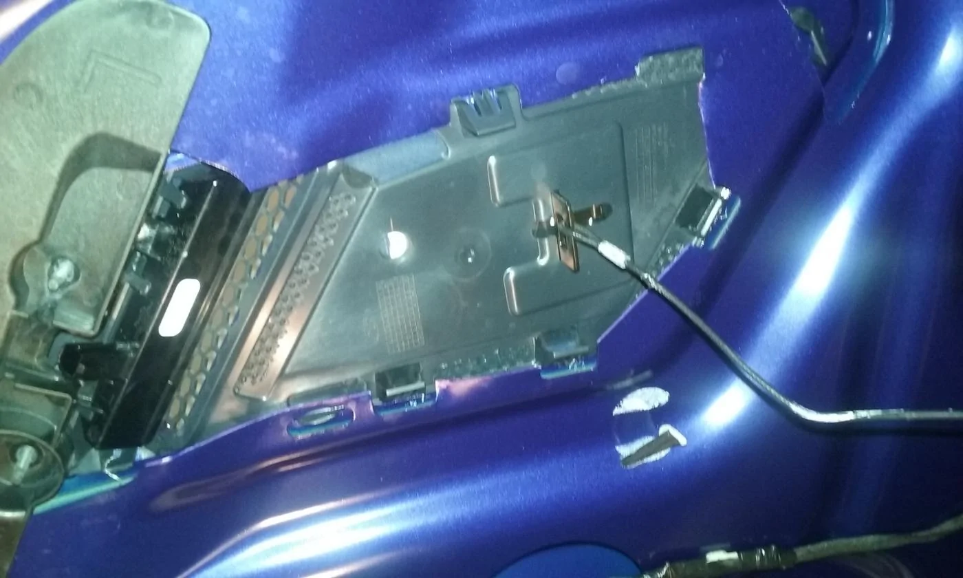

I cut out more area under my stock vents to where the little rectangular openings are that snap the factory vents into place and made my own vents. Mine look like the Scott Drake vents, but without the screws sticking out the top of them. the stock vents use the outside area of the openings to snap into place, not the inside. So I thought what the heck, I'll cut out more area. As you can see, I can still go back to my factory vents.
My pics got sideways, SH*T!!! But that's the driver's side vent with the factory vent snapped into place, and off. The white area through the opening is my ceiling in the garage.
