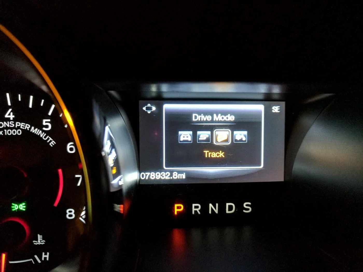

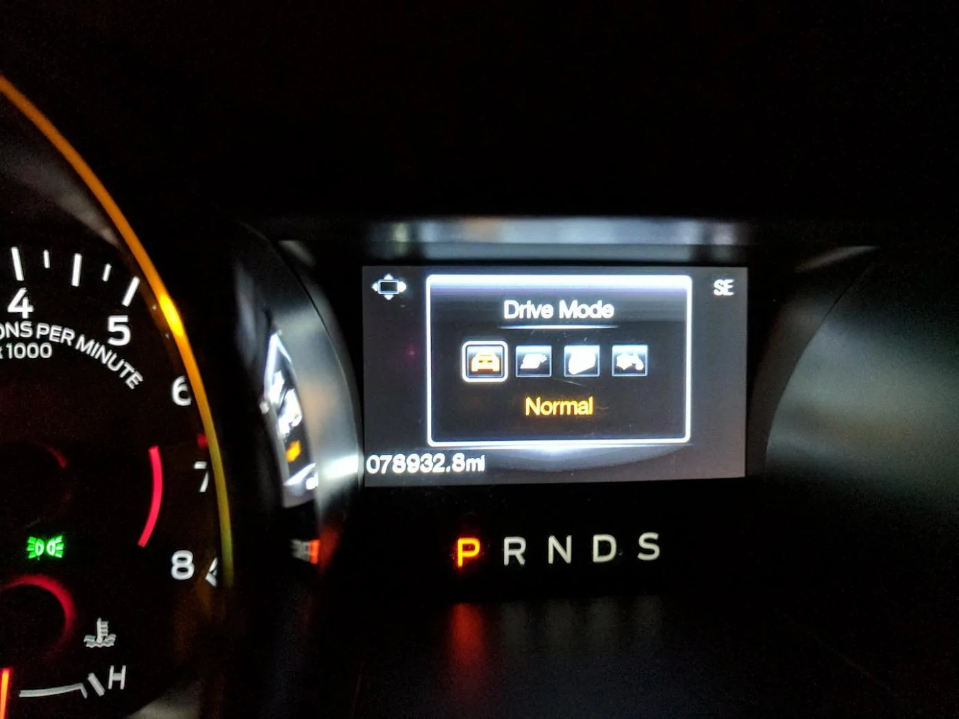

Hey guys! Thanks to [MENTION=29038]mustangmike86[/MENTION] for the initial discovery, I have been successful in enabling the 4 Drive Modes on my 2015 V6!
When in sport + there is a marked increase in throttle response and a change in transmission behavior. The auto trans in sport + is far more aggressive then in normal drive mode but not as aggressive as when I actually shift into S. It will hold shifts longer and is more eager to downshift based on throttle input but will still shift into 6th during normal driving unlike when in S. Track mode feels slightly more aggressive but not much of an improvement over sport + except for the removal of traction control. Snow/wet did not feel any different then normal mode??? I am assuming that this mode just turns up the sensitivity of stability control?
To enable drive modes you will first need a premium radio bezel (MFT or Sync 3 swap) in order to have the 4th hardware toggle. You then need to change these As Built Data lines in the instrument cluster and ABS module. Instructions on how to acomplish this are posted here: http://www.mustang6g.com/forums/showthread.php?t=61773

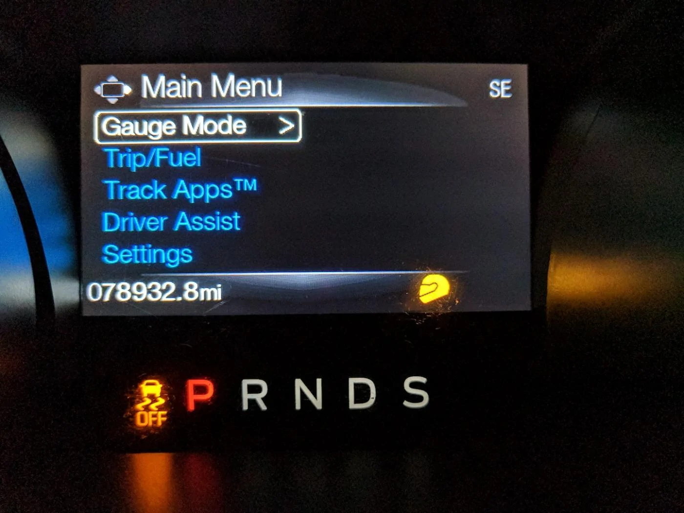

Mk I getcha, I getcha. I bet if one was to take their time it could be cleanly done. I may be down to tackle that. Can you change drive modes through the menu in the gauge cluster or only through the toggles?
zackmd1
zackmd1
Oct 1, 2013
138
5,139
2,672
Zack
Drive modes are only accessible through the toggle. And you could possibly get away with installing a Tom top screen into a premium bezel. The only question would be as to how the climate system will function... The toggles are connected to the dual zone climate controls so you can not get one without the other.
