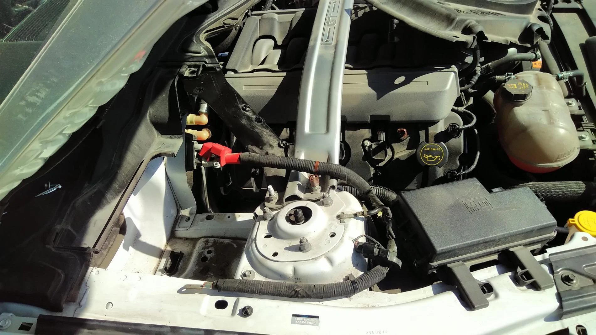

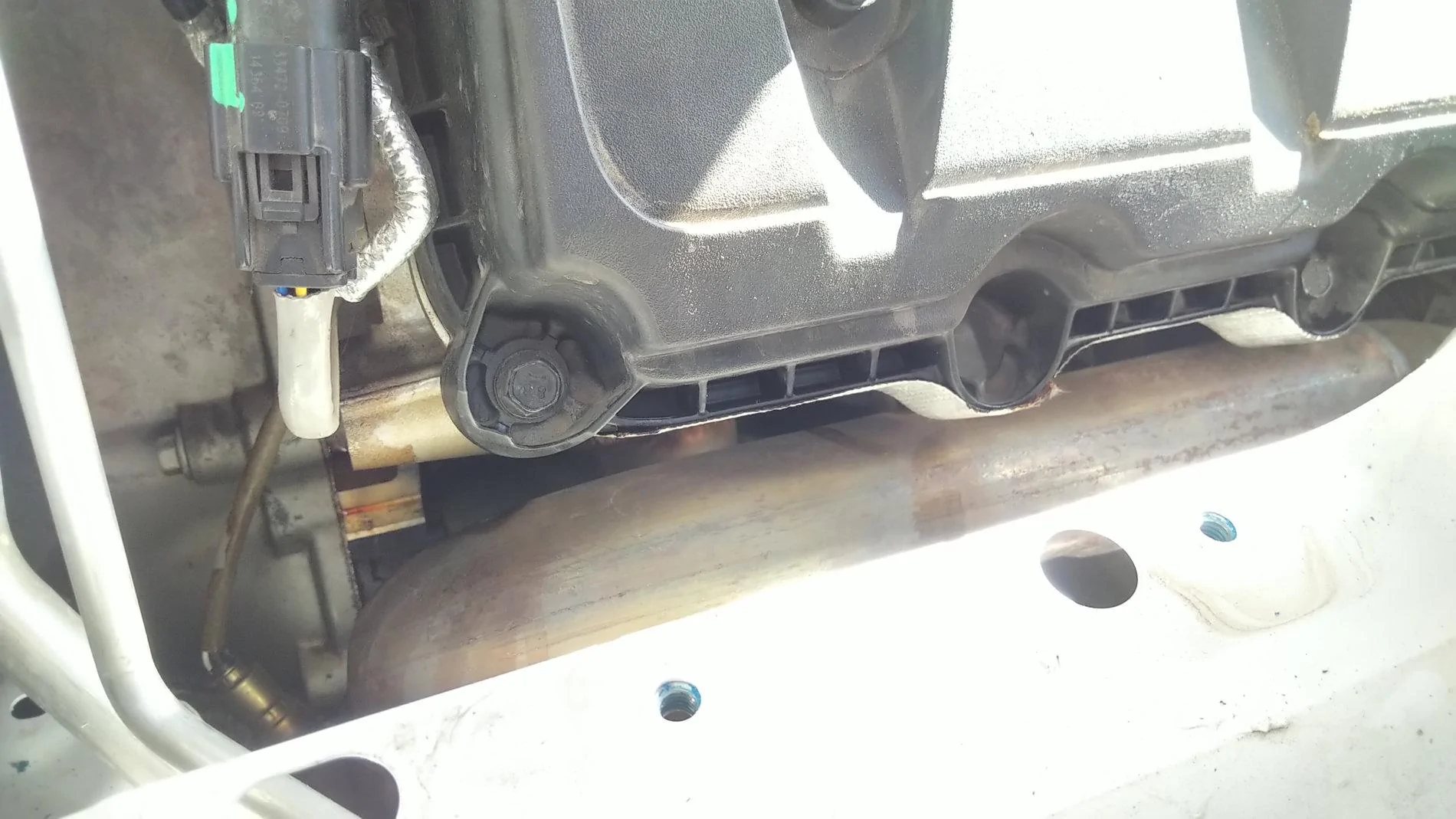

Bumping an old thread.
Had a strong smell of burning oil (almost like an old diesel) that was very prevalent when coming to a stop and during idle. Once I got to work, I got out and saw smoke coming out near the passenger headlight.
Valve cover bolts were loose on passenger side.
Removed the battery, battery box and metal framing to get easier access to the bolt near the firewall.
Can see the oil drip/burn marks at the header in the pics.
A hint of the smell during my drive home after fixing...should be gone once it's all burnt off after another drive cycle or two.
I just started getting this recently. Did you fix it just tightening the bolts?
