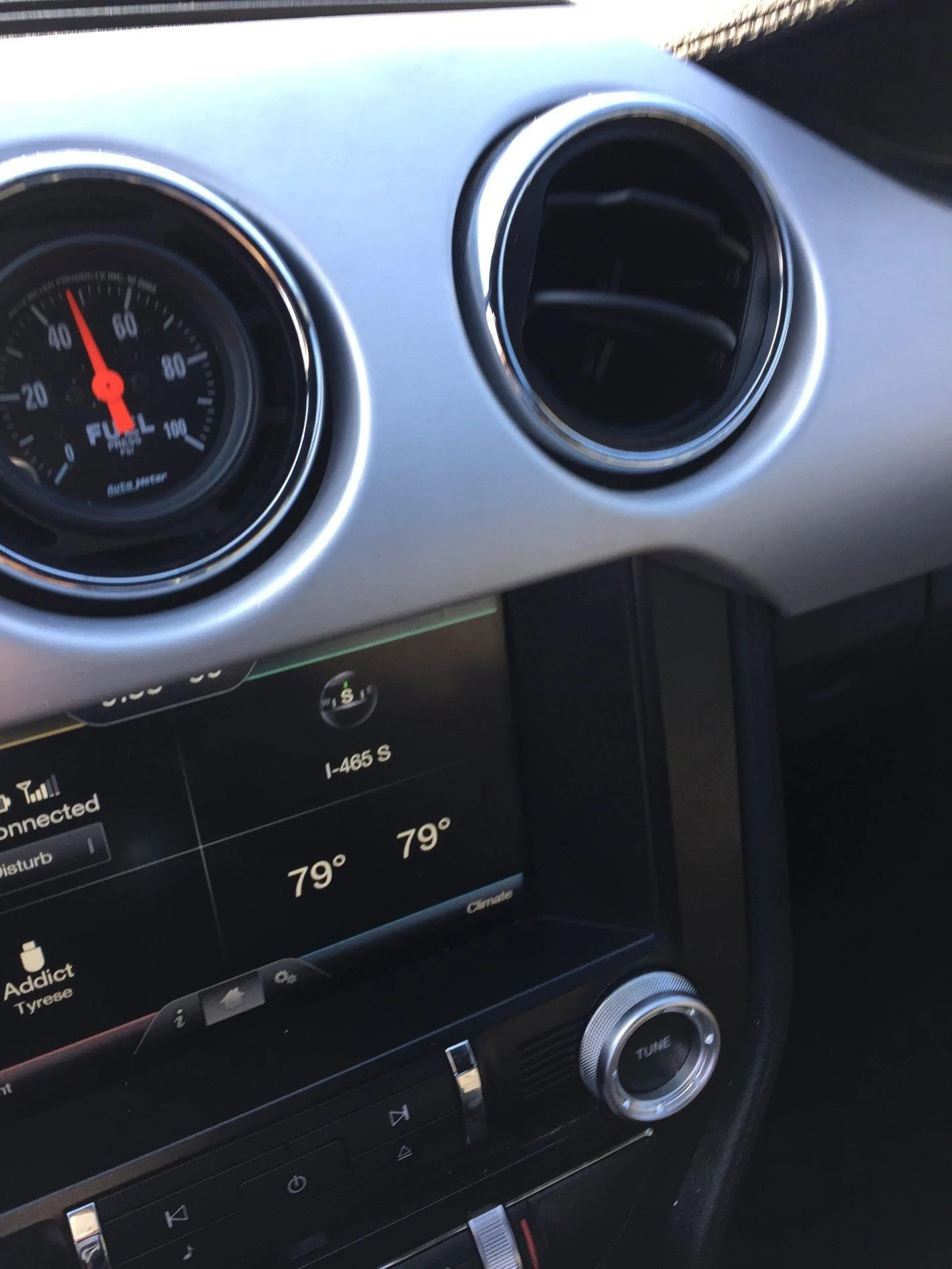

I have fuel pressure gauges in the dash on my KB and Hellion TT.
I watch them like a hawk and if the needle does not move up as expected as I get into boost,
I am lifting immediately .
Granted it’s hard to keep an eye on it during a 1/4 mile pass but I try .
