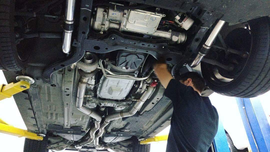

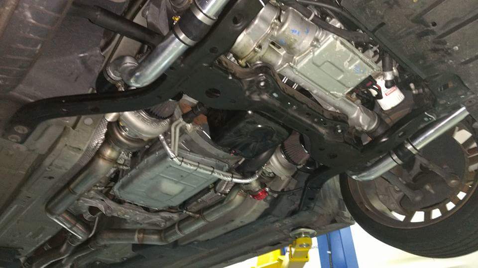

How much ground clearance do you have? I just ordered the kit and i use my car for HPDE track events, i hope they dont hit!!its pretty low, I'm trying to adjust it.
Glad to see your up and running.
They tuck up high enough that it's not a problem. We've never had anyone scrape a set.How much ground clearance do you have? I just ordered the kit and i use my car for HPDE track events, i hope they dont hit!!
Once adjusted, it sits plenty high enough. It works a lot better if you adjust it with the suspension compressed. Drive on lift, or just set the car down on blocks/ramps.Is The IC piping as low as it looks or just the angle?
