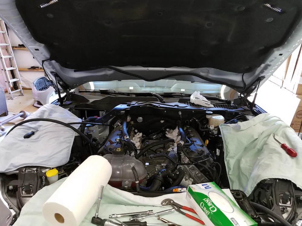

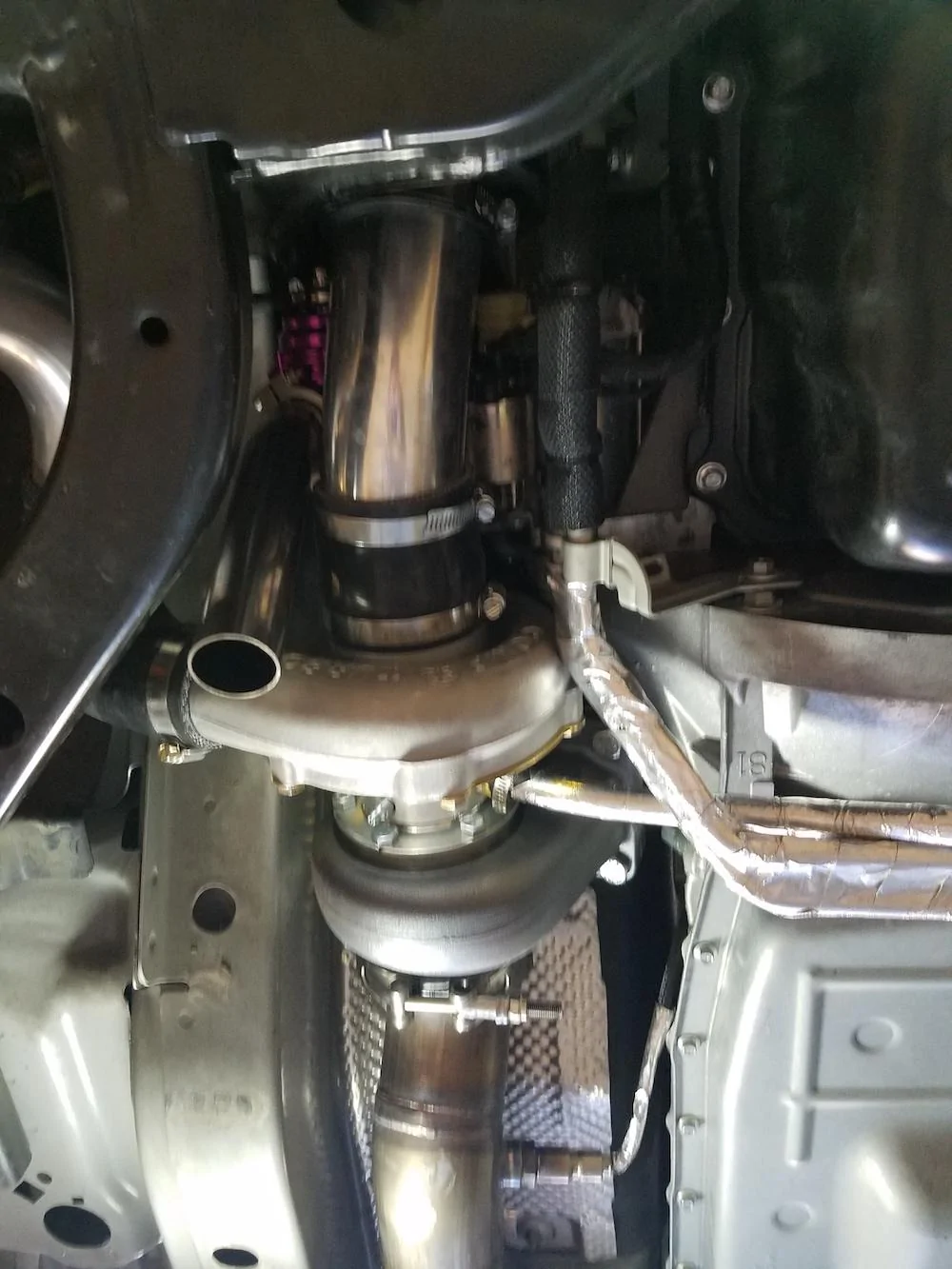

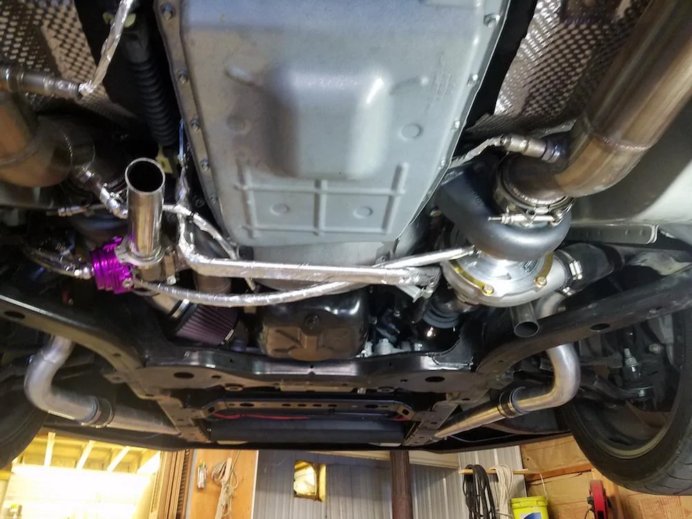

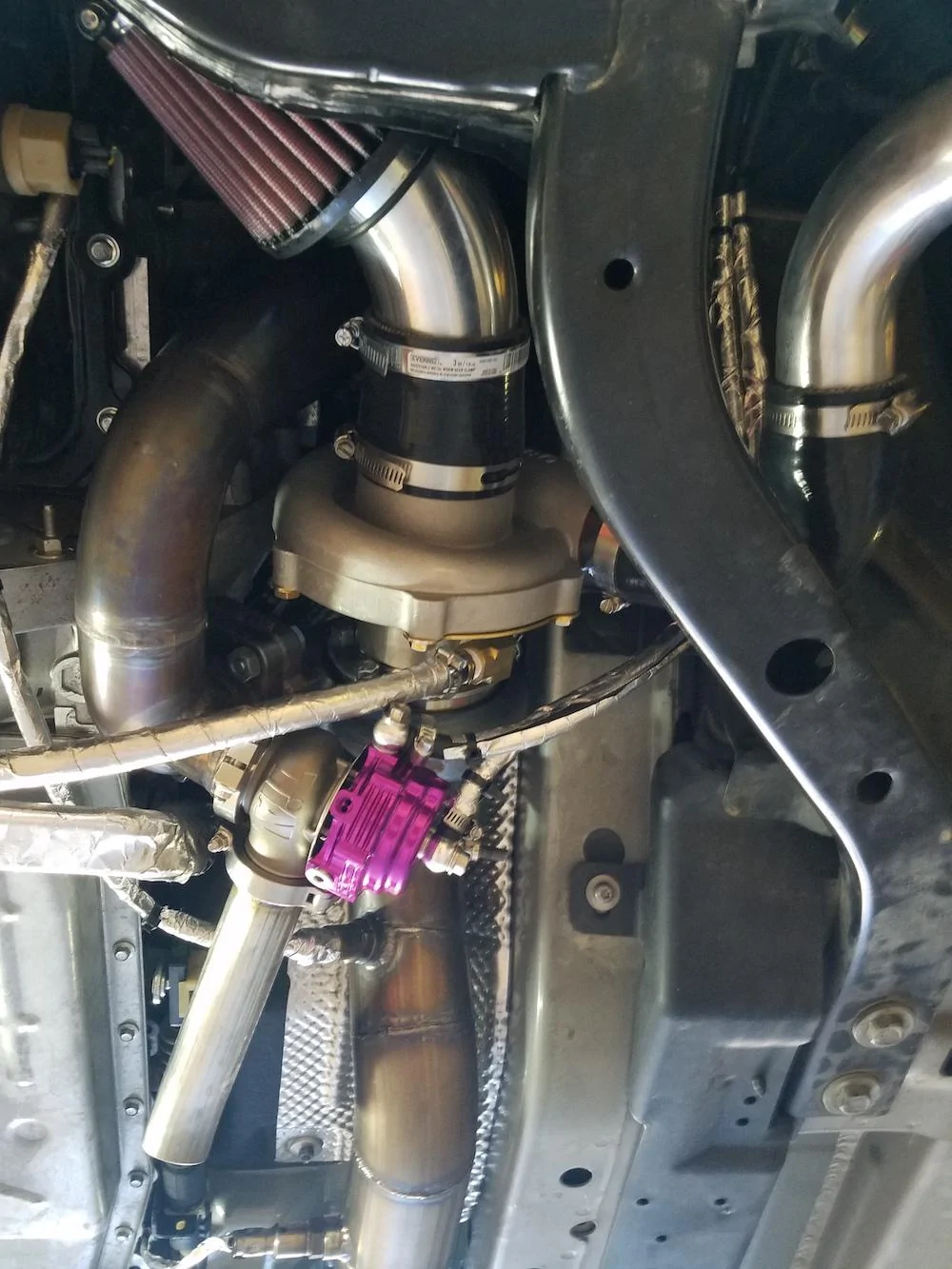

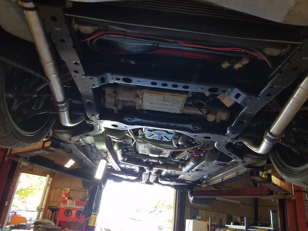

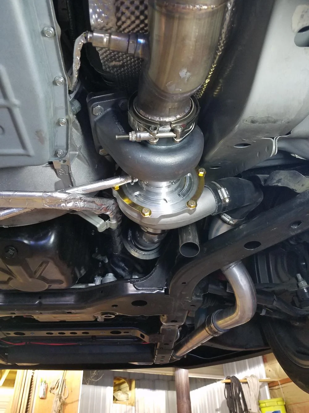

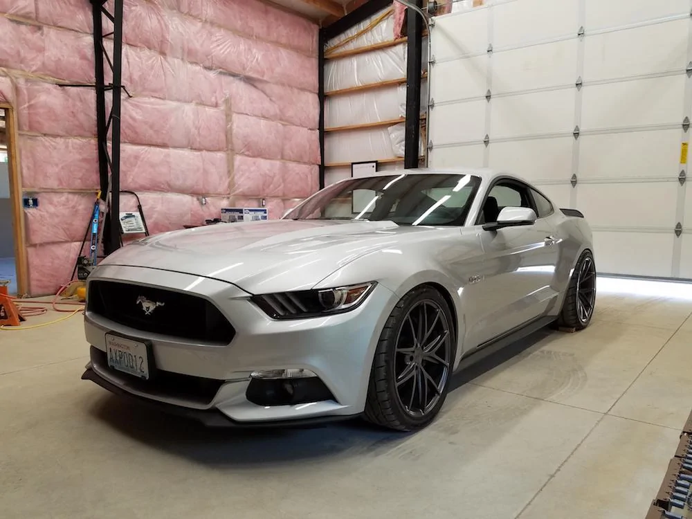

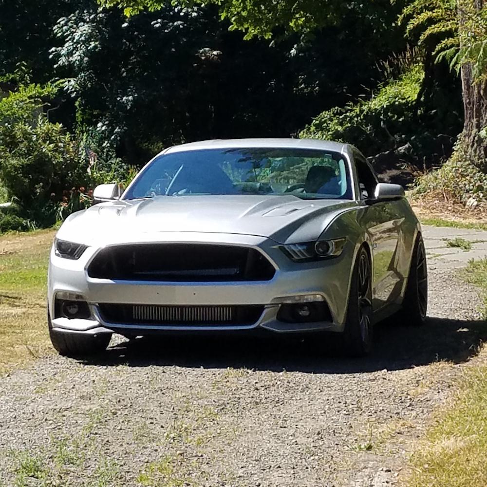

Im happy to say that i have the kit installed, It took me a few days on jack stands by myself, total install time on everything was about a week. Hardest part was the headers, I installed them twice to reroute some hoses and it was much easier the second time. Everything bolted up fine with no fitment issues and the welds look great. Travis and turbo crazed were there for me during the install to help me though the head scratching moments.
The car is insane fast! At the moment I'm at 10psi on 92 octane with booster. We are still working on the final tune. And Travis is sending me a return style fuel system because of the wait time i had. I will then finish the tune with some E85.
Im beyond happy with the kit, it was well worth the wait.
