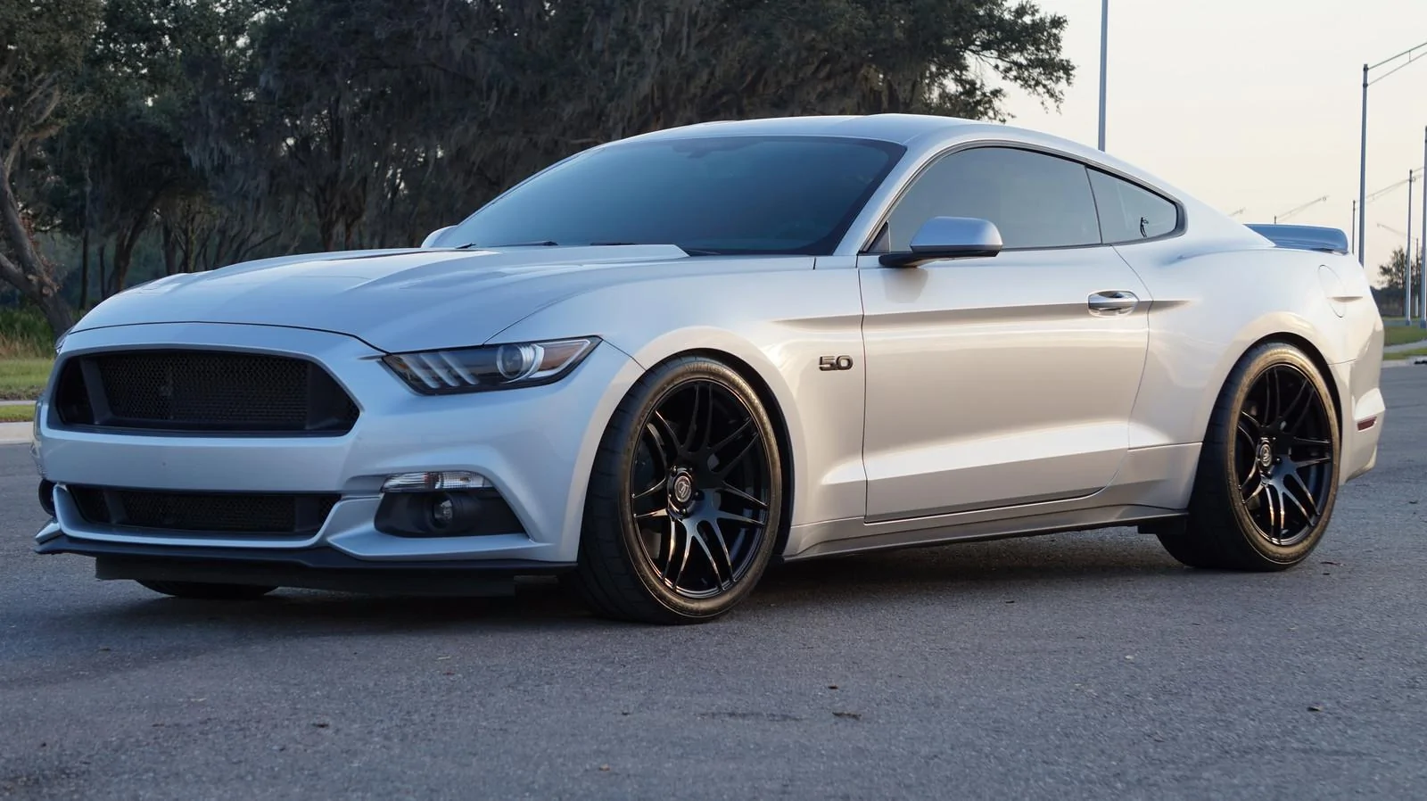

Looks killer!!!Another of mine from a couple of weeks ago. Love the stance, no rubbing.

Looks greatAnother of mine from a couple of weeks ago. Love the stance, no rubbing.
