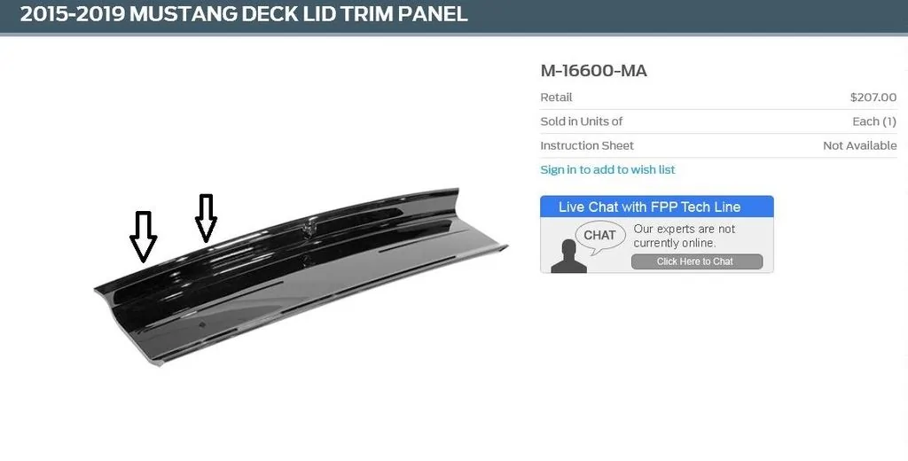

I wasn't sure whether to revive an old thread or post a new one?

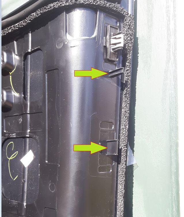

Took delivery of my MY19 GT, earlier this month.
I had already decided to change-out the deck ld for the M-16600-MA, blank version.
There was a signficant compatability issue. The M-16600-MA has additional locators on the 'B' surface on the deck lid along the upper fixing flange.
Here;
Both sides.
The locators;
I've removed the locators in order to fit the deck lid, but was surprized to see this.

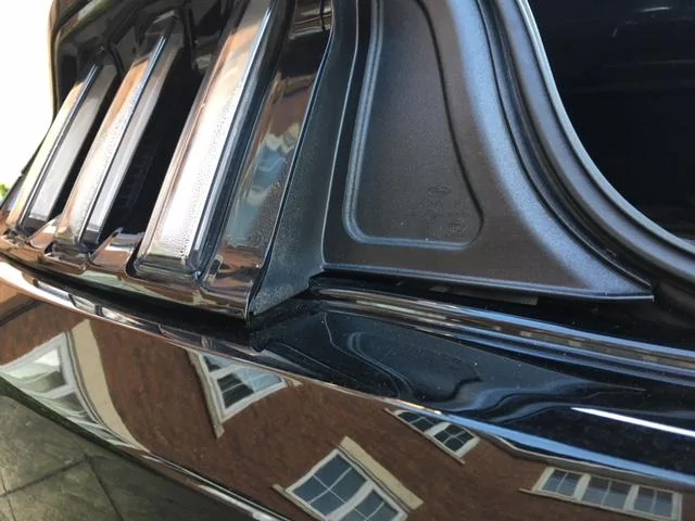

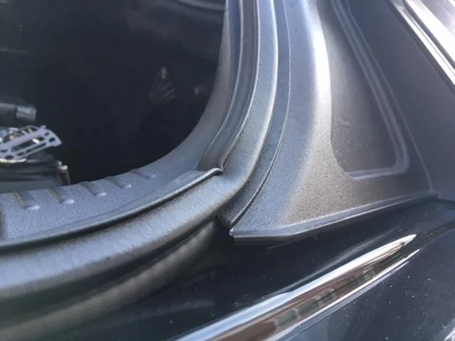

Mine is going in to the garage again tomorrow due to boot misalignment, paint worn away where it touches the trim when you close the boot. Boot momentarily touches the trim and over time wears marks in the paint. Something for others to watch out for.
Is this on the underside of the boot lid? I’ve noticed the underside corners of mine are rubbing...
Yes, exactly. If you look closely at the plastic trim from the lights, they don't fit straight and angle upwards (see pics below), so the boot catches on them at the corners when you close it. The damage is gradual and can take a while to notice. I would have thought a lot more people have this, but just haven't noticed? Unless I have odd plastic trims?!

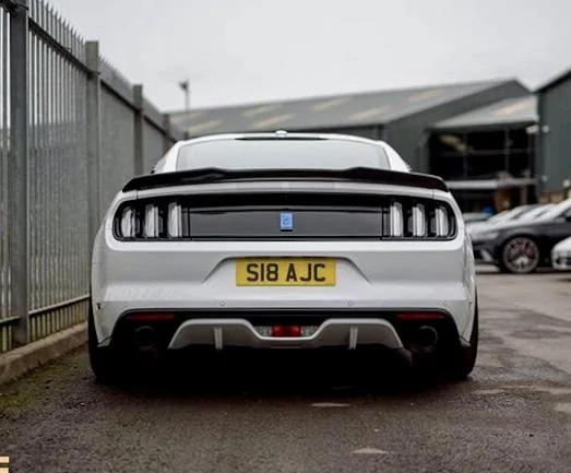

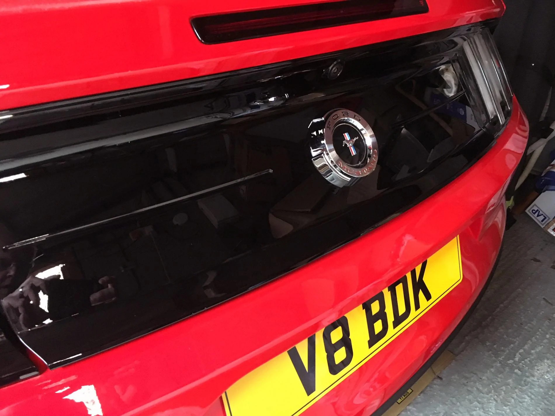

Right, jokes aside, there's atleast a blank decklid now around, that adds a different style to the MY15-17's and you can add badges without worrying about holes. :thumbsup:

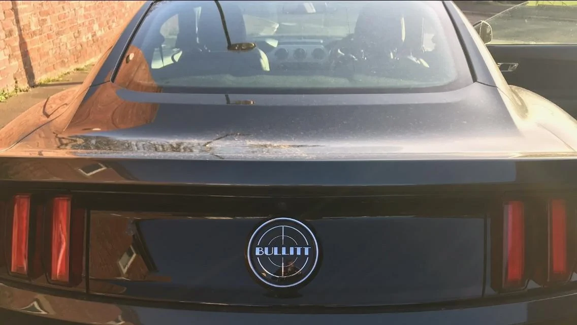

I’ve just completed a bit of badge engineering on my Bullitt tribute. The Bullitt badge was unavailable until January and has been on back order until it finally arrived last week.
The black tail panel has 4 mounting holes which allows the same panel to accept eco horse, Euro GT with fake fuel filler, US GT or Bullitt emblem. The emblem is plastic welded to the panel so you need to butcher that off to release the emblem. A dremel or a Stanley knife will do it. Ford Aftermarket emblem comes with 3m double sided tape and a couple of self tapping screws so it’s a pretty solid fit. Smaller badges would get away with just double sided tape.
Oooh, that’s not where I’ve seen it!
Easy fix, undo the 3 tail light bolts and "angle" it properly.
I don't think you can (without ending up with a massive panel gap the other side of the light). The rest of the light unit is parallel to the bumper but then just curls upwards. Surely everyone elses is like this and they didn't mold a special 'Aladin's shoe' version just for my car?

That part has a retainer/locator behind it if I remember right, might not be located correctly, worth taking the lamp out to check this.
you got a shot of the boot closed mating up to it, there's basically a bunch of tabs that the section all matches up to and if you remove the bolts behind there's about 5mm of angle you can pivot the lights on to align them correctly. you may, as adam said, just not have the locator pins in properly.
